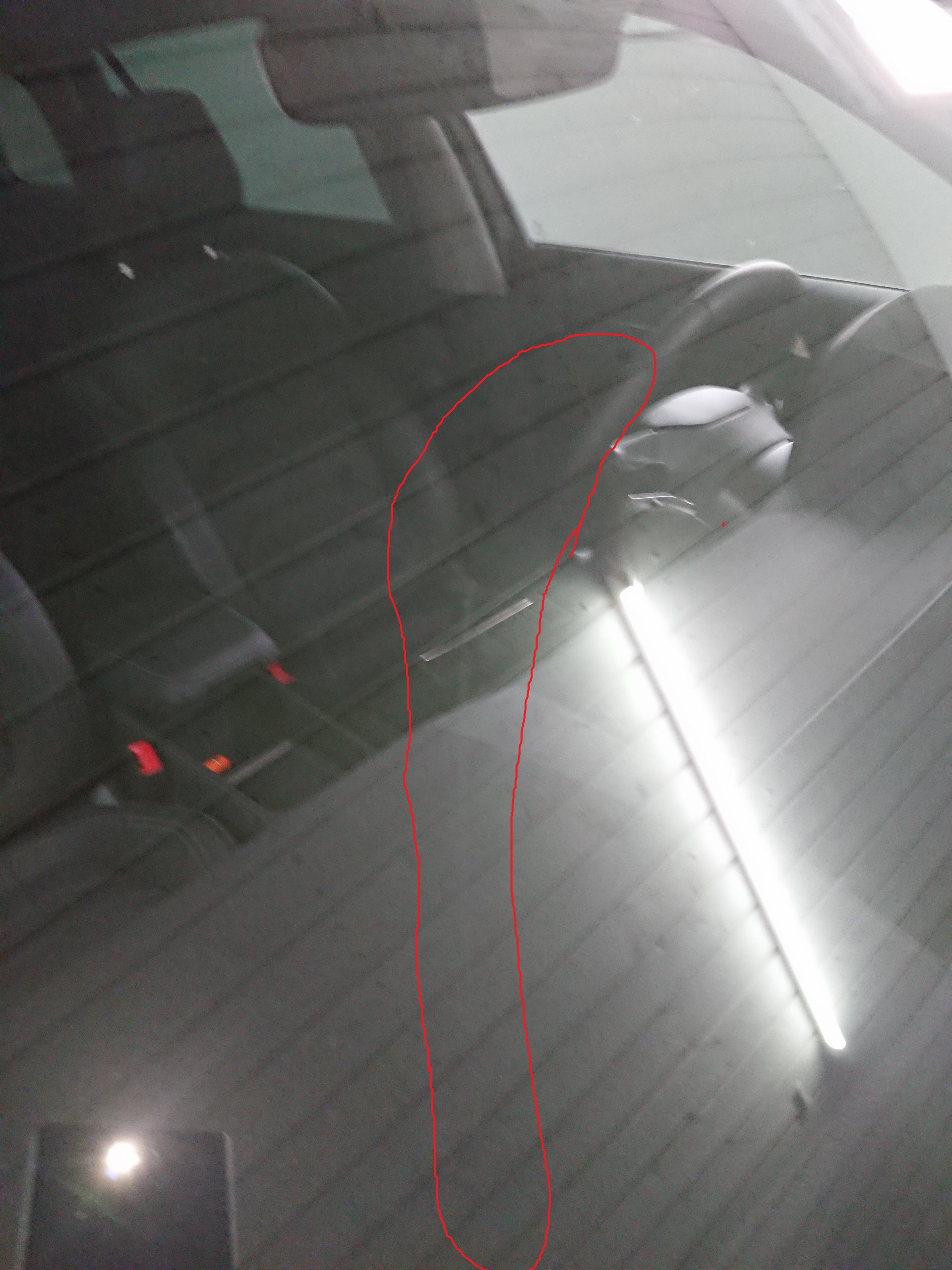

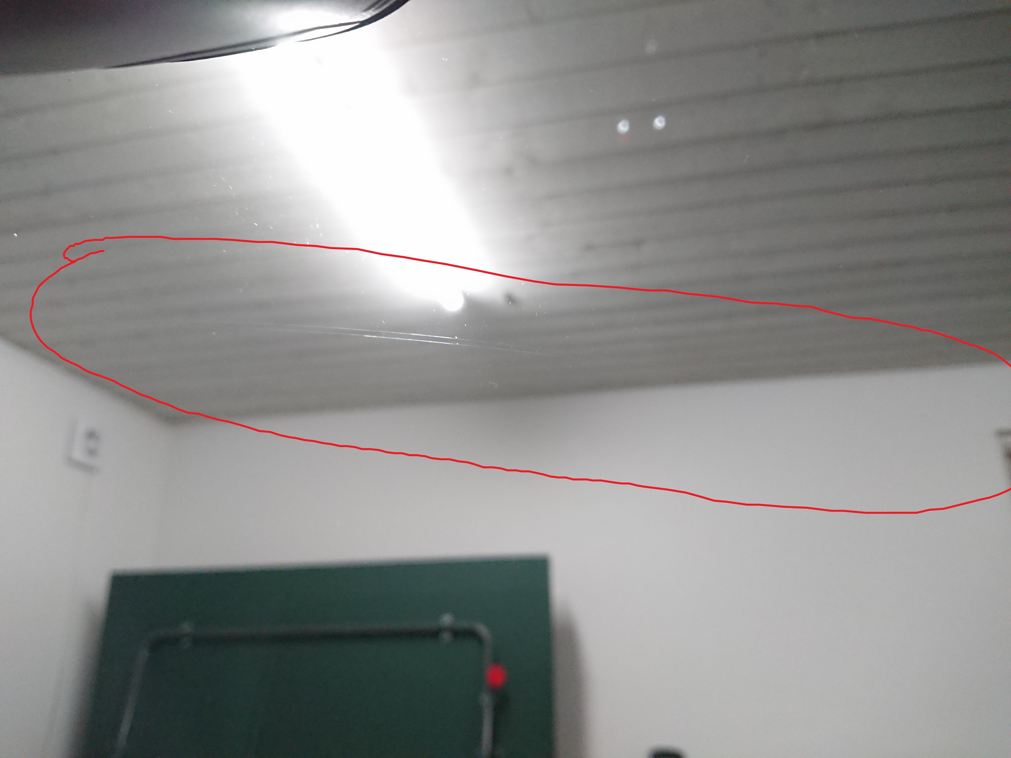

I have been a car owner for 19 years. Less than 2 weeks with kodiaq.... Arc scratch (actually two).

I have been a car owner for 19 years. Less than 2 weeks with kodiaq.... Arc scratch (actually two). Never had one before.
VERY DIFFICULT TO CAPTURE ON PICTURE! BUT I HAVE TRIED!
Virtually identical to mine

Well if there is a mistake with the wiperblade arm, then it would definetly be a waste of money changing the windscreen.
Or what do you think? Would be strange if it is the blade that causes it.
Edited by mlohnork
Yes ...that's why I don't even consider changing the screen at this stage ...I probably won't have the car when it's first mot is due but if I do I'll consider it then ....in the meantime I'm just gauging opinion from those people who have encountered this issue unexpectedly ....ie those others who actually care for their cars and clean the blades etc but have encountered this ...the numbers seem to be growing
Yes ...it seems so
The scratches are following the arc of the wipers, it looks to me as though some dirt or grit has ended up being dragged over the glass by the wiper blades.
Yep. I am not disagreeing that. But if the glass quality is bad, it is more/too vulnerable. I also got a small chip from a rock.
