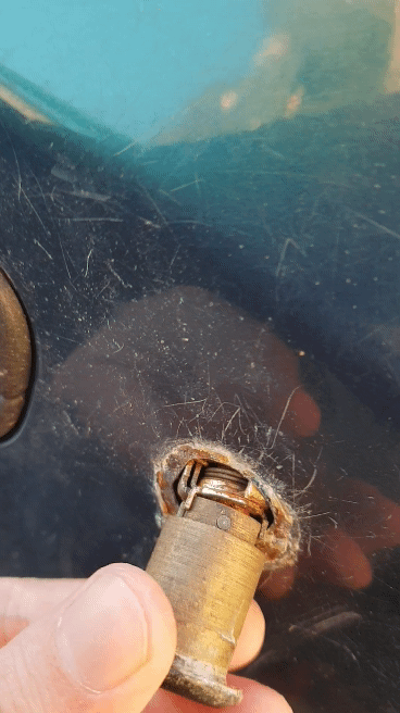

I recently became an owner of a Felicia 1997, and now it seems my driver's door lock isn't staying in place (see attached). Any clues on what is broken here? I'm hoping to fix it myself but would need to identify what part I need to find as well. The lock and even central locking works fine otherwise.
Thanks
You'll have to remove the door trim panel and most probably you'll find the locking piece inside the door.

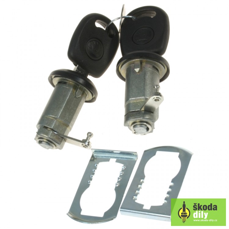

[pic]
The locking piece are the ones on the bottom of the picture I presume? I'll try and remove the door panel this weekend when I have garage access (not doing it in -10C!) and see if it's there. Thank you!
