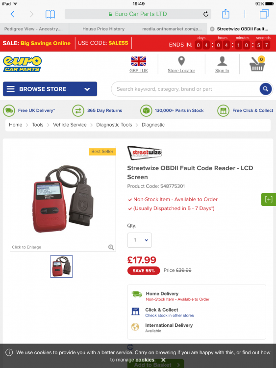

Anyone know if this is suitable for skoda and good enough to detect where the fault is and clear codes?
Having had the exact same fault with both my previous and current Skodas, owning VCDS and also that cheaper tool I can tell you confidently that it will bring up a generic code saying something like "fault in airbag/SRS system" without telling you any more, if it was intermittent and has gone away it will delete the code and put the warning light out, if you find and repair the fault yourself, probably by removing all the connectors and soldering them then ditto.
VCDS will tell you which airbag is showing as faulty or what seat belt pretensioner which makes your life much easier, it will probably be a case of the connector rather than the module, VCDS will also tell you if the module itself is faulty or not communicating.
