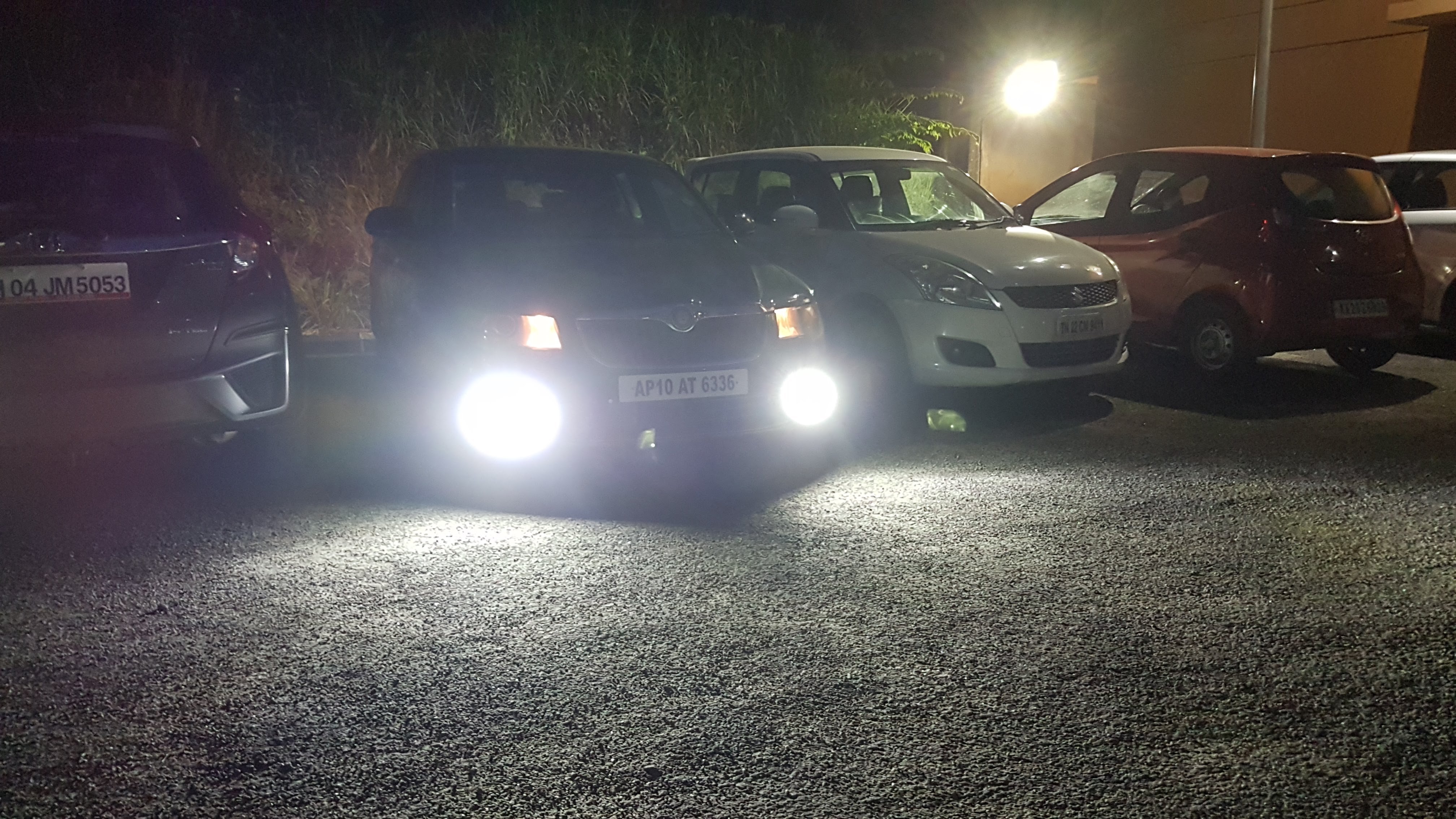

Had the OEM Philips Xenstart 4300K before. Did not like it at all. I have 6000K H8 LEDs running in the fog lights. The color projected is somewhat in-between the 6000K HIDs and OEM 4300K. Also, wouldn't mind upgrading the high-beam H3 halogens to LEDs as well.

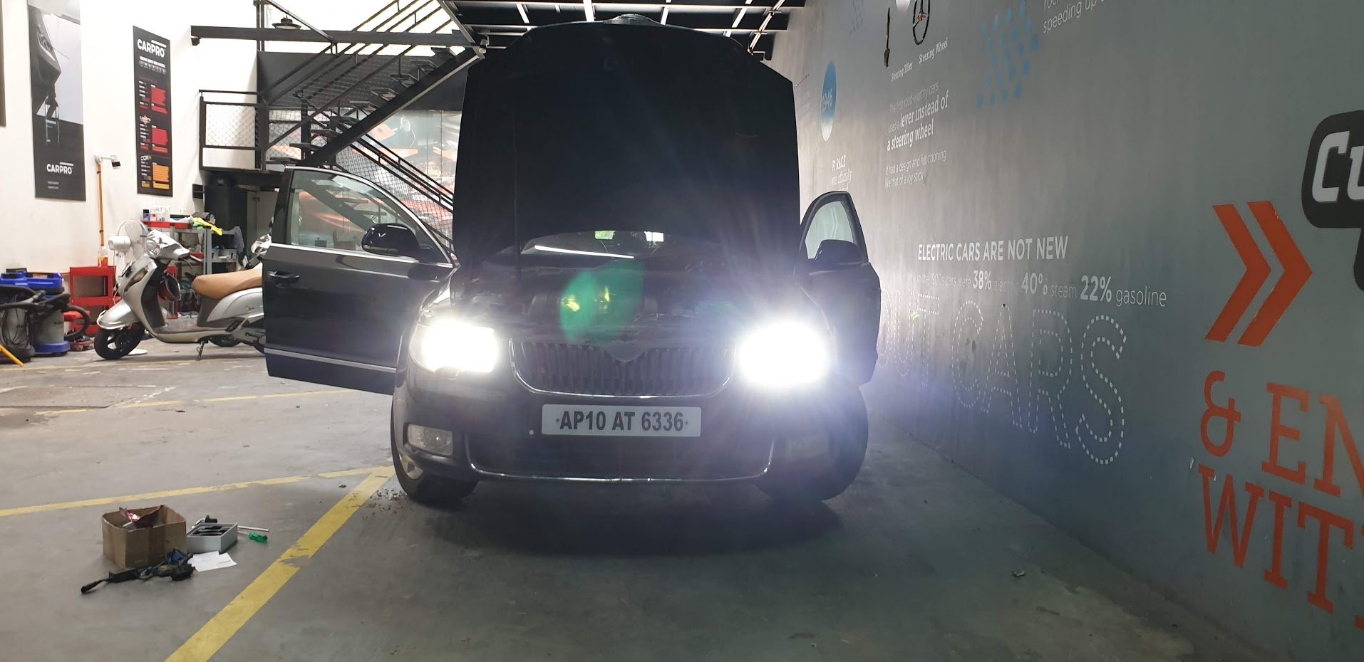

All issues sorted. Got Plug and Play D1S LED pair (6500k) from aliexpress and switched the halogen high beams to H3 Philips. Visibility has improved tenfold
