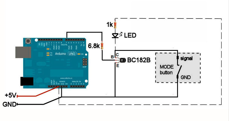

This is my prototype electronics to solve this annoying problem in my new MY19 Octavia.
After powering up it waits 5 seconds then simulates 3x button press which will switch the driving mode to 'Individual' for me.
The relay output has to be connected in paralell to the MODE switch and the Arduino needs ignition activated 5 Volts.
The only issue at the moment is that the relay is loud. I will try to put it in a sound insulated box or something.

How is the switch operated? 12v signal to ground? 5v?
You may be able to use 1/2 transistor/s to do the same thing, with no noise, rather than an electromechanical relay.

OK, after some measurements I figured out that I probably don't need the relay module.
The MODE button has 2 terminals, one of them is simply the common ground. Let's call the other one signal. When the button is pressed the 2 terminals are shorted.
Checked with an ammeter and only 0,9 mA passes through the button when it's pressed.
I was also able to operate the system with a resistor connected to the 2 terminals. The highest value which still worked was 330 Ohms. So it seems that some loss (resistance) is not a problem.
I have modded this circuit: http://www.learningaboutelectronics.com/Articles/Vibration-motor-circuit.php and it seems to work. :)
It draws only about 20 mA and 99,9% of it is the Arduino Pro Mini itself. When I remove the other components the current draw drops only by 0.1 mA. <--- Measured without connecting it to the car.
The LED and it's resistor is not needed, it's only for demonstration.
When it simulates button press I can measure about 8 Ohms / 30 mV between E and C. When I short the two legs (as the MODE button will do) nothing wrong happens (no smoke, no higher current draw).
Bonus: the Arduino jumper cables fit perfectly in the connectors so I don't need to modify the factory wiring.

The Arduino code looks like this:
void setup() {
  // Arduino button press simulator
  // 3 short press after 5 sec waiting
pinMode(7, OUTPUT);
digitalWrite(7,LOW);
delay(5000);
digitalWrite(7,HIGH);
delay(200);
delay(200);
delay(200);
delay(200);
delay(200);
SLEEP_MODE_PWR_DOWN;
void loop() {
This is my circuit now.
Experts: is it safe to use??

I installed my 'magic box' and it works. :)
For me the problem has solved.....

You need a 12V -> 5V adapter for the Arduino.
I installed mine next to the fuse box & connected it to an ignition live terminal via a fuse.
My voltage converter has USB outlet so I can unplug my tricky device every time the car goes in for service (which I did last week).
I believe the initial delay (3 sec) can be lowered in the Arduino code. Sometimes the headunit wakes up very fast and pops up the MODE selection screen.
Awesome thanks.
It looks like 2 other pins are direct jumpered between the plug and socket. I presume these are for one of the other buttons on the panel?
And both black cables are soldered to the same common ground pin as the transistor emitter right?
For sure I’d think the delay can be lowered based on my tests of how fast I can hit the button 3 times as soon as I press the ignition button. I can get it into individual before the virtual dash has even displayed the mode symbol yet.
Yes and yes.
Probably the initial delay is not needed at all. I am too lazy to remove and reprogram mine. :)
