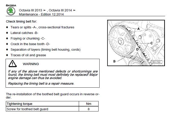

My car is approaching an age where I want to inspect the cam belt.
I can see how to remove the cover from the end of the cam shafts, can I then rotate the engine by putting a socket on the crankshaft pulley holding nut?  Or is there a cover to remove first.  Also, as the cam belt cover is only a dust cover, can I reuse the same gasket?

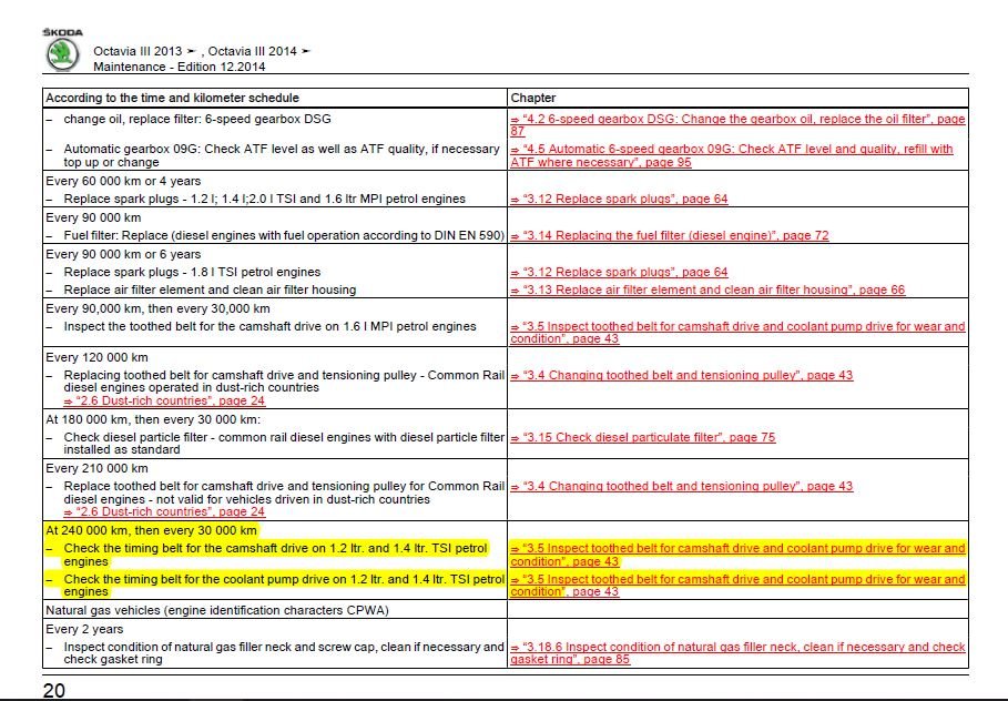

I have no idea what you’re talking about but I am genuinely interested in finding out whether you can assertain if you’re cambelt needs changing.
Ive got a 2014 vrs and I’ve been told it’s 5 years or 140000 miles before cambelt needs changing. Currently done 73000
Look forward to replies
Regardless of the belts condition I would have it changed along with the tensioner and water pump. For the sake of a few hundred quid I would get it done. Just changed mine at 45k miles on Sep 2013 vrs tdi so I now have peace of mind.
