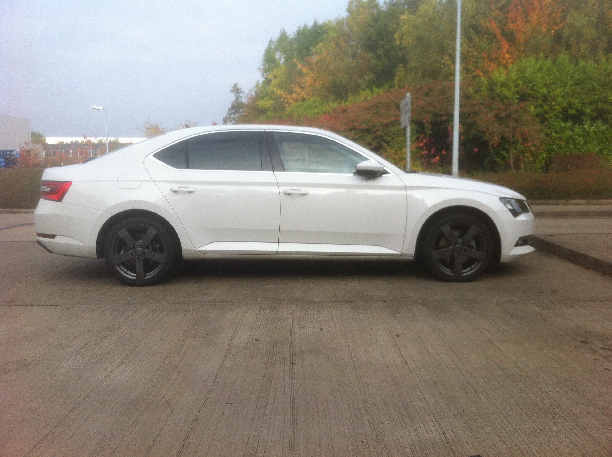

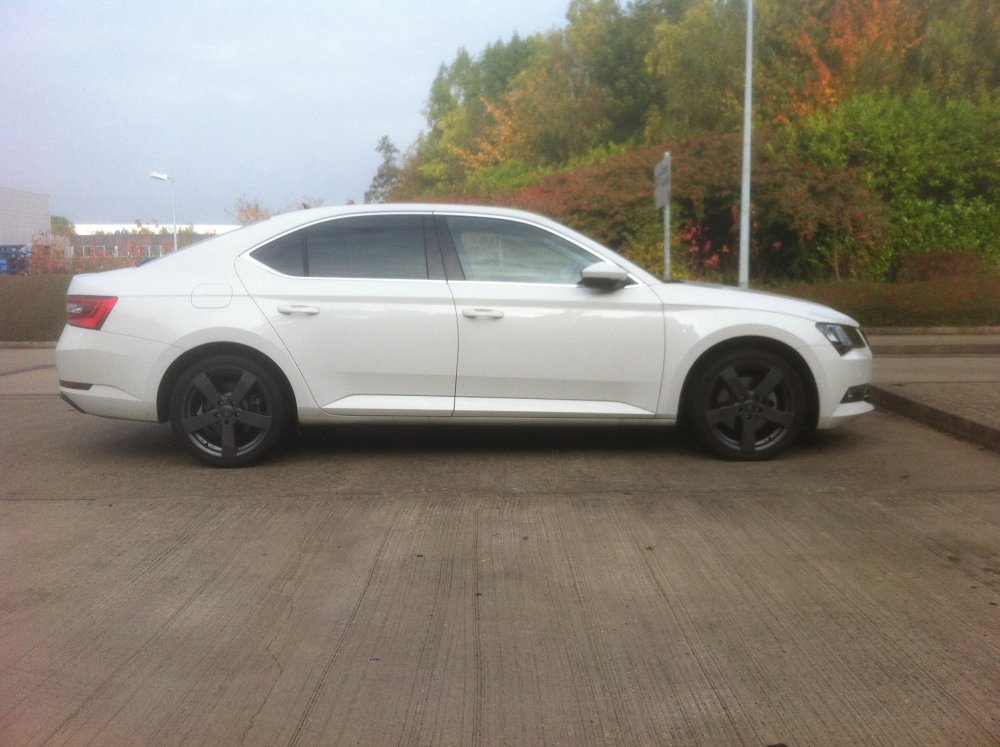

To be honest I bought them nearly 3 years ago to use on my 148bhp petrol Superb (Mk3). Kept them in the garage last winter because the 245 had P Zero 225/35R19 tyres so no point switching for same rubber but only slightly narrower. They still have 5/6mm of thread left so will do for 2019/2020 winter as well then might fit some Michelin Cross Climates for the colder months.:D
54 minutes ago, shyVRS245 said:
The diff at times almost makes my car feel like it's got 4WD particularly on the wider wheels (8.5J) and summer tyres 235/35R19 Michelin PS4S. Waiting another 4 or 5 weeks to get them back on the car. Have to feed the power in gently with my 225/40R18 Pirelli P zero's.:o
My current winter alloys on my previous car from 2016.:)
