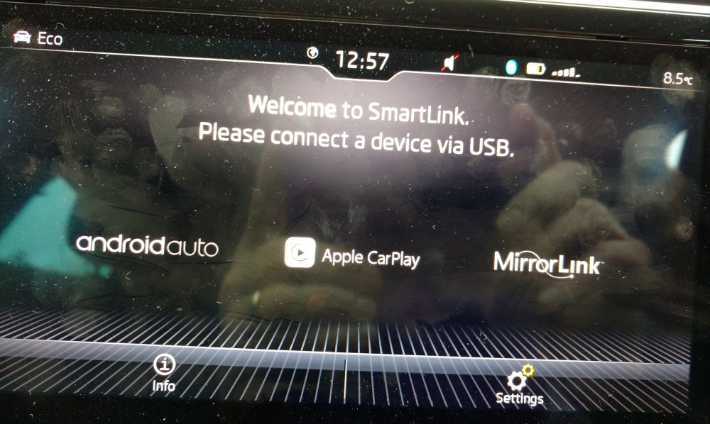

I plugged in my Android phone to the car via USB and here's the first problem: the car doesn't "see" it. I know it's plugged in because the phone shows that it's charging.
Menu => Smartlink shows that I need to connect via USB - see photo.
Any ideas?
Have you got Android auto also installed on your phone and do you use a good quality cable to connect to the car?

John, thanks for the response.
Yes, I have got the app on the phone. I didn't do anything with it other than open it. Under its settings it has a section "Connected cars" and in this under "Accepted cars" it has SKODA.
So that leads me to believe that it has talked to the car!
I don't know about the cable quality - I'll play around with some others this pm.
As I remember, the first time you pair the phone to the car, after you physically connect it, you need to open the Android Auto app on the phone and go through several pages of terms and conditions. On the car side you simply need to select Android Auto (instead of MirrorLink) at the same time. It's a rather straight-forward process after you do that.
But yes, the connection quality can depend a lot on the quality of the cable. First time try it using your OEM charger's USB cable (assuming it detaches from the phone charger).

Solved! I tried using another cable and it worked fine;  I'm surprised, learned something there.
Thanks for the replies.
