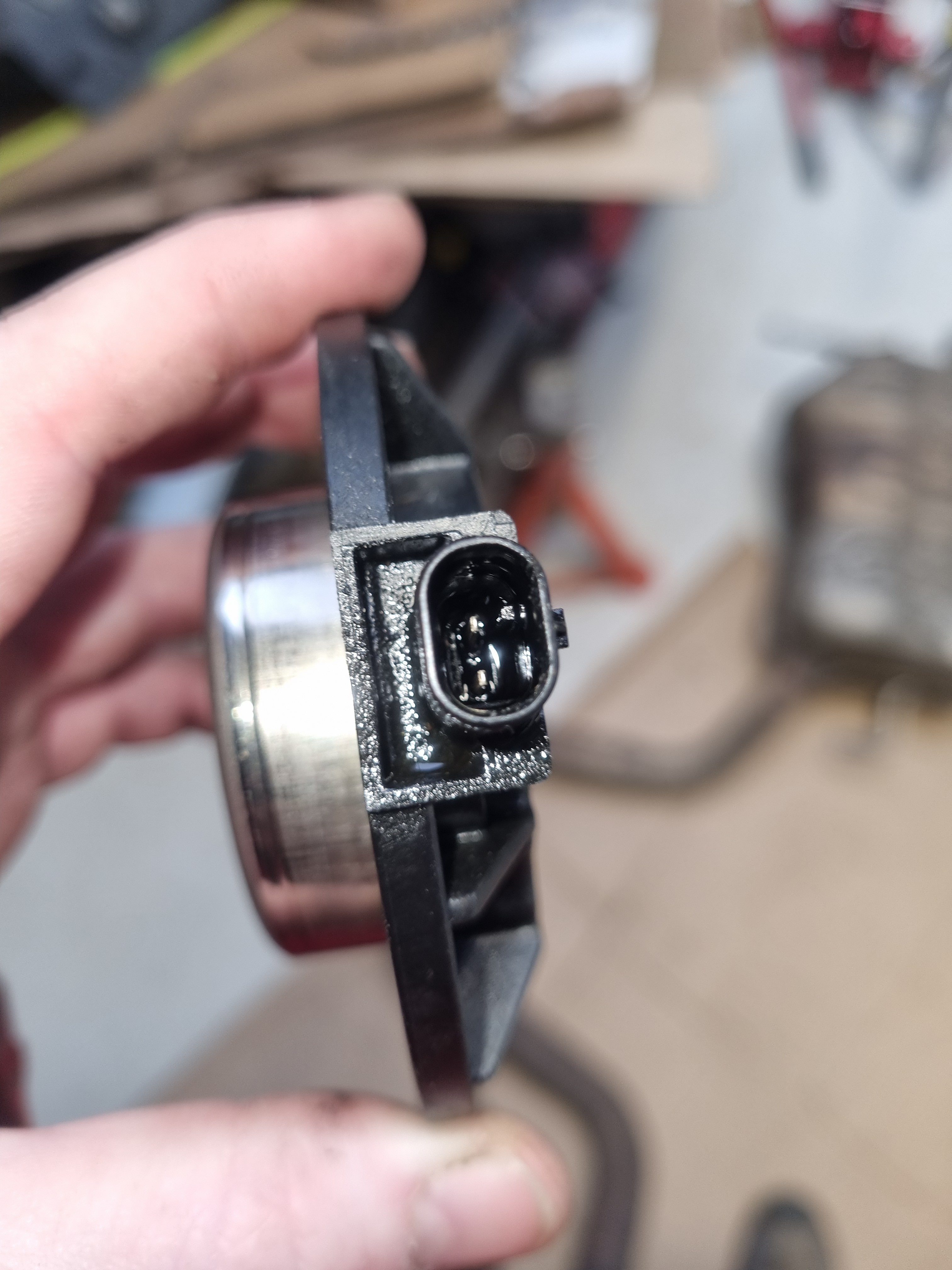

Checked with my OBD11, and found the 'camshaft adjustment, intake bank 1, specified value' and '... actual value' did not match. At idle was asking for 10° but bouncing around 40°.
Took both the cam angle sensors off to check part numbers etc, and found the rear one (which must be inlet) had oil filling the electrical connector. I don't think that would be beneficial to the operation!
I cleaned the oil out, and sure enough, no more issues, but I've ordered a new one anyway, as the seal is allowing oil into the connector - £42 from dealers.
Part number is 06L 109 259A for anyone else.
The sensors are located at the top left of the engine as you look at it, just below the oil fill and dipstick. 3 x T30 screws holding each in.
Rear one is outlet, closer one is inlet.

So I've had this issue again with the same sensor, again with oil in the plug. I cleaned it out, and it was fine again.
I thought it might be me being messy topping up the oil, so I made sure to use a funnel carefully ever since, but after a few months, same again, oil in the plug.
I'm wondering how this might be getting in there, perhaps some oil gallery wearing on the cam, allowing the oil to get into the sensor... I'm certainly not going to strip the cam down for that though, as I have two sensors now, so I just swap it, then clean it out ready for the next time it.

I've recently been having lumpy, stalling issues within the first 5 mins of driving then it seems to disappear.
I've noticed this oil in the rear sensor so I've given it a quick wipe to see how we go - I feel some braking (DSG) affects the lumpiness when it starts so wonder if I also have a vacuum leak.
