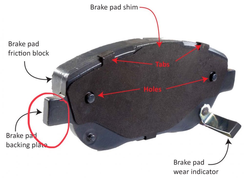

Don't file the carrier, caliper or the rear of the pads. It is just the lugs (ringed in the picture) on the backing plate that can be badly cut leaving burrs behind. You just need to remove the burrs so the edges are smooth on the lugs where they make contact with the carrier.

It was the problem I had with mine sticking, a few others have had the same problem. A simply fix but one that shouldn't need doing in the first place.
