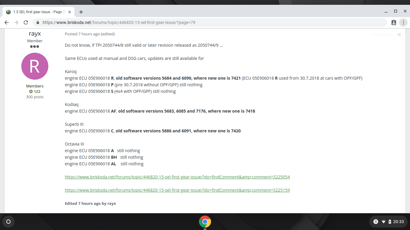

Just had a look at the T Roc forums page, they are as fed up with the kangaroo problem as you lot are, loads of cars being rejected etc.
Couple of questions
  • Is there a particular version number for this software update ?
  • Does it only relate to manual 1.5 tsi engines or DSG/auto as well
2 hours ago, gmgohara said:
Couple of questions
As far as I understood it’s the same for DSG and manual

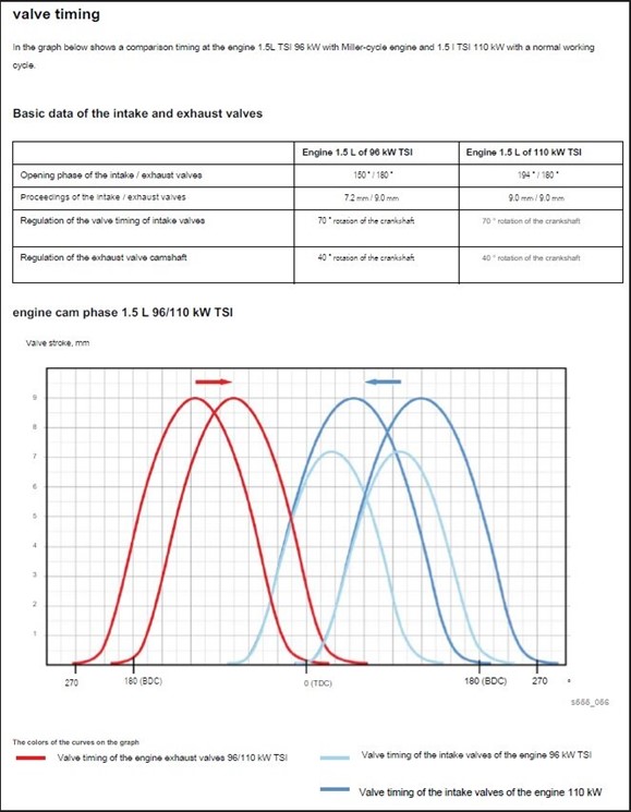

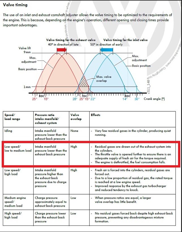

Just looking in after a couple of months of ownership of this 1.5 engine in my Audi A3. It is unbelievable how this engine can perform so differently in different cars.
I've done 1600 miles, about 1/3 of this motorway towing a caravan, 1/3 long runs and 1/3 town traffic. I've experienced no issues.
I was apprehensive of making this engine choice and moving from a diesel, but I'm very pleased. The engine pulls strongly, is flexible and although not as economical still good. The software is out there to get the engine to run well.

^^^ Not there for all that are having issues sadly,
but VW will say that is just the few, special cases, but VW will get there, maybe, sometime eventually.
Colin
Is that a manual, or automatic gearbox in your A3, please?
