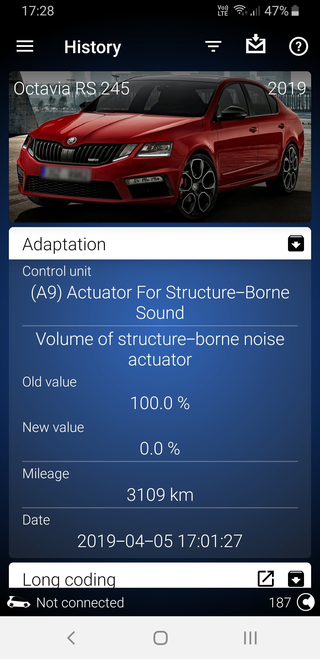

I can knock the soind generator off completely through OBD I think, or even have it disconnected.

Ive told them no anyway, they are happy with that. The cars going back in for a priblem with the drivers seat but for now Ive just disabled it with OBD11

My 'old' 220 is exactly the same.  Drove me nuts.  Turned it down to 30% - problem solved.
