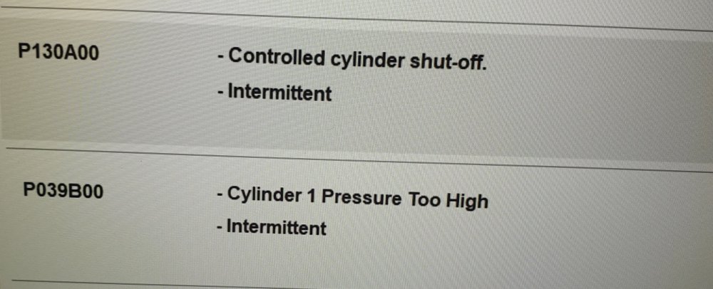

Hi, has anyone ever come across these fault codes before?
Only appear sometimes when I'm on full throttle for a sustained period of time. EPC light comes on and pulls the car back, but I'm still able to drive at motorway speeds with the light on. I can have bursts of power no issue, and at times I've been able to drive full throttle and not get this fault aswell.
Car was mapped over a year ago, and I've only noticed this issue over the past month or so, so I'm edging on thinking its not the map being too aggressive. I've also noticed a lot of smoke when I go full throttle, which has only started since the cold weather came in. No coolant gets used, but it feels like too much of a coincidence.
Google search doesn't reveal much so just hoping someone here has come across this before, worried I'll end up blowing something up :sweat:

Definitely a Mk3 with these fault codes.
I wonder if it's fuel pressure being measured or is it the knock sensor?
What fuel are you using?

Cylinder pressure to high is a modelled limitation. When the ECU detects the timing is too low and knock is to high then it'll give the pressure to high error. This is potentially due to the cylinder balancing so whilst the AFr is correct 1 cylinder maybe rich and 1 then lean to compensate.
Dodgy injector, plugs or coils can contribute.

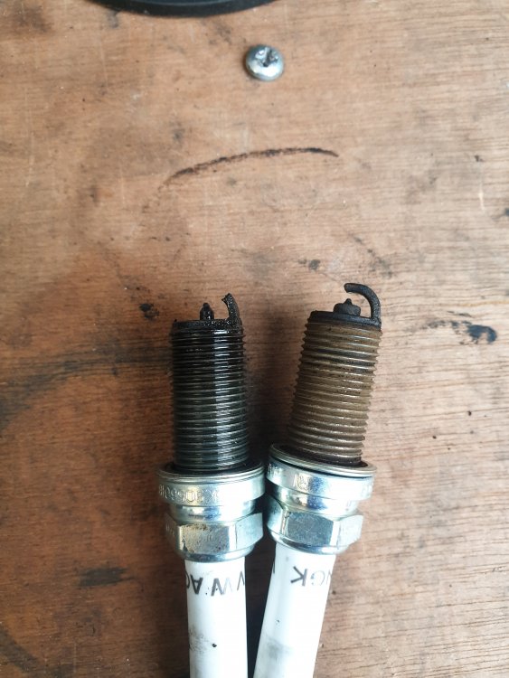

Spot the difference....
:sweat:
Cylinder 1 so assume it's been like that a while, so hopefully means any potential damage it could cause would've happened by now.
Although my journeyman says it, used to be, common for some cars to burn away bits like that, rather than it cracking off.
Car runs fine and no funny noises so far, so doesnt look like any internal damage. Number 4 coil flat out refuses to come out, though, so its not changed yet.
Edited by Saints92
Does your car burn oil? Looks like you have oil on the plug
Can go from Max to Min in a couple of months/2-3000 miles.
 Just something I've got used to now, been like that ever since I bought it 16 months ago, wish I'd known at the time of purchase tbh.
I would say that it felt more like petrol on the plug when I ran my finger on it though.
Edited by Saints92

Almost exactly one year on, and the same has happened, this time it looks like its starting to burn a hole in the piston.
How much is a new 2.0tsi engine...
Anyone got any ideas for this?
Only ever cylinder 1, completely burns out a spark plug every ~6000 miles. Other 3 cylinders are perfect.
Oil on the coil, and very slightly pooling around the spark plug.
Spark plug fitted a year ago unwound from the head without the use of a ratchet, despite being torqued in to the correct spec.
Cylinder 1 piston with oil residue on the top, and shiny point directly below spark plug.
Oil use is around 1ltr every 3/4 months;2/3k miles.
Going to try and get a compression test done tomorrow, but after a new spark plug is fitted, its trouble free motoring for ~6k miles until a misfire starts and plug starts burning out.
Swapped injectors and fault doesnt move, and also swapped coils and the fault doesnt move.
NGK plugs fitted, ordered off the reg numbers.
Car was remapped and driven for a year before issue started. Mapper doesnt understand why only Cylinder 1 would have issues if map was too aggressive but is willing to put it back to stock.
Absolutely horrible feeling it will be an engine job, one way or another, not what's needed financially.
Edited by Saints92
Wondering if the oil getting onto the spark plug is causing the plug to burn out, causing the fault?
Is there a common fix for oil around a spark plug on these engines?
Edited by Saints92
Even more worrying from my perspective is the bit that was missing from plug no 1.....where has it gone?  Has it gone into the cylinder?  Have you managed to retrieve the broken-off part?
Sounds like the oil seals are on their way out.  Oil on plug....never good - and shows distress on that cylinder.  Compression test good first start....I think you will find its down on pressure - which means new piston rings as a minimum...
