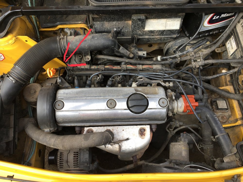

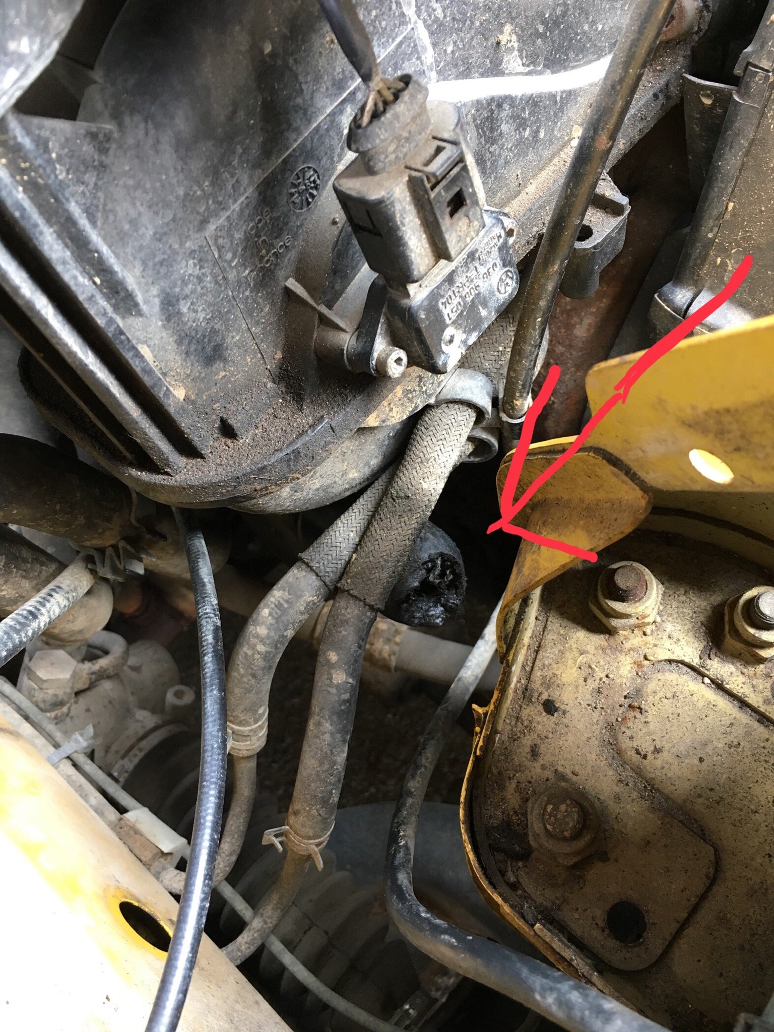

Would this have anything to do with it? It looks like the end of a pipe. I don’t know what it is or where it is meant to go to.
The second picture shows where it is in the engine bay. Just below the dipstick.

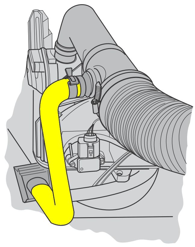

Most probably it is the breather hose for the Positive Crankcase Ventilation (PCV for short). It connects the crankcase with the intake manifold (see photo). The pressure built in the crankcase by the blowby gasses passing piston rings during combustion is relieved through that hose, filtered with an oil catch then sucked back into the engine. In your case the gasses go out in the engine bay. The only issue is pollution related.

@as2 - If it bothers you, you could feed the PCV hose that Ricardo's marked to a catch can, and blank the end that goes to the inlet trunk.
Any MOT pollution issues with that?
Not on a car the age of a Felicia, as long as there is a catch can and not just a pipe to atmosphere.
