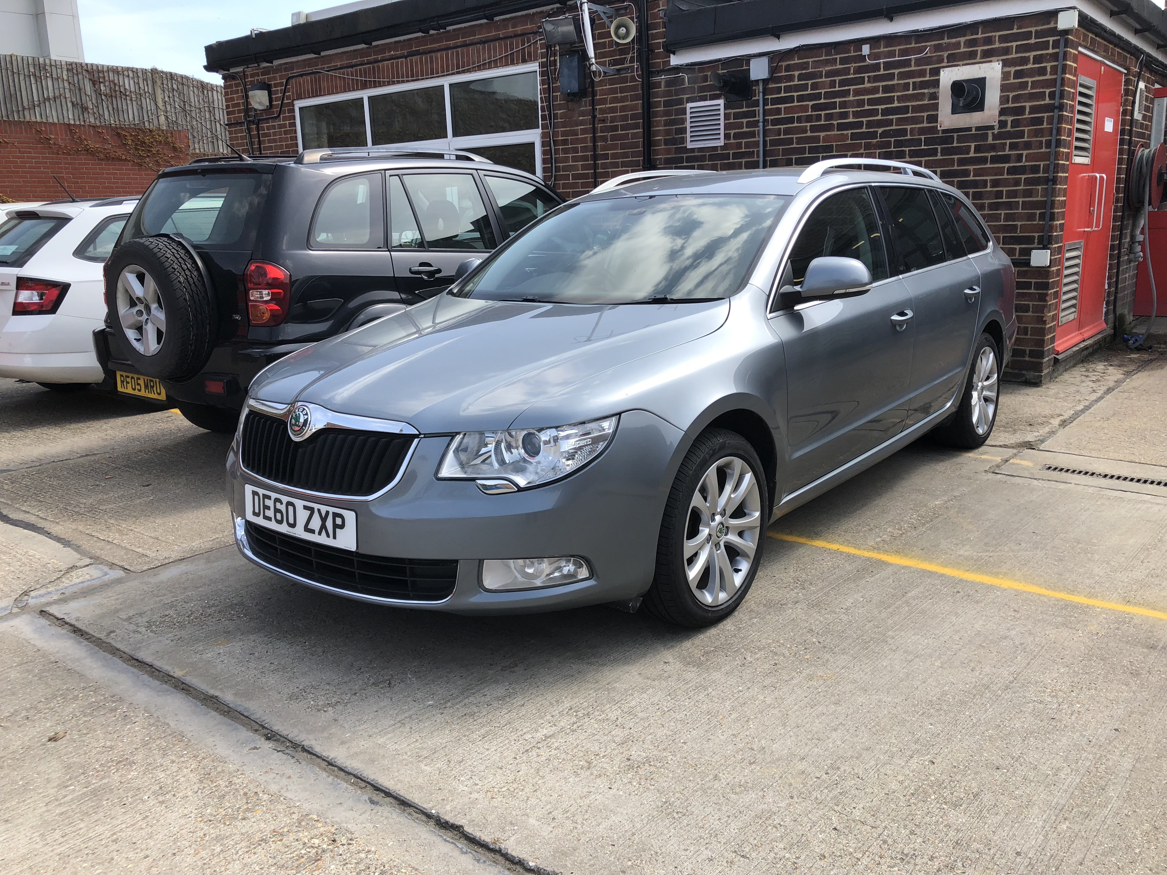

2010 Superb estate “restoration”
So I brought an estate to replace my wife’s aging Golf and wanted one that my two young boys could grow into. After looking at some of the options within our price range I decided on a nice Superb.
The car had one previous with a full history and an exceptional interior (with a minor blemish on the gear stick surround).
The exterior has a few issues but nothing that wasn’t to be expected from a car of its age and mileage.
There’s been some body work done on the near side rear quarter and front off side wing as far as I can tell but the quality of work looks good other than a little over spray and lack of effort in parts alignment.
The paint work needs some detailing but as it’s the wife’s car I’m not going to worry too much about the odd chip here and there, the main job will be a proper clean which the car has never had.
The wheels have just been restored with Pirellis wrapping them up.

Nice Superb mate!
As for the brakes, its a fairly easy job if you have done this before, its practicaly the same as on a Golf, only "special" tool you will need is a caliper wind back tool and a M14 triple square bit.
Looks like new on that photo

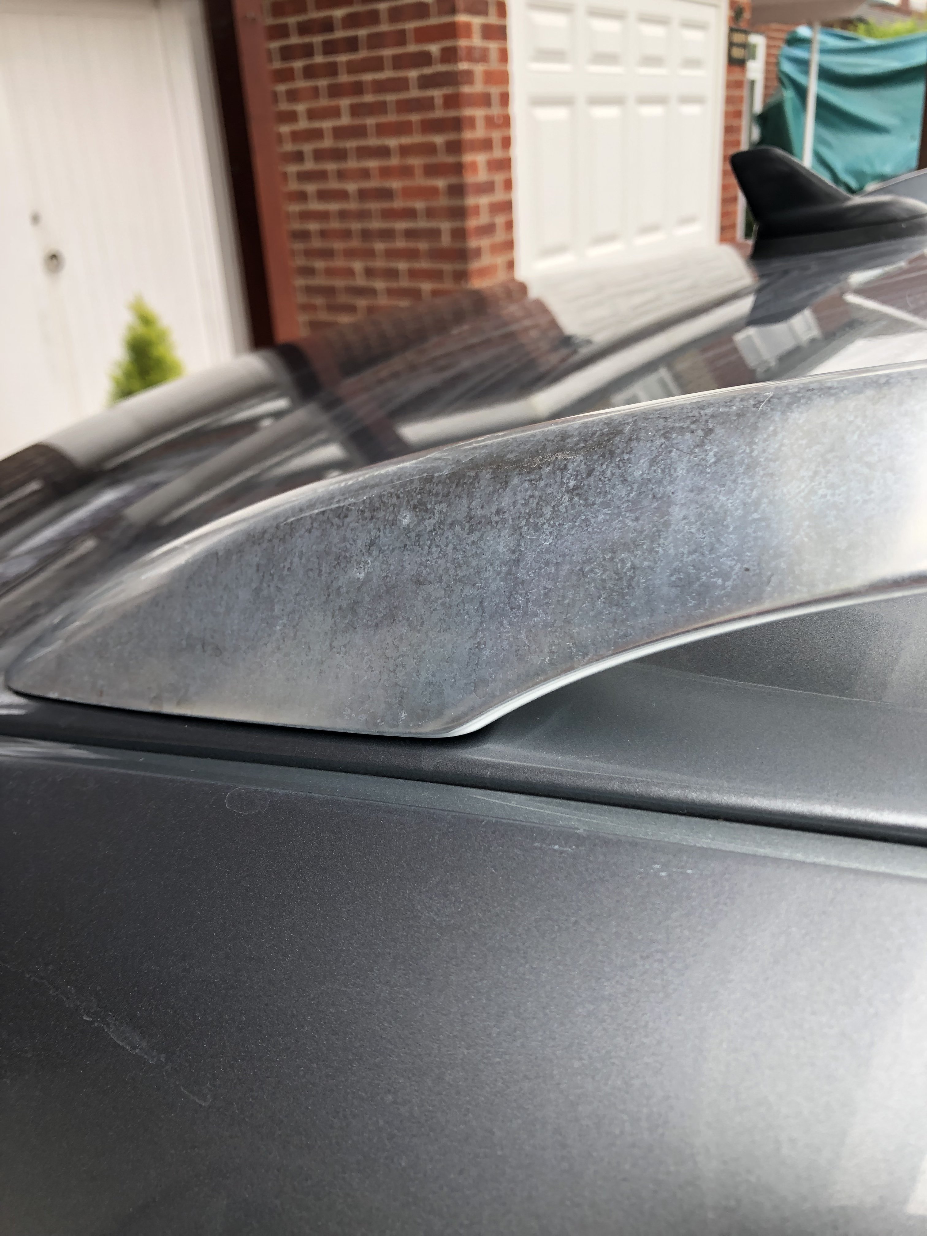

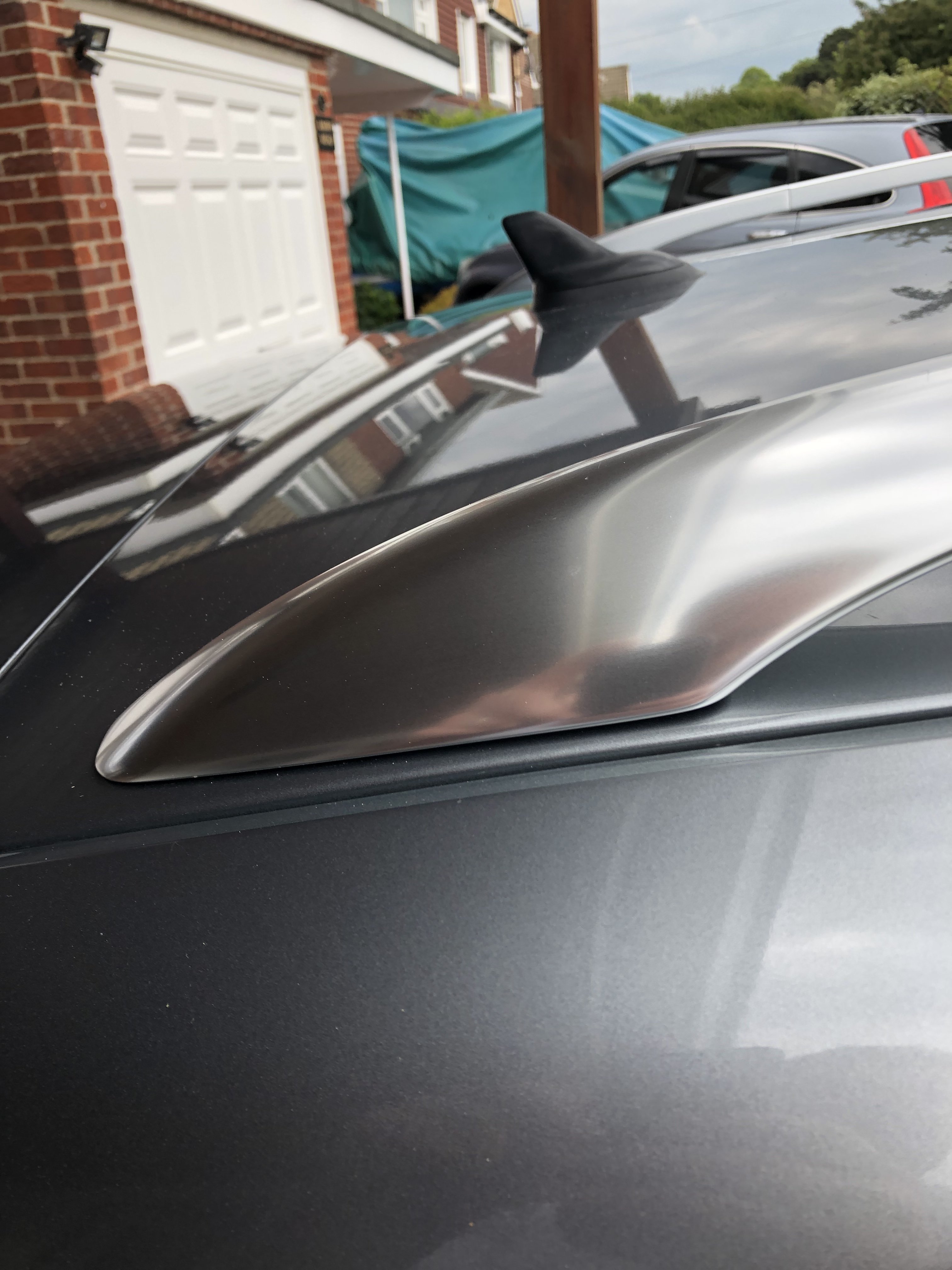

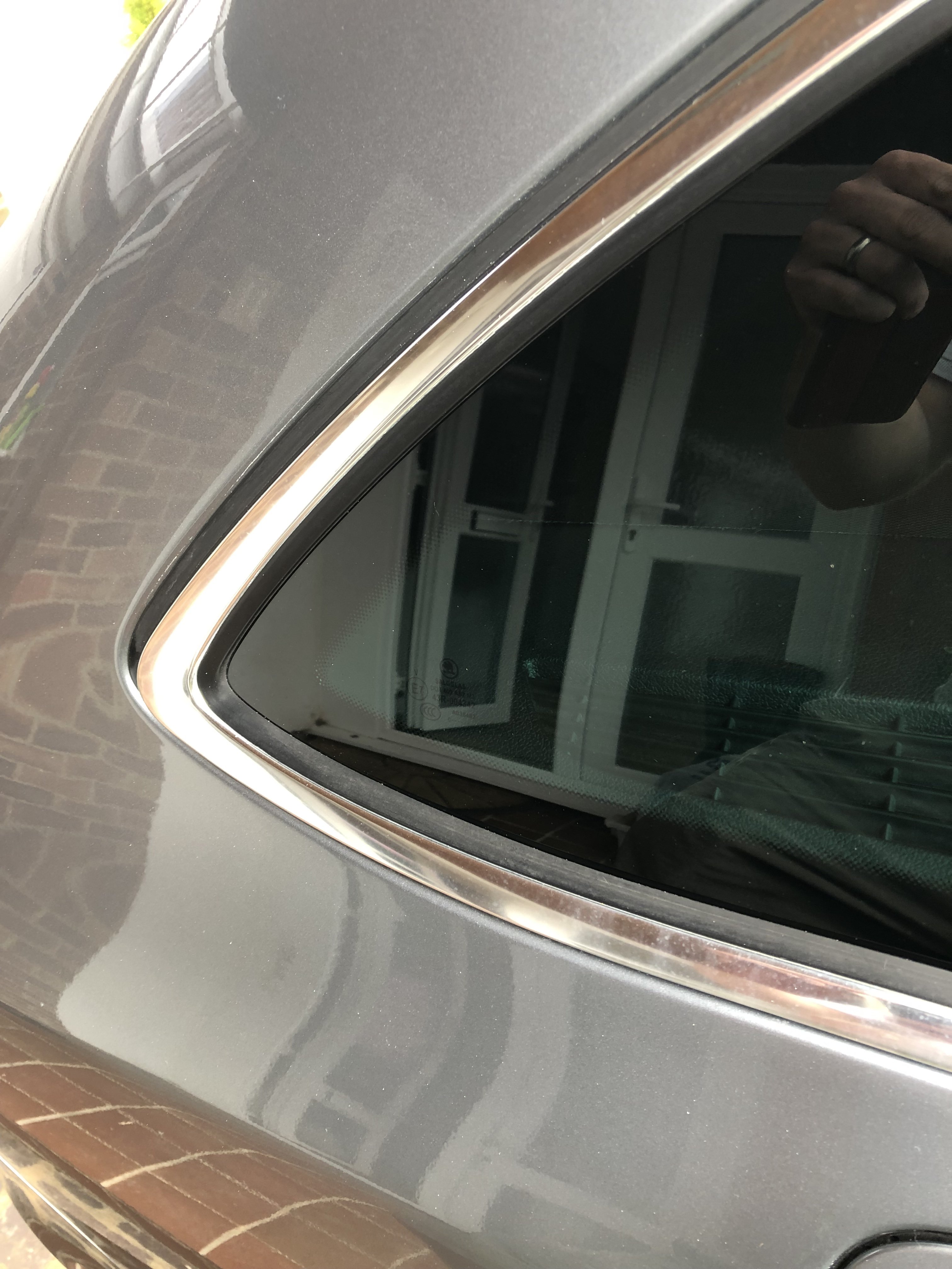

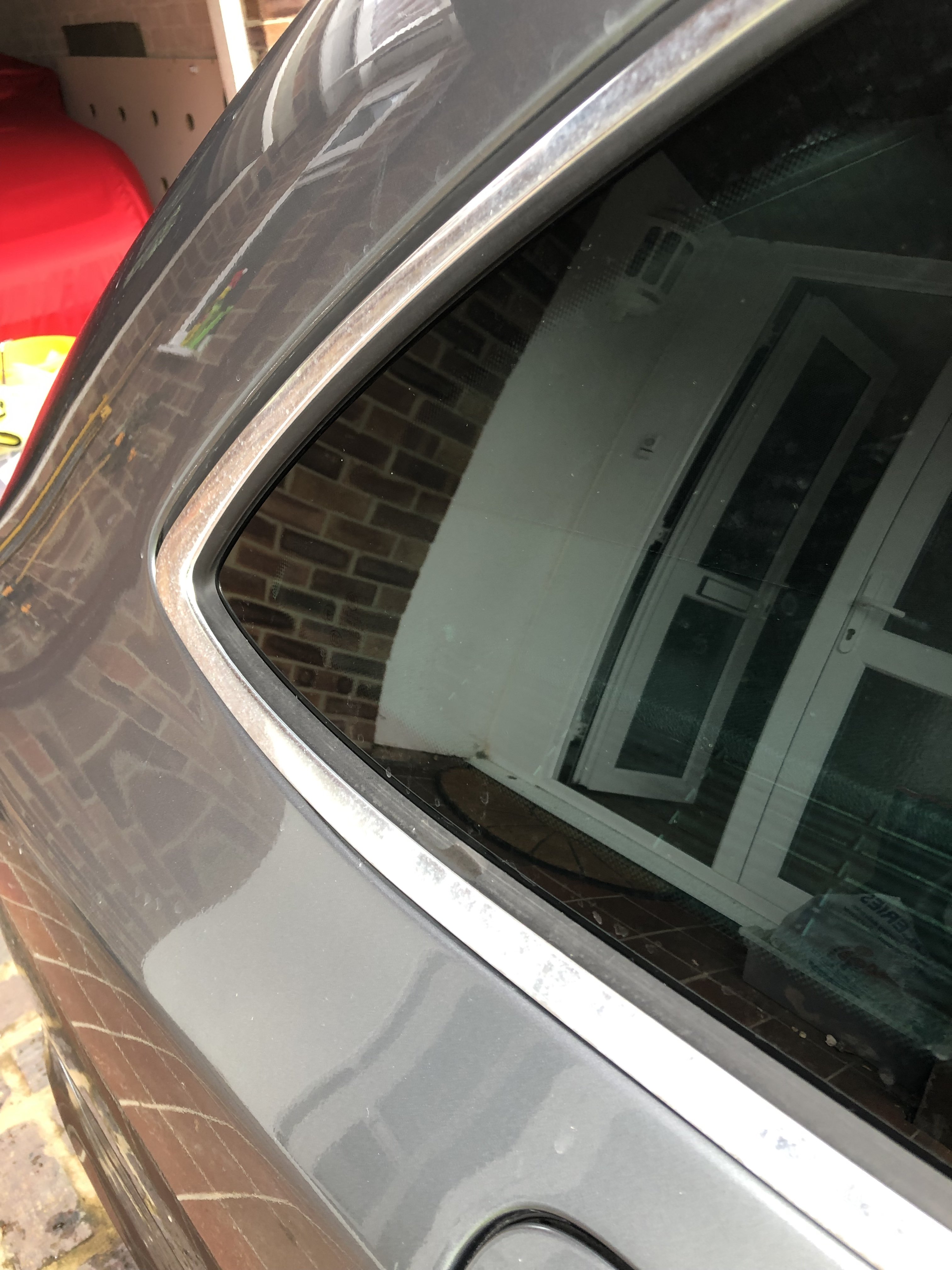

On a more positive note I had a day to properly clean the car today. Looks like it had never had a good clean in all its days. I started off by removing a lot of tar, then the clay bar came out, followed by a polish and wax. She cleaned up as well as I could have asked for apart from the chrome. The roof bars are ok but the chrome around the windows still look a little milky. I’ve attached a few before and after picture. Any recommendations on chrome polish would be welcome. These results were from Autosol.

Regarding your rear window sourrounds you're not alone.. I thought I was doing something wrong until I read your thread and read this one too..

Hi Gordon
Thanks for the link to the other posts, very interesting. I’ve a few other techniques I want to try before I start paying out to replace the unit.
With regards to wrapping to trim, that would be a very reasonable and effective solution. The worries some people have that the vinyl wouldn’t stick are ill informed. The only issue you might have would be that once the vinyl is fitted it might shrink around the edge as there’s nowhere to tuck the edges. Shrinkage would be minimal (less than 1mm each side) but if you went for a colour change the edge would be very obvious.
Also from my experience “chrome” vinyls aren’t very flexible and may be a little tricky for a DIYer to lay properly.
