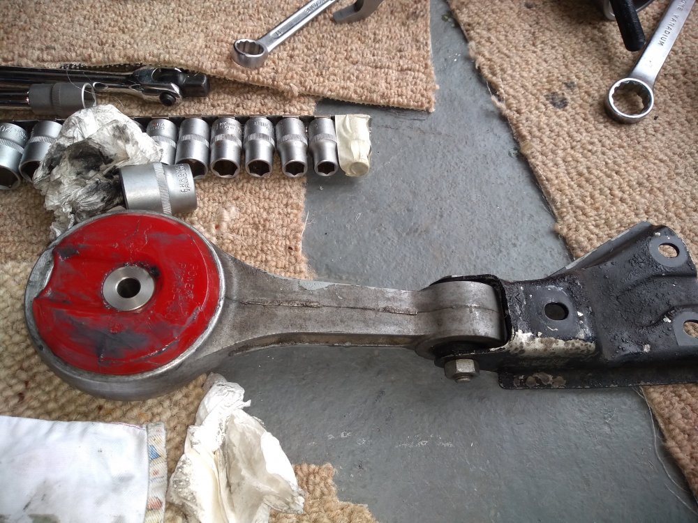

Hi, I'm looking to replace the lower engine mount and I'm after opinions on buying options?
I've searched, but opinion is divided on OEM or Aftermarket. The 3cylinder Fabia seems to recommend OEM, whereas, the 4cylinder Vrs Fabia recommends either.
The reason for looking to upgrade is that having just replaced the front and rear console wishbone bushes with powerflex and Cupra solid bushes, respectively, the car changes gear much better, the car actually tracks ahead and corners like a dream.
I was looking into buying PFF85-620R Powerflex Lower Engine Mount Large Bush (Diesel)
The car is a daily driver.
I'm worried about vibrations. I already have some with the new bushes in lower rev range, but the gain in drivability is worth it.
Has anyone got this bush setup and tried the red diesel powerflex bush and can comment on vibrations etc.
I don't want track hard bushes, above 70 shore hardness?
Is the gearbox mount worth replacing? Anyone got a pic of what it looks like, guide on changing it? I heard it is under battery tray.
Thanks
The work is not worth doing unless your mounts are perished or damaged because the increase in vibration is very noticeable, the consensus over the years is that the stiffer bushes offer no gain for a lot more pain.

I disagree. The red PF engine mount bush does noticeably increase engine vibration IME.
Pointless yes, arguably, but if you’re keeping the car long term it’s one less bush to worry about.

i once had a Mk4 TDI with 240k on the clock, put the diesel one on and it was fantastic with no vibes!
if engine mounts or the other end of the dogbone are worn then that may have been an issue... but the red are designed to not give vibes
https://powerflexstore.co.uk/skoda/fabia-2000-2007/
I fitted the red diesel one. There are 3 bolts on the front of dog bone bracket, and 4th longer bolt going through the centre of the donut bush. There is a slight vibration on steering wheel at idle, but the Vrs does gear shift much better. I can even select 1st before the car is stopped and the rough change into 2nd has disappeared.
Worthwhile it seems if you have a 4cylinder engine.
I used to have the vibra-technics solid mount and although it did bring extra vibration into the car personally for me is was fine. The gear shift was much better, traction was better with wheel soon more controlled with no bunny hop effect you can sometimes get. And you could feel zero engine movement when accelerating and changing down gear.
I changed it for the red superpro bush after a few years and comfort levels were better but you could feel a bit of movement when accelerating etc.
