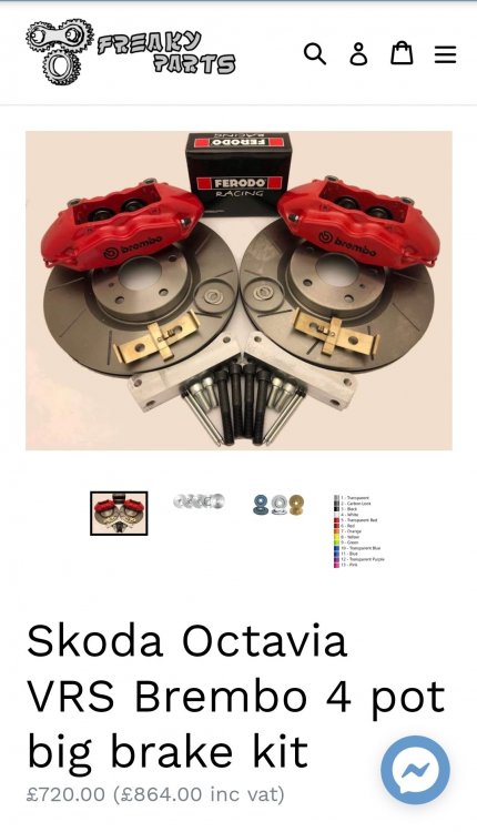

Fabia Big Brakes
Is this doable? To put a big brake kit on a Fabia which is designed for an Octavia Vrs.
Link Below:
https://freakyparts.co.uk/products/skoda-octavia-brembo-4-pot-big-brake-kit?variant=7294799249453
my question would be why ?? especially @ £800 + 😮  I would have to REALLY need them !!
The standard brakes on my RS are great, and if your siggy is correct, you have a Monte carlo which don't really need them.........or am I missing something.

Thanks for the reply mate but I'm only asking is it doable?
Yes it's a Monte
Edited by fabia_simon
Im not sure if those specific ones will fit, I think it depends on the alloys you have as well.
There is quite a few who fit bigger brakes.....usually using parts from other VAG cars, try a search on here for it....and or convert drum brake rears to discs which would help no end
Edited by UrbanPanzer
I believe the 4 pot VW Touareg Calipers may fit from what I've seen online.
I'm running 17" wheels, I've measured and should just fit. Second hand unrefurbished calipers go for about £175-200 Mark
Just found some Brembo GT-r calipers................over £1000 😮

Anything is possible if you spend enough or can do the work with the bits you want.   Better options than an Octavia Kit available so that you can use the wheels you already have.
So what actual Mk2 Fabia Mk2 do you have, petrol with what engine output or diesel & what are you doing with the rear drum brakes or is there already a disc brake conversion done?
