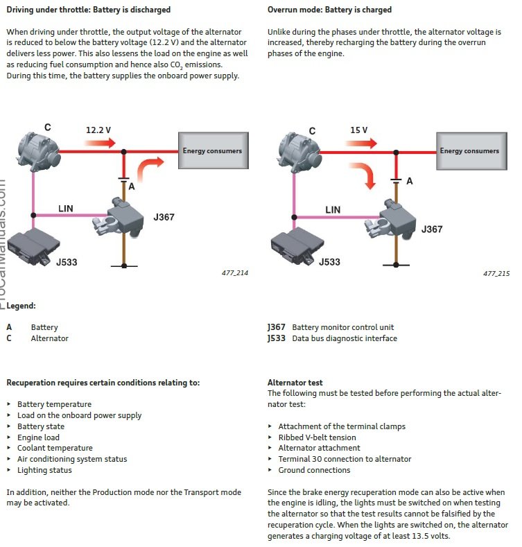

All cars with Stop/start are what are classed as micro hybrid. They have battery management schemes that include energy management and recovery to reduce fuel consumption and emissions.
Simply put, when you accelerate, battery charging is switched off, when you coast/ decelerate, battery charging is turned on to recover energy using the alternator. Of course its a lot more complex than that as power consumers need to be managed and battery SOC needs to be monitored. Target SOC is around 80%, so that there is capacity to recover energy, but enough to restart the car, or keep consumers going when stopped. A current sensor on the battery negative terminal allows the car to manage the battery state, (coulomb counting).
Look up the term micro hybrid and get your 46 yr old car electronics knowledge up to date.

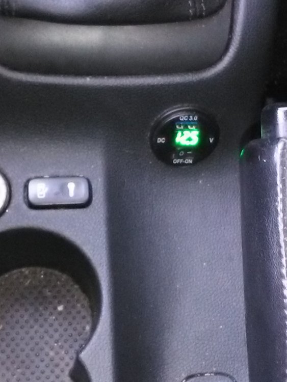

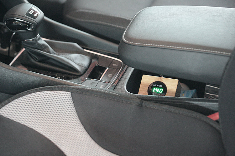

I have one of those distribution sockets connected for my dash cam, satnav and phone charger.  It has a voltmeter display to show it is switched on.
I have notced the voltage is 13.3 when power is applied but jumps to around 14.5 when slowing under engine break.   This is how the regenerative breaking is working.  Low current charge when driving but greatly increased current when slowing.

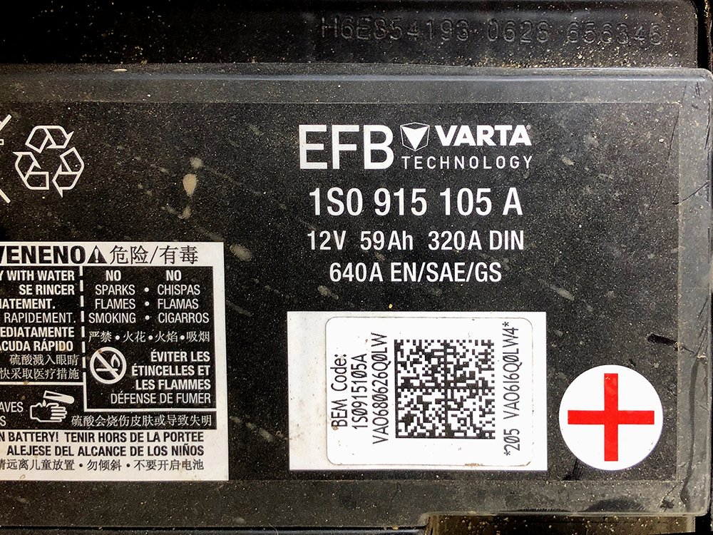

Mine came with a Varta EFB Technology of 59 Ah.
As I understand, on start/stop cars the battery should be either EFB (Enhanced Flooded Battery) or AGM.
All new VAG cars and not just them have the new "green" energy management system, which utilise brake energy recuperation ... This stay behind the flat batteries left at 12V and lower state ...
It is based on Start-Stop system, but it can not be switched off by the switch as Start-Stop. Pulling the connector from unit J367 out can do the trick for both systems :cool:
As I thought....the new battery is bigger...checked my friend's Ateca and that is 59 Ah too.
