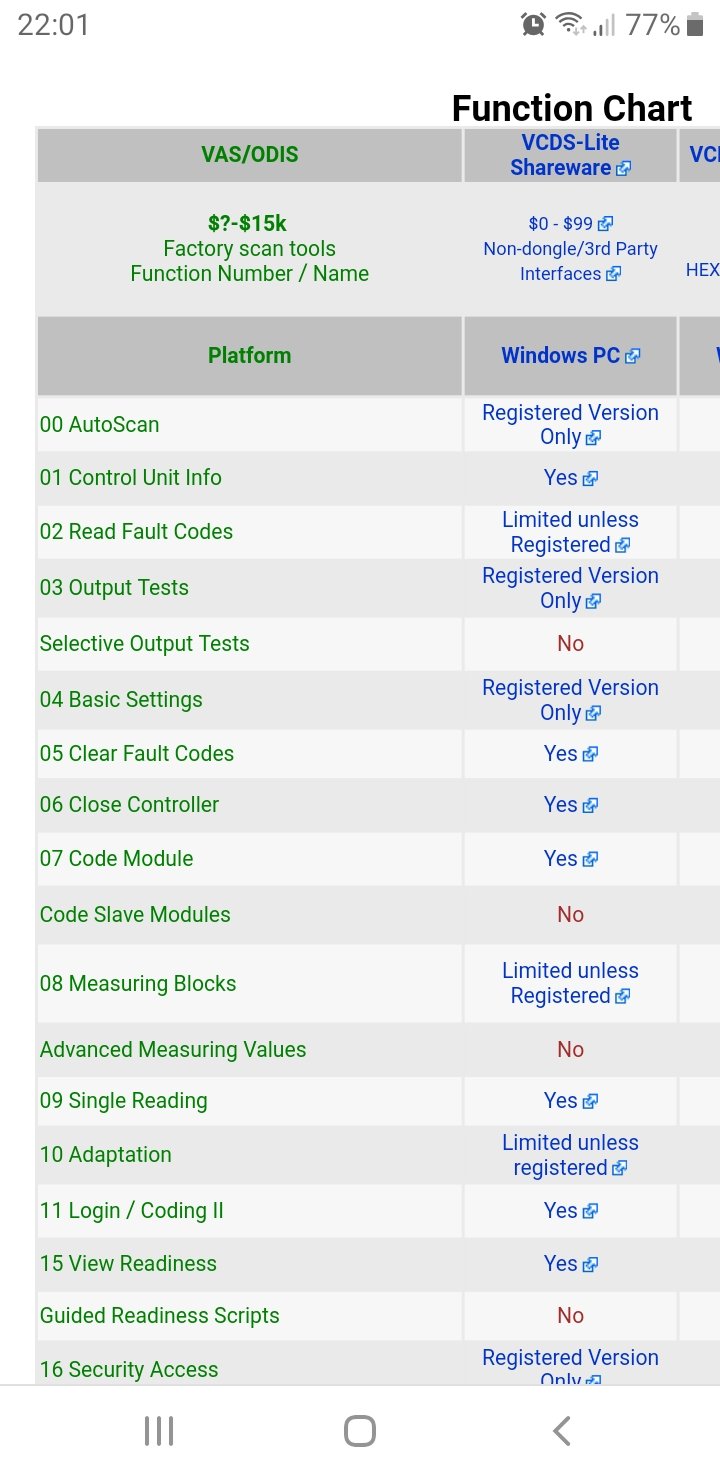

This is Ross-Tech's (the manufacturer of VCDS) comparison chart for their different products: http://wiki.ross-tech.com/wiki/index.php/Functions
If you have any questions after reading it, feel free to ask.
EDIT: Having a quick read of it myself, it looks like VCDS-Lite only reliably supports fault codes up to the 2006 model year which would rule out many of the Superb's modules if not all.

Can VCDS Lite do airbags? I know rosstech are particularly careful when it comes to that system.
I'm not too sure.
It looks as though it should, "05 Clear Fault Codes - Yes"...

Further down on that list they note that the code database for VCDS Lite is only guaranteed up to MY 2006 so it's probably not going to work on a Superb 2 unless it's a very early model with modules carried over from earlier PQ35/PQ46 cars.
VCDS lite doesn't support 'diagnostics via CAN' so I'm pretty sure it'll be useless on the OP's car.
