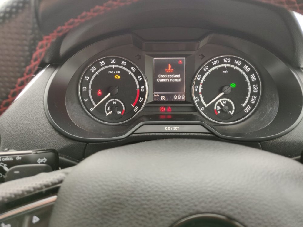

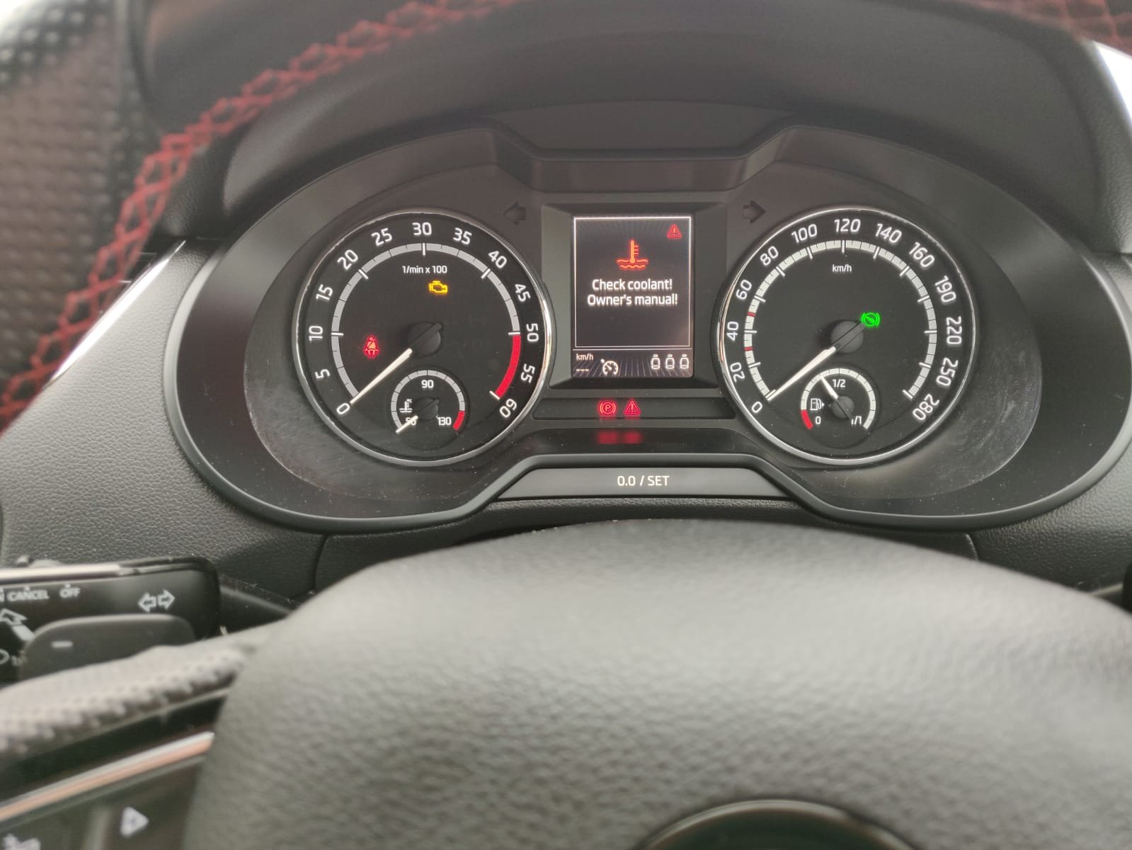

Hi Everyone,
I'm new to this site, My girlfriend bought a 162 2.0 Deisel Vrs with 93,000km (66 UK reg I think) 2 weeks ago from a main dealer Bolands (Ford, Hyundai, Volvo) drove home from Wexford to Cork approximately 200KM and the Engine overheated.
Straight away we wanted our money but they said no hope of that. There was 7 days left on the Skoda 3 year warranty which was up on the 1st of July 2019. The dealer took 5 days before they brought the car to Skoda. They changed the water pump but not the timing belt. (They never gave us the option to change the timing belt). She got the car back last night at 18.30 on the 2nd of July. They drove the car 200KM back to us now there isn't a drop of coolant in the car. Is that normal?

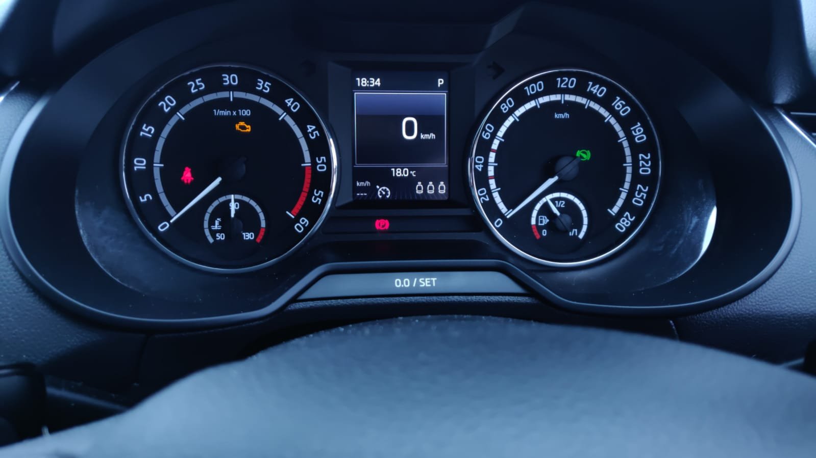

We never drove the car last night. When it was dropped back last night at 18.30 we checked the car again and 21.30 and the temperature gauge was still at 90°. We took pictures of the coolant and there was barely a drop in the expansion tank. Woke up this morning and there wasn't a drop of coolant in the expansion tank. I checked the engine and there was no visible leaks and underneath the car was dry.
Now there is coolant warning lights on her. When she is idling for 60 seconds for temperature guage rises fairly rapidly. Do TDI VRS's engines get hot quickly? I think it's a disgrace a car we bought 2 weeks ago and had for less than 2 hours is doing this. We just want our money back but they won't give it to us. Any help advice would be greatly appreciated.

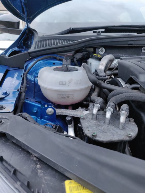

Last night it was really low but now it's empty.
Coolant expands when its hot so unless you have a puddle of it under the car I would guess there is some in there but not visible in the expansion tank.
Maybe they just didn't put enough in after the pump replacement?
Try topping it up as per the manual.

When you say there isn't a drop off coolant in the car do you just mean the expansion bottle? The level on the picture isn't that low (just below min)  on the expansion bottle and may be due to a bit of trapped air after the pump replacement - the coolant looks a good colour as well- I'd say try topping up and see what happens.
If things are working correctly then your cooling system has been designed to get up to temperature quickly (90 on the gauge) and then it should stay there. This is to get the catalyst lit up and doing its job thus reducing emissions.
I changed the radiator on my sons Octavia a while ago and it took a while to get all the air out - had to run it up to temperature (fan running)  with the Filler top removed and with the engine off squeezed the rad hoses and the odd large air bubble kept coming to the surface for a while. It's been fine since.
One thing I would suggest is getting a full timing belt kit fitted fairly shortly - I'd never trust a timing belt that has been removed and re-fitted

Sorry that's my fault I didn't explain very well. I'm typing this in frustration and anger.
What I meant to say was there isn't a "drop of coolant left in the expansion tank" and there "isn't a drop of coolant on the floor or on the underbody cover"
You recommend:
1) topping up the coolant
2) Fan running (internal blower is it?)
3) Expansion cap removed
4) Turn off the engine and squeeze the rad hoses?

Fan running - that's the radiator fan running meaning that it is well up to temp and thermostat(s) open - if closed they can trap air!
and yes turn the engine off first before squeezing rad hoses
I suspect what you have seen is normal and it has not lost coolant - it's just displaced air! The level in your picture is not that far under min.
I'd still get the cambelt done soon though once this is sorted (if there is anything to sort!)

I would top it up and stop panicking.  Sounds like there is some air left in the system.  I had to top up my coolant after water pump change. Been fine since.

Topped it up with coolant so far so good.
