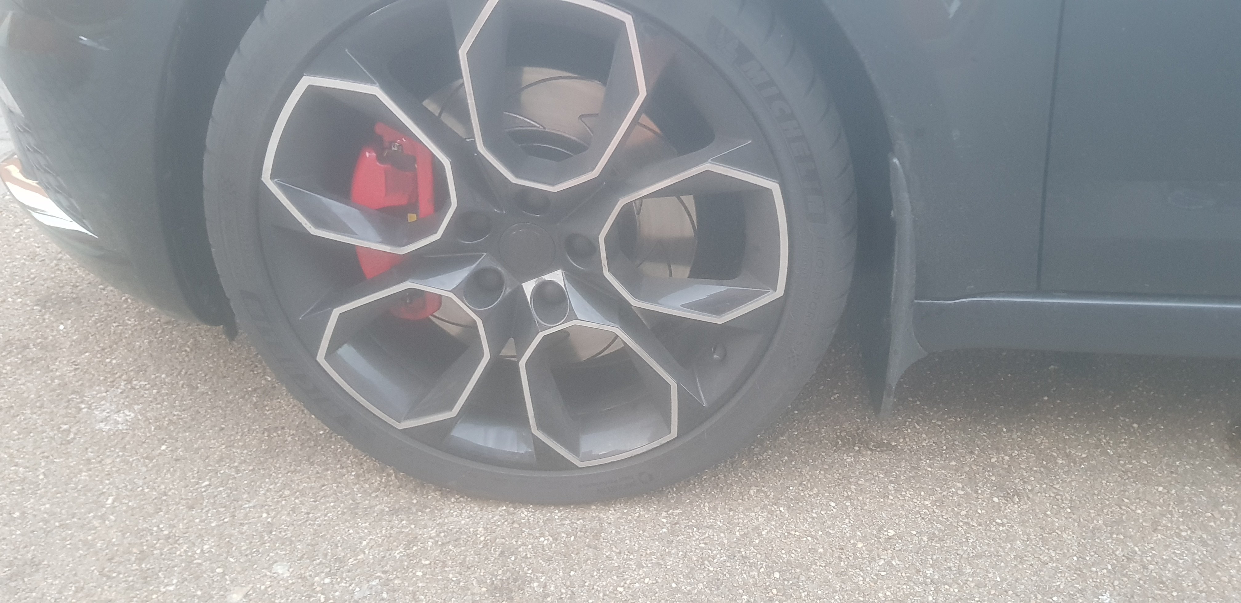

Hi well I've got the 340mm with yellow stuff pads in and got to say I'm well disappointed with the feel and braking power. Thought they would feel the same as my mk2 with an S3 setup on, but they were a lot nicer in feed back and stopping. I don't know if it's got something to do with the master cylinder and abs pump that's different to the mk3, but the feel is just not there. I've been looking at racingline monoblocks myself and also golf R 4pots from killerbrakes which are very well priced.

Standard which was the same as my mk2 but comparing both side by side theres just not the feel or confidence in the mk3.
