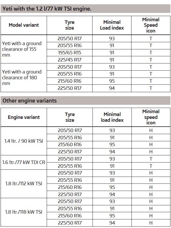

225/45 R17 is an approved size for the 1.2 TSI Yeti with a ground clearance of 155mm.

It can be on the 1.2 depending on ground clearance.

The 45 is not an 'illegal option'.  Maybe not advisable, but not a MOT failure, or an Offence you will get a Police Charge / Fine / Points / taken to court with in the UK (England/ Wales, Scotland or Northern Ireland) and not even a fitment that will VOID your insurance in the UK.
(As long as Correct Speed /Load Ratings, tread etc, and actually tyre sizes that will be Type Approved, which they are.)
As to different front and rear but the same on an axle, that is not illegal.  & the car is not AWD, but even AWD's can have different front and rears. ie Audi on some platforms.
