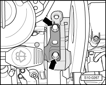

Actually...   Is this related to the top rhs mount with the two stretch bolts that needs to be parallel?
Edited by skomaz
Yes
RHS?
Does this mean on the cam belt side of the engine?
The internet shows the mount to be 2 parts, a large 'triangular' casting bolted to the engine with 3 bolts, 2 very long.
Then there is the 'rubber' side that bolts on top of the engine and to the body. This block has 2 vertical bolts that pass through 2 elongated slots in the cast body of the rubberised mount. There is a plain hold between these two slotted holes.
I guess the 'parallel' term is to get the 2 bolts to be equally in the slotted holes so to have the mount 'parallel' to the engine?
Thank you to all so far in this quest, got to get it fixed!
Yes, those are the ones!
The 2 bolt holes are slots to allow alignment of the mounting and the engine/shell with the weight of the engine in place. I presume it is easy to have some contact under some circumstances if the parts are under some mis-alignment.
The centre hole I guess is used to position the engine and body parts of this large mounting.
