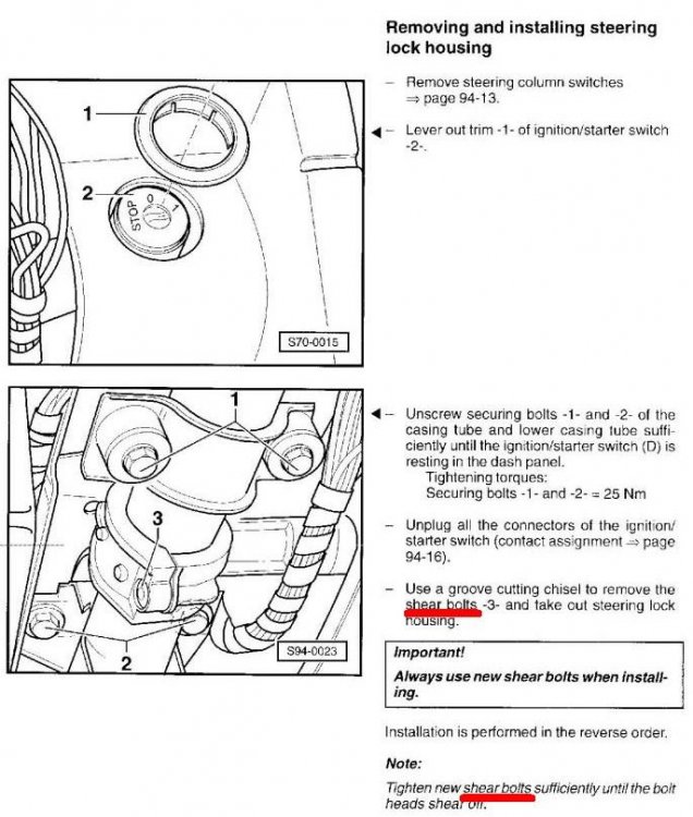

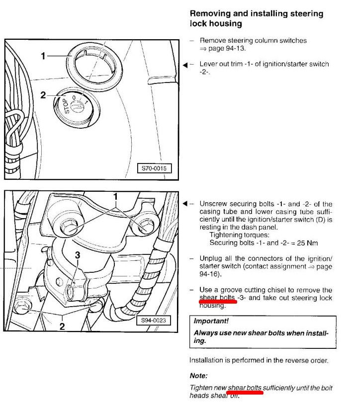

Wait aren't these bolts meant to break in a collision? I think you should avoid slackening and tightening shear bolts.
No, shear bolts don’t ‘shear’ in an accident. They shear off when you install them to prevent someone being able to undo them again easily. It’s a security device.
Ah sorry I thought that the felicia had some predifined point of failure type deal going under the steering column to create a collapsible steering wheel for protection.
It does, but that is not it.
The only shear bolts in that area are those holding the steering lock housing. That is for security reasons as Tech1e mentioned. Shear refers to head of the bolt shearing at a certain torque to avoid unscrewing it by thieves.
