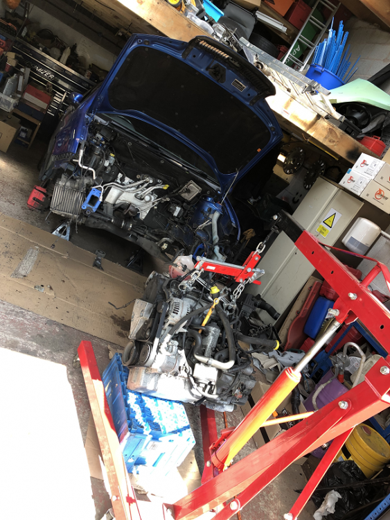

Yep. I had a cambelt kit, water pump, flywheel and clutch and a radiator to do recently, quickest and easiest way...
