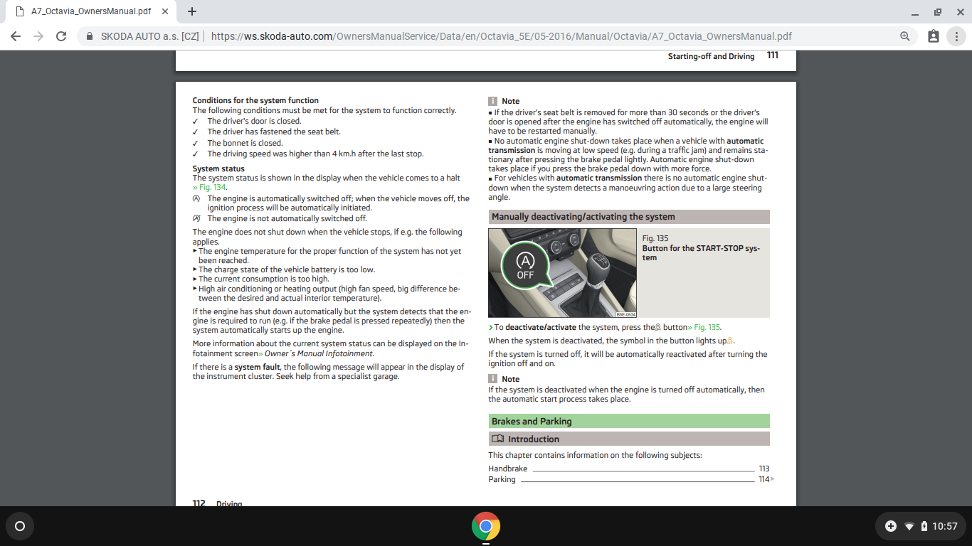

Seek help from a specialist garage
So not Skoda then. :D
So, ultimately, I didn't realise that the infotainment unit actually told you the reason, that makes it somewhat clearer one I found it.
I definitely agree that the messages can be cryptic though, messages such as 'power consumption too high' or 'engine needs to be running' don't really explain the reasoning, lol.
