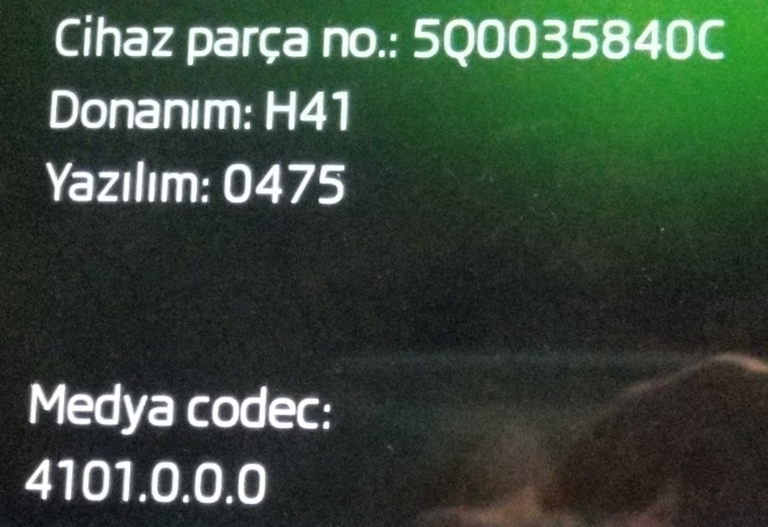

Hi,
Device Part Number: 5Q0035840C
Hardware: H41
Software: 0475
Media Codec: 4101.0.0.0

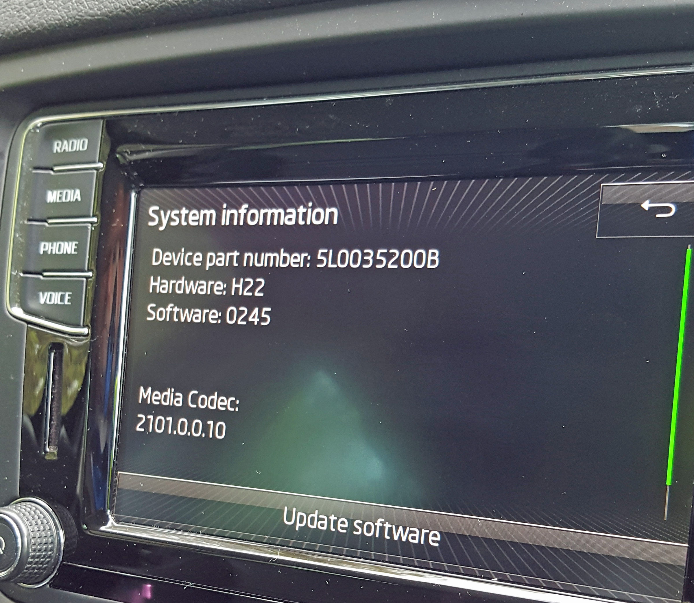

Hi,
I am having some problems with the Bolero unit in a 2016 Yeti Outdoor SE: the screen images judder, the radio preset stations change by themselves, the screen freezes, and other faults.......
I was hoping that a software update may help with these problems and would be very grateful if you can tell me if there is any software update for my unit:
Device part number: 5L0035200B
Hardware: H22
Software: 0245
Media Codec: 2101.0.0.10
Many thanks,
Mark

All check your PMs, if you don't find link to download file then I have no newer version for your unit.
@pab567 Many, many thanks for the file. I was able to update the software successfully.
Just for others, how it worked for me:
1. Download the file.
2. Extract it to a folder.
3. Copy the folders/files INSIDE the MST2_EU_SK_PQ_P0253T folder, NOT the whole folder.
4. Paste the folders/files to the empty/formatted SD card. The first folder should be the Bluetooth folder.
5. Radio off, ignition off, Insert the SD card.
6. Ignition on, turn radio on.
7. Press and hold the physical plastic 'Menu' button on the right hand side.
8. 'Service Menu' appears after 5-10 seconds.
9. 'Update'.
10. Sit back with fingers crossed while the screen turns on and off when it is updating. 5 minutes later - success!
Good luck...........
Many thanks again to pab567
Regards,
Mark
