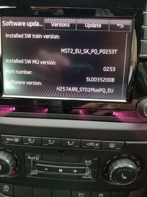

Can anybody tell me if there is an update for this cheers
I am 99.99% sure that there's 0253 version, but you should press and hold Menu or Setup button for 10 seconds to find your Software Train information (this also has the firmware update button)

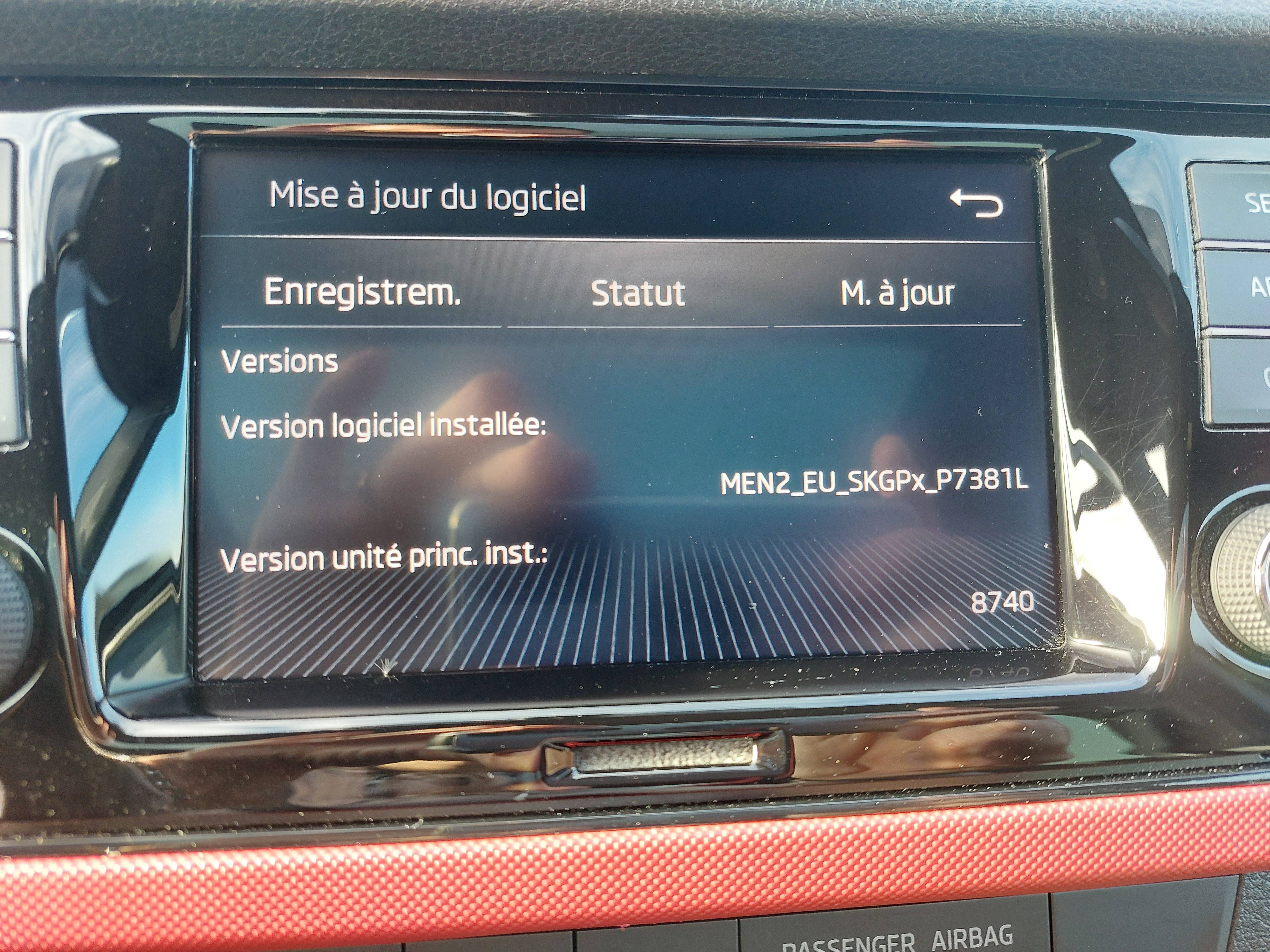

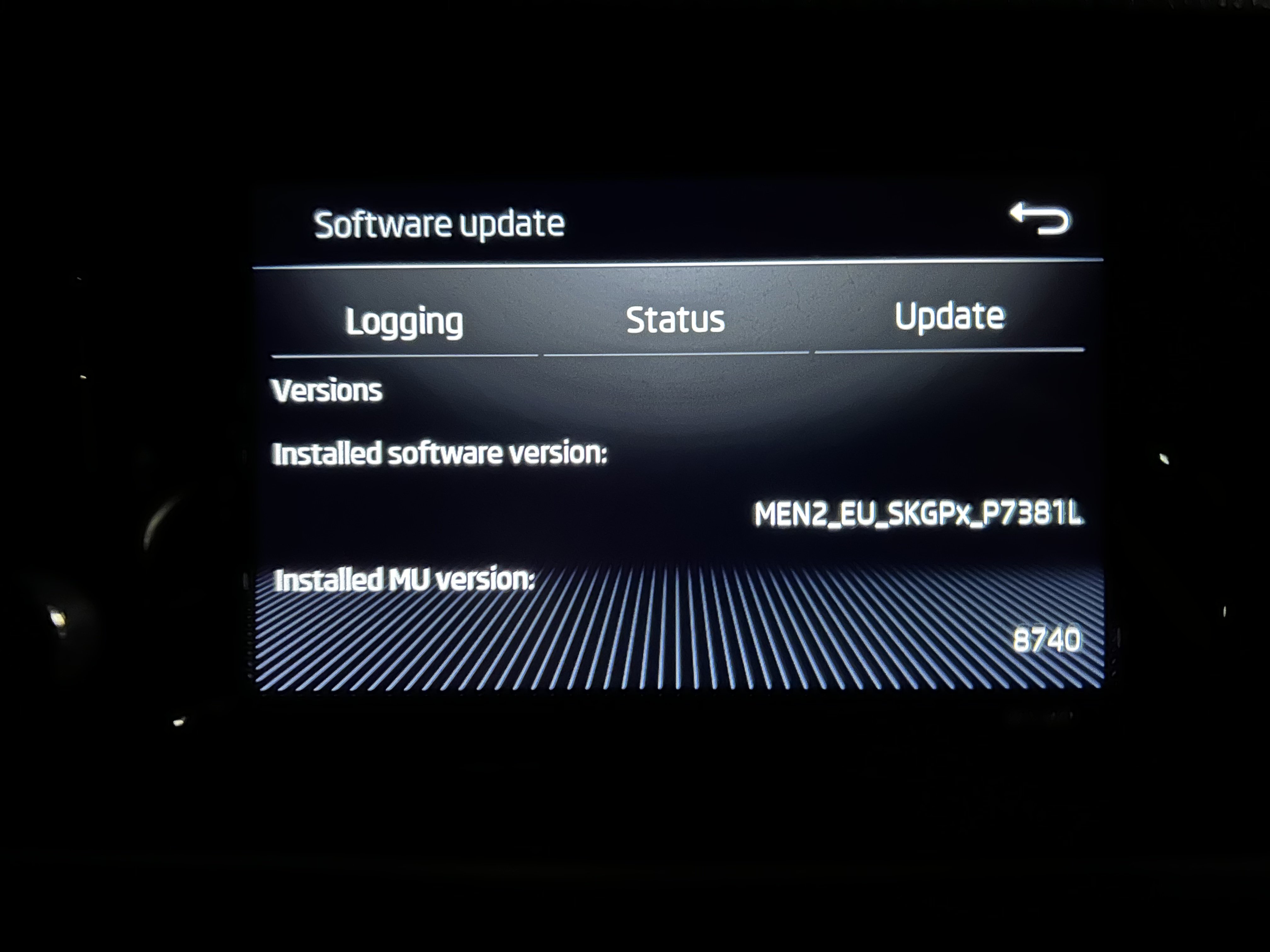

Hi, I have software version 8740 and looking through this thread looks as though I need the 8755 update. Is there a link to that anyone can provide? Or is more information needed? Would be greatly appreciated
I will send you a link via PM, odds are it's the correct file.
Hi thank you so much for your help but it says error the software train is attached.
Was it the right file? Understand if it is and it just didn’t work.
appreciate your help on this
MEN2_EU_SKGPx_P0080L_MU8755.7z
This should be the correct file for the software train.
SD Card in FAT32?
Are the files in the root of the drive, and not in a folder called "MEN2_EU_SKGPx_P0080L_MU8755"

Amazing, makes sense. Any chance that when you have time you could send it over again? The link has timed out.
no rush! Thank you
no rush! Thank you
Done, best of luck

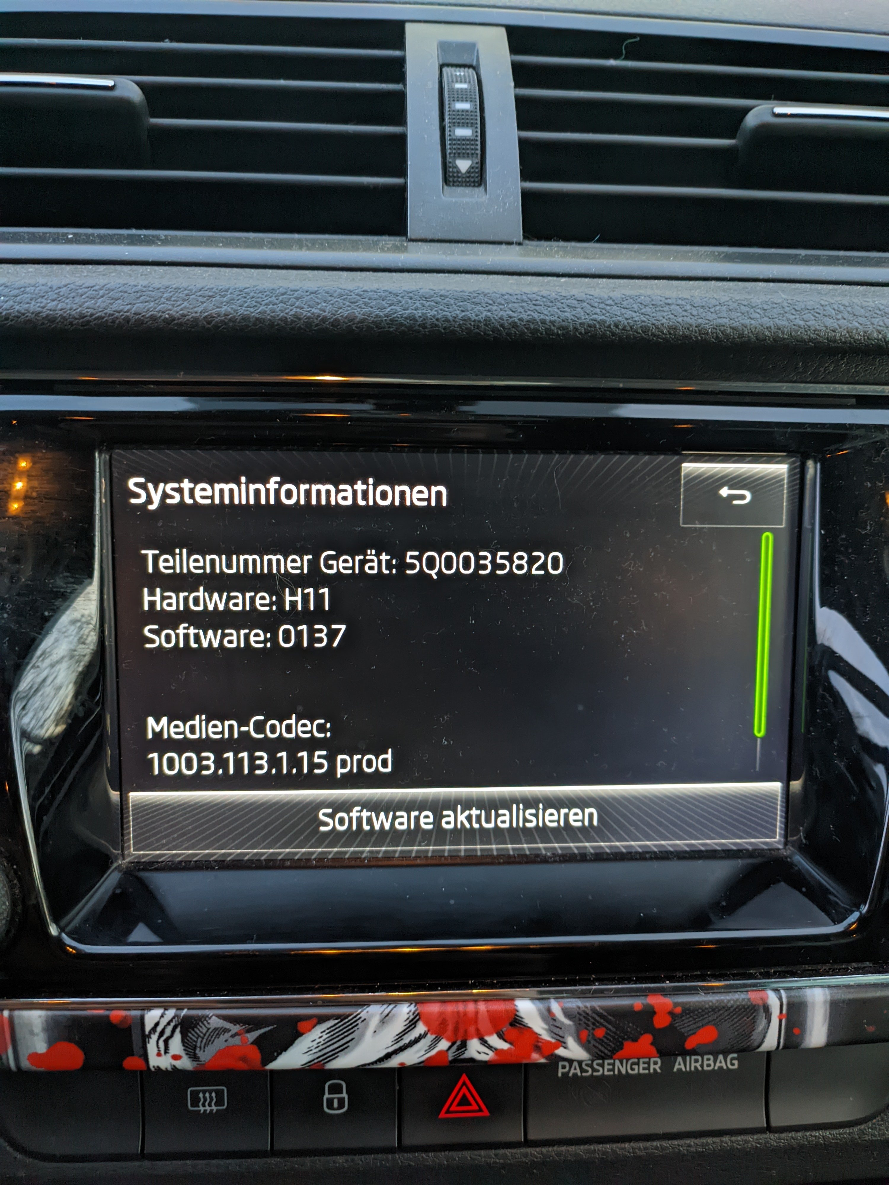

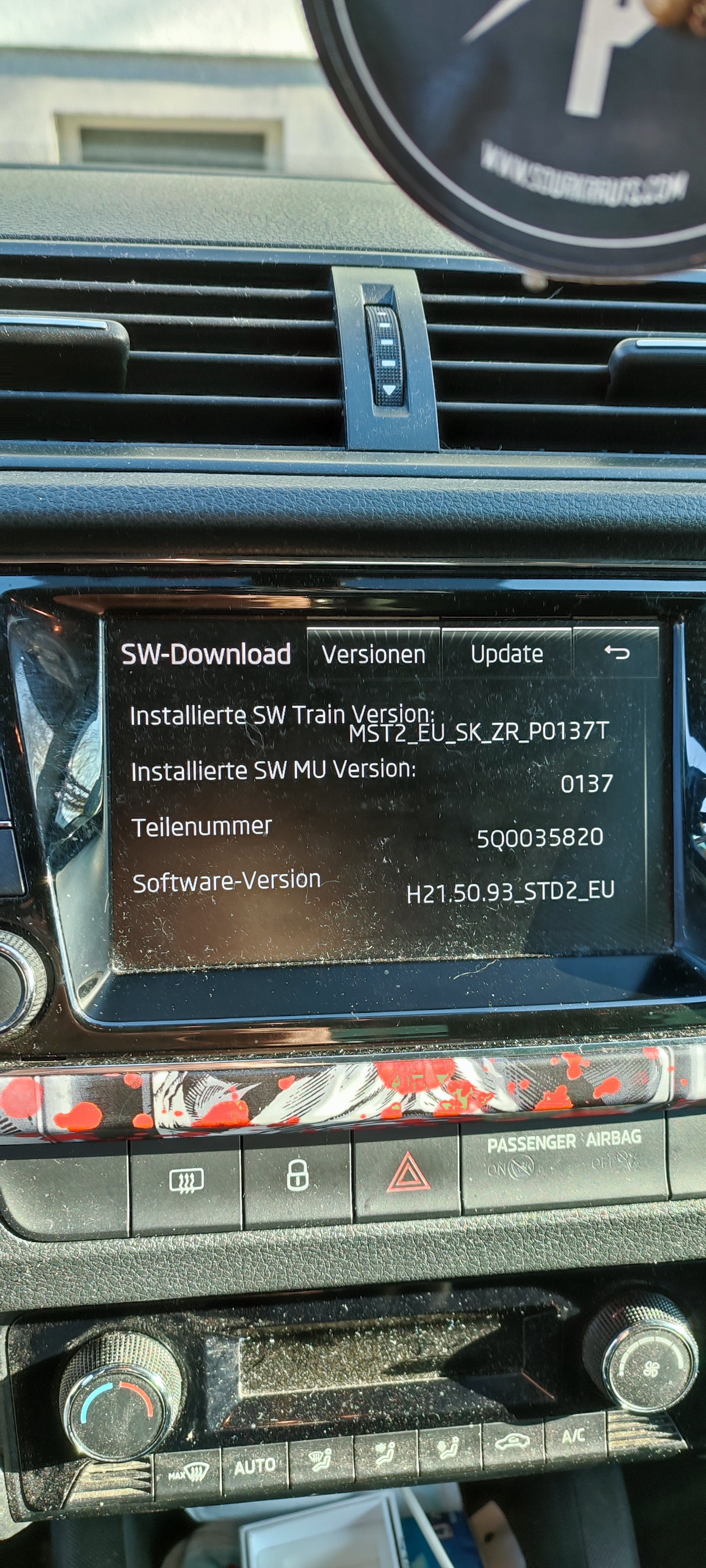

Hello, i'm new here. I'm looking for a help. A bought a car. Skoda Fabia Combi. Now it seems radio has mirrorlink, but don't have apple car. Could update fix that?
Device part number: 5Q0035819
Hardware: H11
Software: 0137
Media codec: 1003.113.1.15 prod
If anyone has update please send me pm.
Thank you
Hardware: H11
Software: 0137
Thank you
The update cannot fix Apple carplay, those features are turned on by release codes.
0138 is latest for your information.
