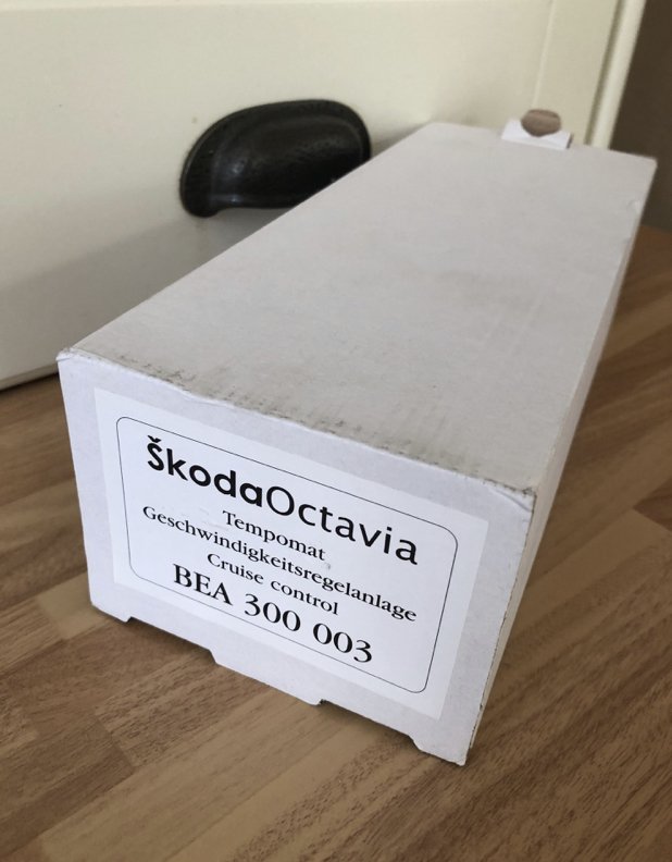

When retro fitting cruise control to an Octavia Mk1 (2002), is any additional wiring required? The car is 2.0 Petrol automatic. I previously had a 1.8T manual, and seem to recall that I had to connect an extra cable to the ECU. Also, I think I had to enable the facility using a laptop on the obd port. Any advice would be very gratefully received :-)

I think there is an extra harness required yes, but all the parts are available.
Yes there is a harness to go from the switch to the engine ECU.
The Skoda kit is pretty hard to come by, the last one I ordered took a while to land in the UK from CZ.

I bought the kit from my local Skoda dealer. Cheaper than the one linked above too.
