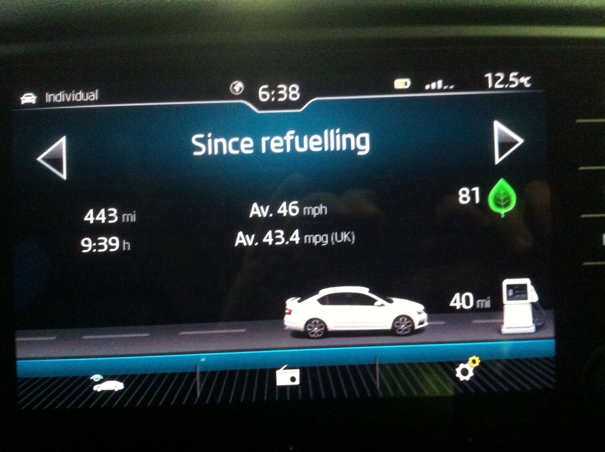

Been conducting an experiment with standard 95 octane BP fuel over the last 25 days and the results are quite surprising to me. Last tank 443 miles with 40 miles range left and only able to fill with 45.39 litres, which is a tank average of 44.39mpg. Over this period a total of 125.87 litres used (27.69 gallons) at an average of 42.72mpg which is a 5% improvement on my Shell V-Power 99 octane regular fuel choice. Conclusion is I must be driving slower due to less power available on the cheaper fuel (15 pence per litre cheaper).
An alternative conclusion might be that the energy density of the lower octane fuel may be higher. This is hard for some to understand, but octane rating is not related to the energy content of the fuel, just the way it resists pre-ignition. If the octane rating is boosted by the addition of ethanol, for example, this has a much lower energy density than petrol, so you can end up with a fuel that has lower energy content, for more money.

You're starting to drive like a grandad.
Should have mentioned covered 1,183 miles since 02/09/2019 and this has been with my alternative 7.5J x 18" alloys and 225/40R18 P Zero tyres fitted which will help drag compared to my summer 19" x 8.5J alloys and 235/35R19 Michelin PS4S tyres.;)
