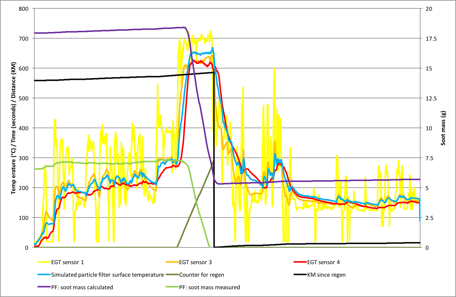

Super easy to check for the NOx update - you need the engine software version. If it's above around 9970 (from memory) then it's had the fix.
For genuine VCDS, ilexa or gendan are perfectly fine and a 3-VIN HEX-V2 should be around £225. With live logging it's possible to various values from the ECU while you drive. Here is a graph I made a couple of years ago showing some stats during an active regeneration:
You can see the regen counter (dark green) start to increase and shortly after the exhaust gas temperature rises and the soot mass (purple and light green) drops. Once the regen has completed, the KM since regen then gets reset.
