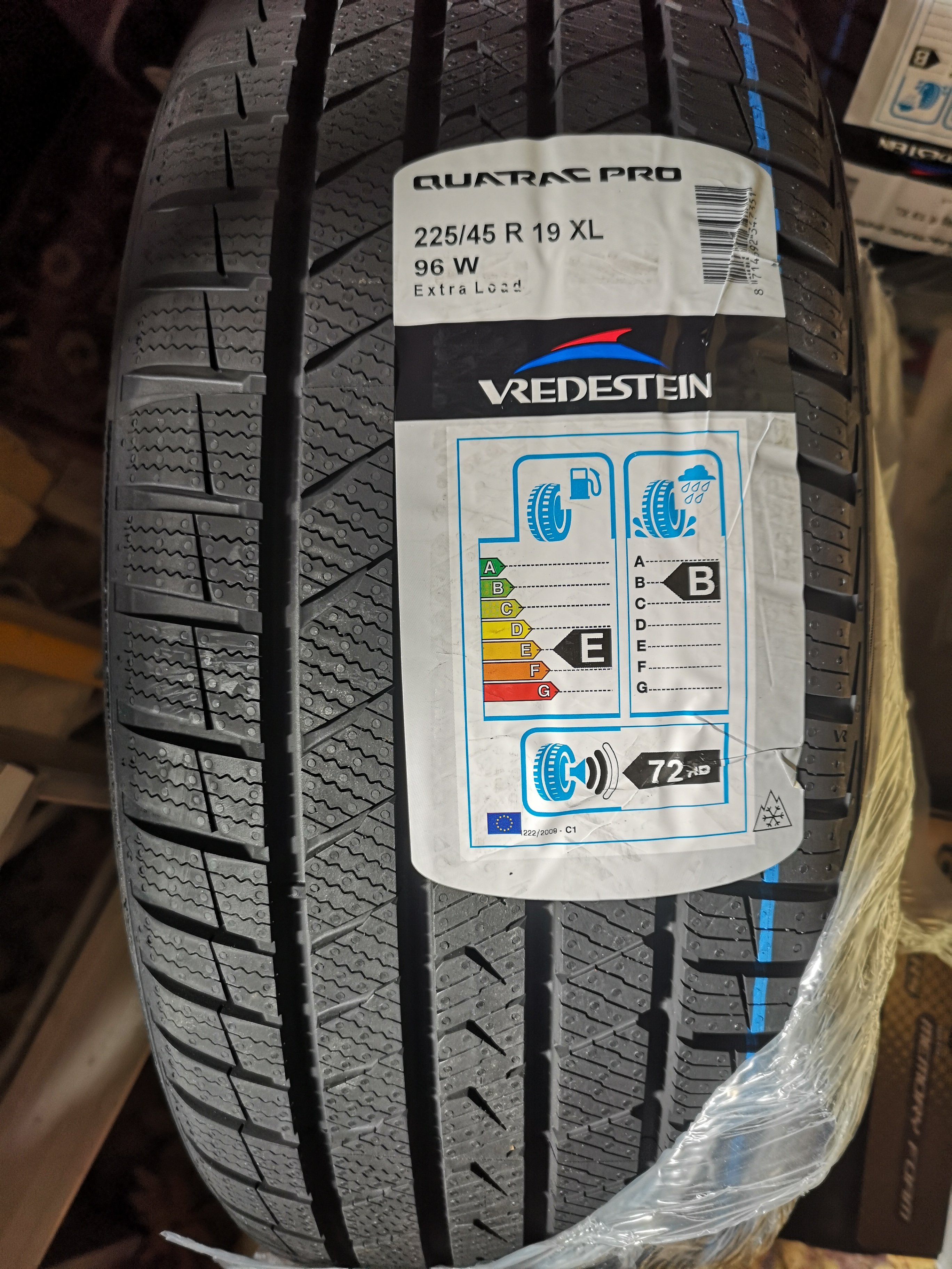

Finally ordered the Vredstein quatrac pro  Hopefully a good balance of both summer and winter tyres. Less hassle having to swop every year. £124 A corner and £60 cashback from camskills. Will update in a few months on performance
That would be great to hear how they go. Mine will need changing and I will be looking for a 4 season tyre in case winter gets a bit tough.

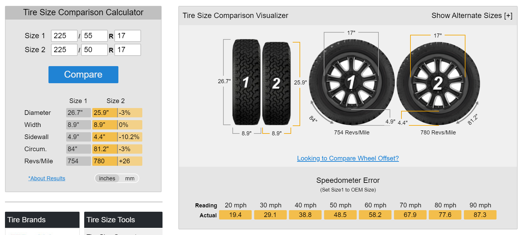

Speaking about winter tires I made weird mistake...went to fit winter tires and somehow i gave the information to dealer that i need 225/50/17 tires  they should be 225/55/ 17.) As i sad its 2.tdi 4x4 Karoq...what are the consequnces or to simplify....can i drive with those tires or i have to find solution to change them?
So they already fitted new tyres to new wheels?
If it was a Skoda dealer - they should have known
If it was AM dealer and you have not driven on them - maybe... they would change for a fee...
You can probably drive on them - but they are at the limit - which is 3% - also they will lower car by 10mm too.. so reduce ground clearance in snow..
Yeah...theyre fitted already Triton alloys,  Asked them later (it was
my mistake when i said 50 instead 55 -really dunno how i did this-but still, they should’ve known better).  they said except lowering the car everything else would be fine.
You best use GPS or roadside digital signs to know what your speed actually is compared to the speedo,
the table shows high your speed mught differe to the speedo for the OEM tyre size, but it already showed you were going faster than you actually were,
now it is likely even more inacurate.

I decided to go for all seasons and finally had these fitted just 2 days ago. Had them about 6 weeks but have been waiting to have the 4 wheel alignment done.
Let us know how you get on with the new tyres in day to day driving, compared to the awful Bridgestones I presume you have.
