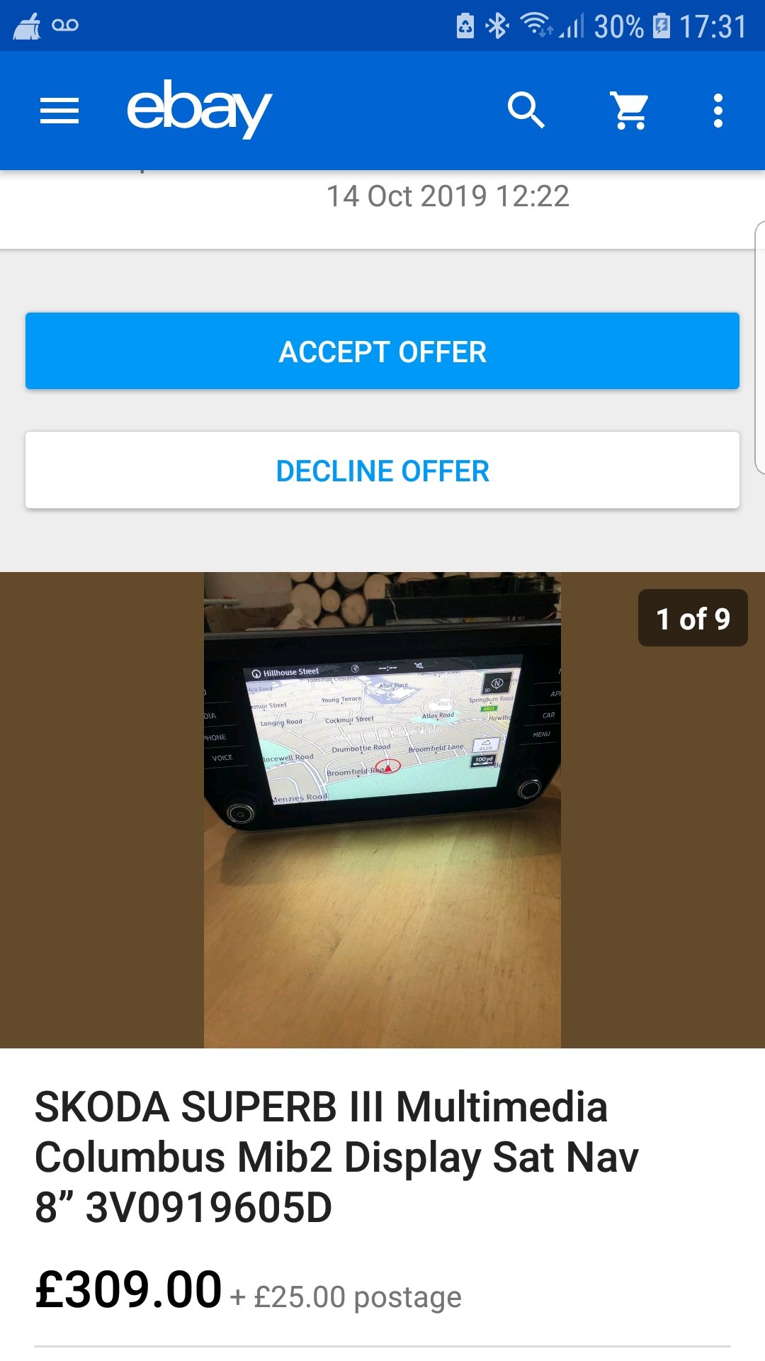

Sasha you are a bad influence on me 😂😂 ill stick with it so if a good auto electrician can handle it, im also dealing with a lad about the headunit from the other thread, these were the 2 things i really wanted to change, i got him down from 310 to 265, im not sure whether to go with it for 265, all seem to be asking 400 to 430
To be honest it’s not that hard to get them in and to get them lighting up as long as your car has xenon light support with the current BCM but getting the AFS and auto levelling to work is more complex. You will need to add the headlight range controller to the car and wire it the gateway to be looked up and coded among other things. I would do it, but that’s just me 😂
As long as all the pixels are ok that’s a bargain at 265. It’s not a Columbus screen it’s an Amundsen one but that’s exactly what you want. Annoys me when breakers get this wrong!! Beware the APP button won’t work. That’s normal but the backlight for it works fine.
Happy days ill go for it, ill list that 6" one on ebay i think its called the bolero, i think it will make a huge difference 👍👍
It’s a MIB2 Amundsen 6.5 inch screen. They don’t have that much value but be realistic with the price and you will be successful. I put my old screens for sale and sold all of them quickly as I would rather have the money than wait for a better offer to come through ad infinitum.
Id be the same ill put it up online and i have a sony xav-ax100 from my passat, so between the 2 of them it will take the sting out of buying the new one lol
