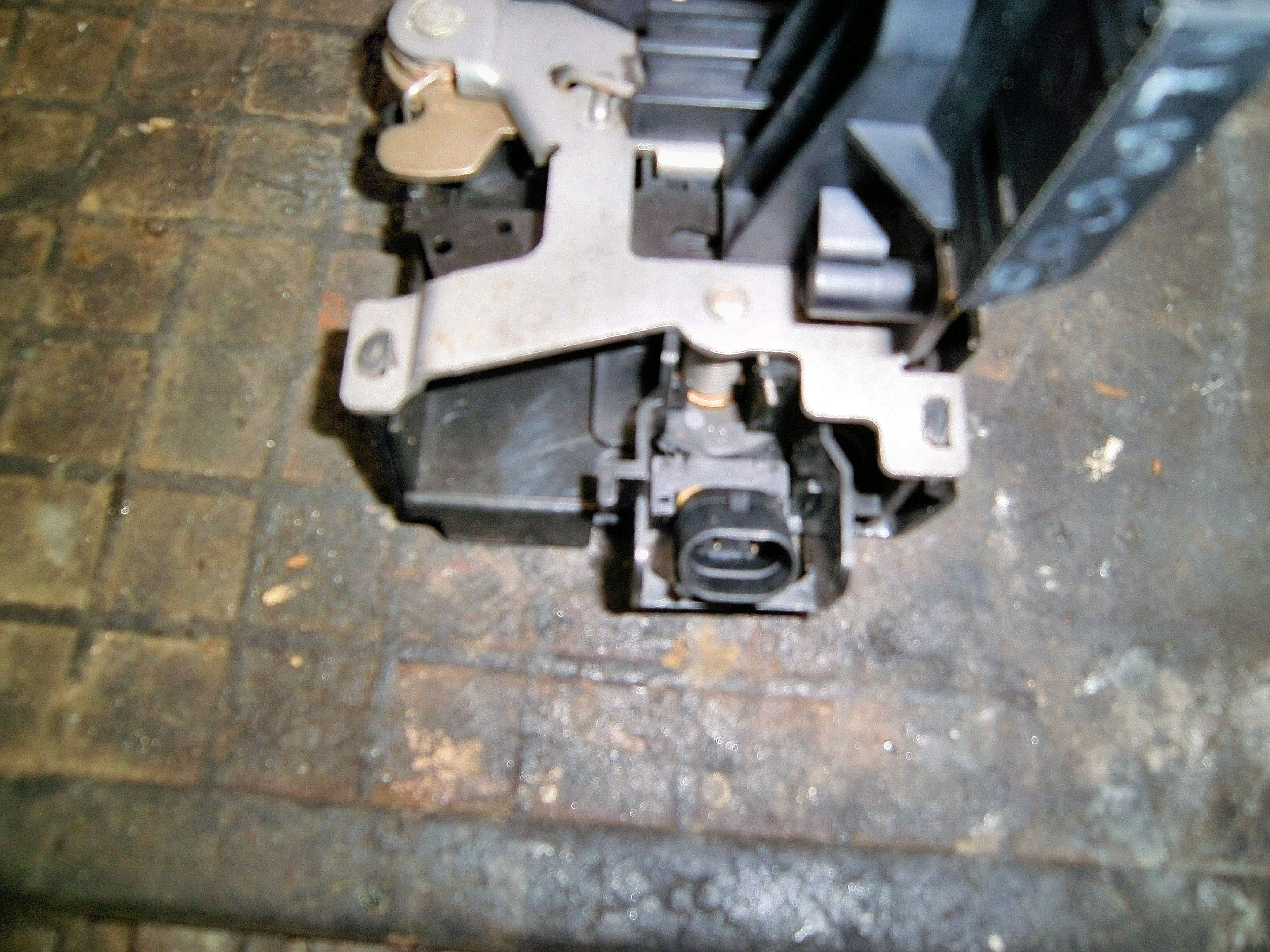

Be careful when buying a secondhand one. It may look bright and Shiny on the outside,and mechanically work OK. But be aware the cam which locks onto the door frame pin,and operates the microswitch is plastic covered. After a lot of use the plastic wears away or brakes off.The cam then stops operating the microswitch,which is needed for central  locking,and the Interior light.
You cant see any wear on the plastic covered cam when the lock is fitted to the car.Only by operating the lock manually off the car, and looking closely at the cam,and microswitch can  this fault be seen.In the picture the oblong block is the microswitch,with the shaped cam above it.Sorry the photo is  out of focus,I was still changing  the lock and wanted to finish!!
