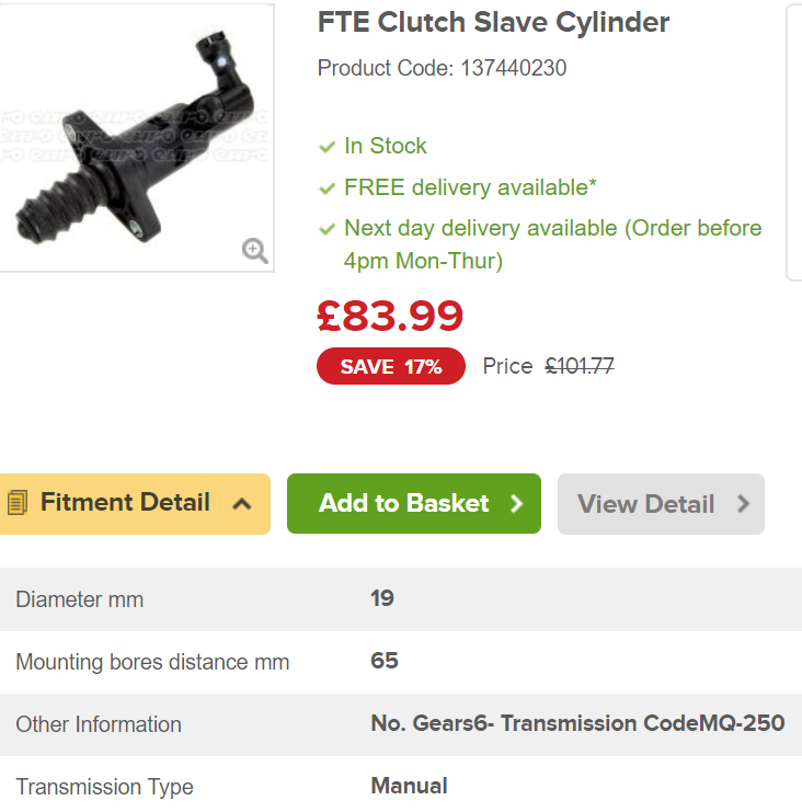

If you want to know what type of cylinder it is, just go onto euro car parts, put in your reg, it'll show you a pic.
Seems mine is concentric (internal).
Seems a stupid design.  I've had to replace a few before, always external though.   They're prone to failure, it's a dynamic seal after all.  Not a problem when it's £40 and is only a 30 mins job.  If it's internal though...  That's just a pain!
