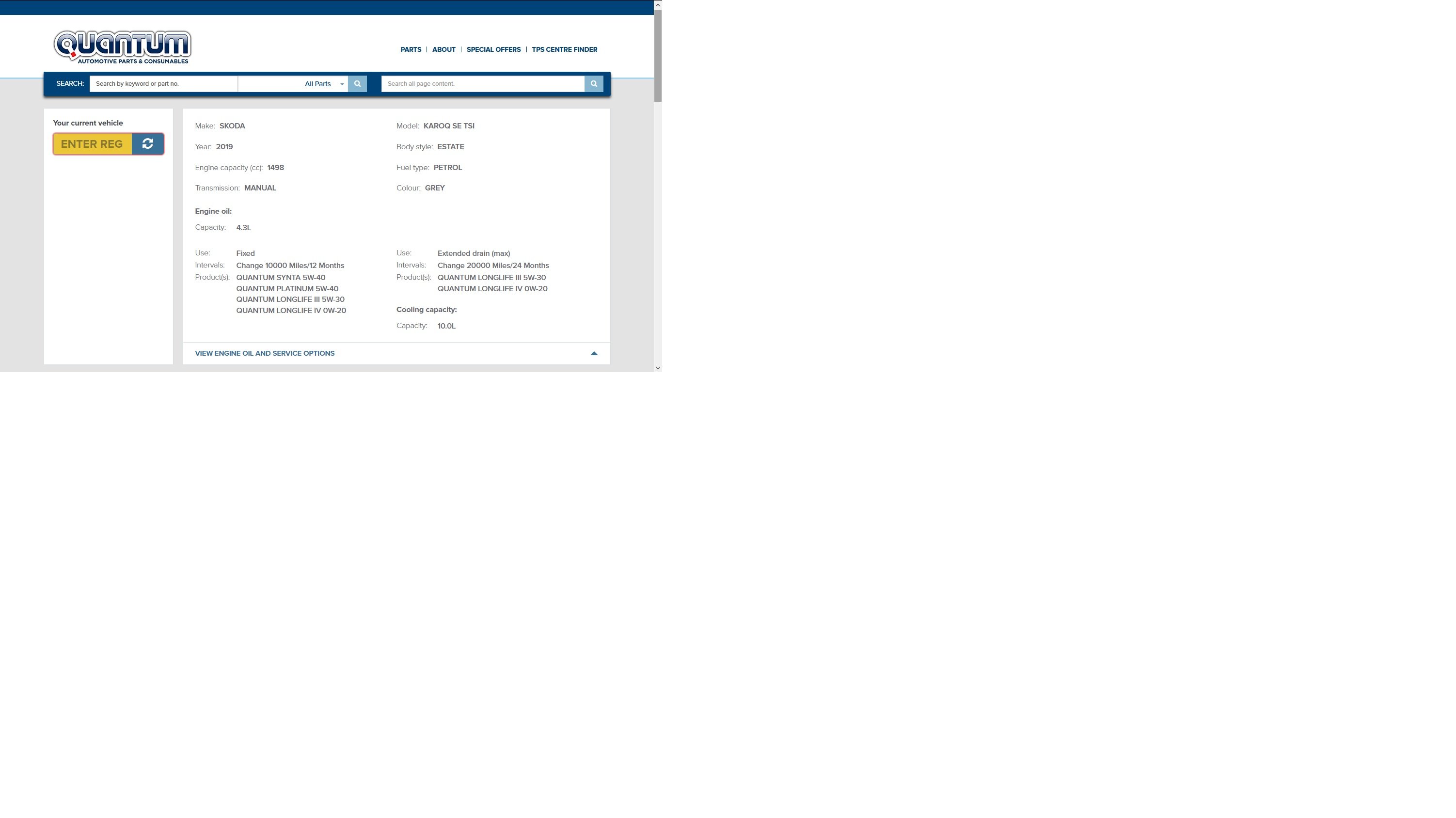

Thanks silver 1011 for that, I had a look at the Quantum website and there is quite a choice of oils depending on fixed or extended service/oil change mileage.
Anyone know if the VW 508 00 spec engine oil is better for the petrol/gasoline particulate filter fitted to MY2019 vehicles?
