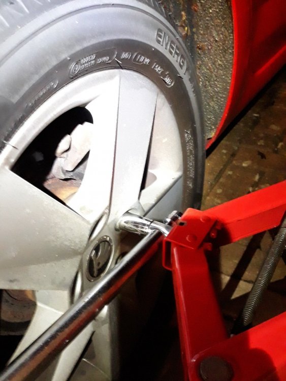

Jammed Wheel Security Bolts
Great improvisation there, I'm impressed

Thanks AG Falco
Love the improvisation, just glad you didn't push the bricks out on the garage.
If you over tighten the wheel nuts either side of the locking nut it helps take the stress off so it is easier to undo. At least you've got it sorted and all those years of watching the A Team weren't a waste of time.
