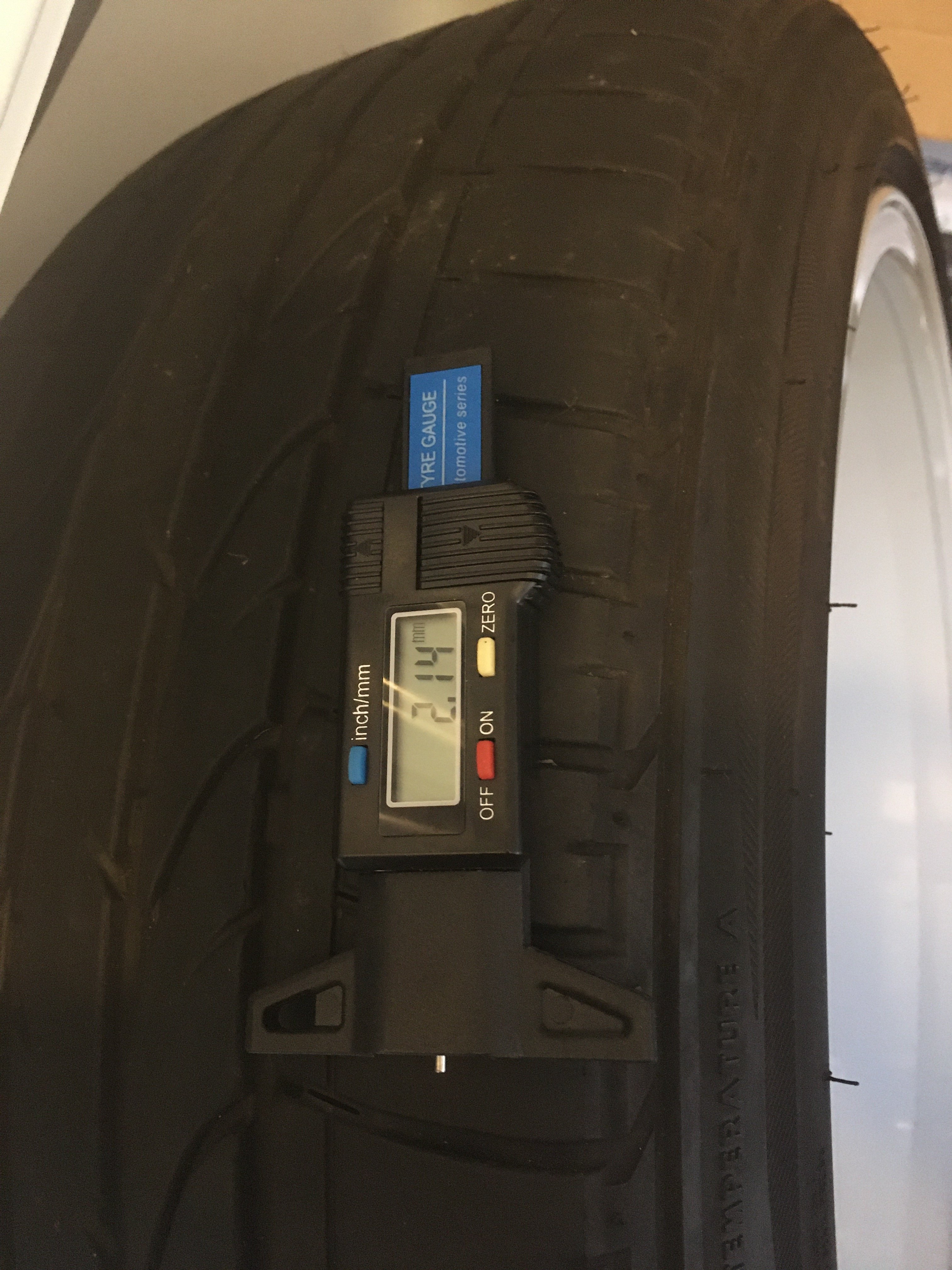

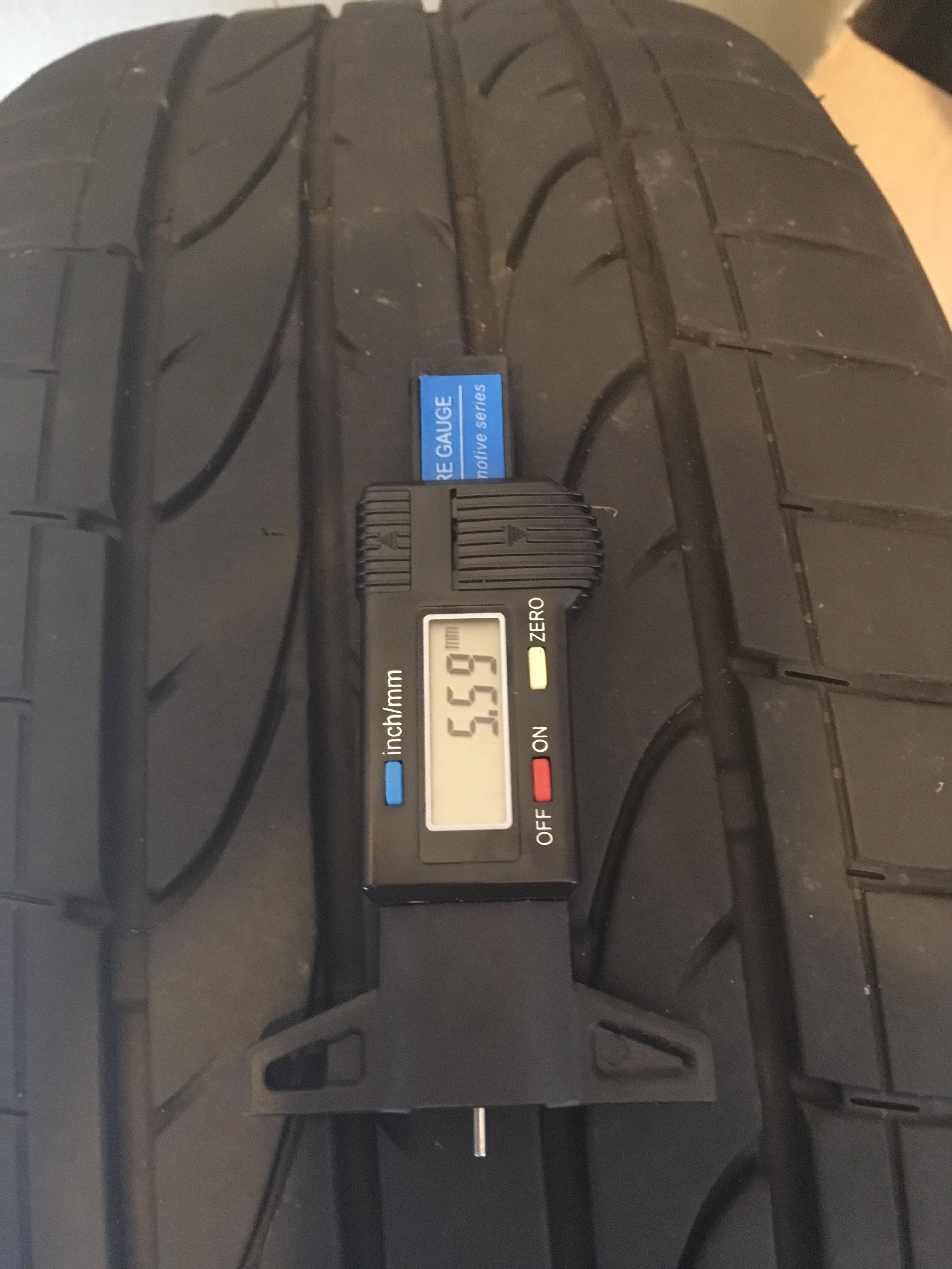

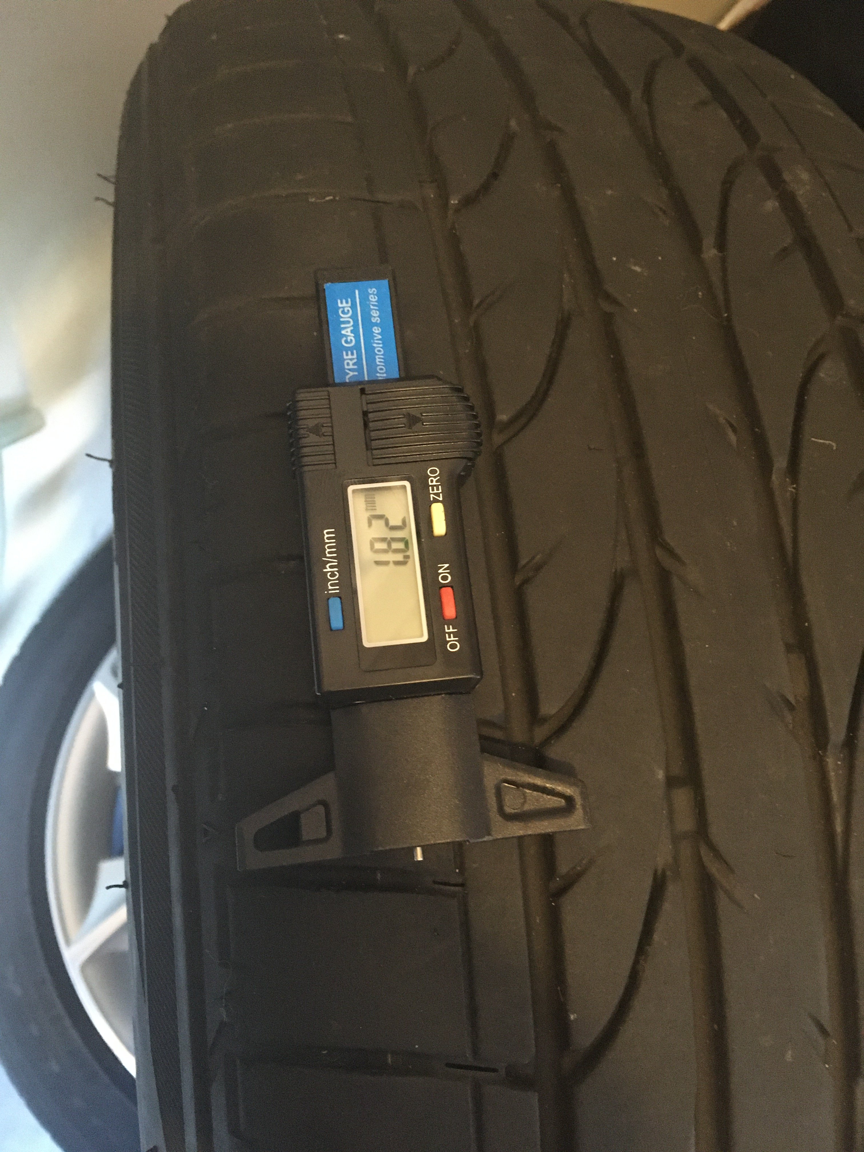

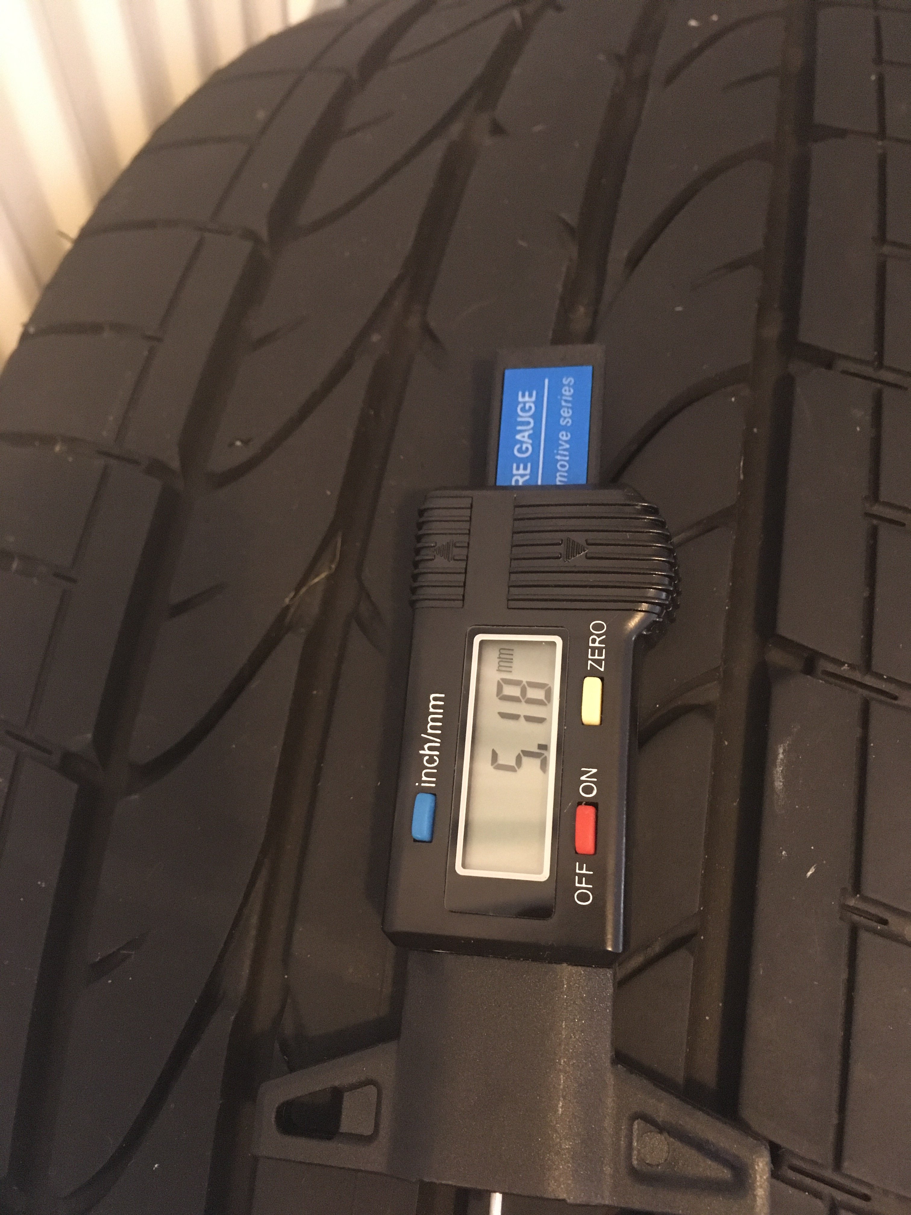

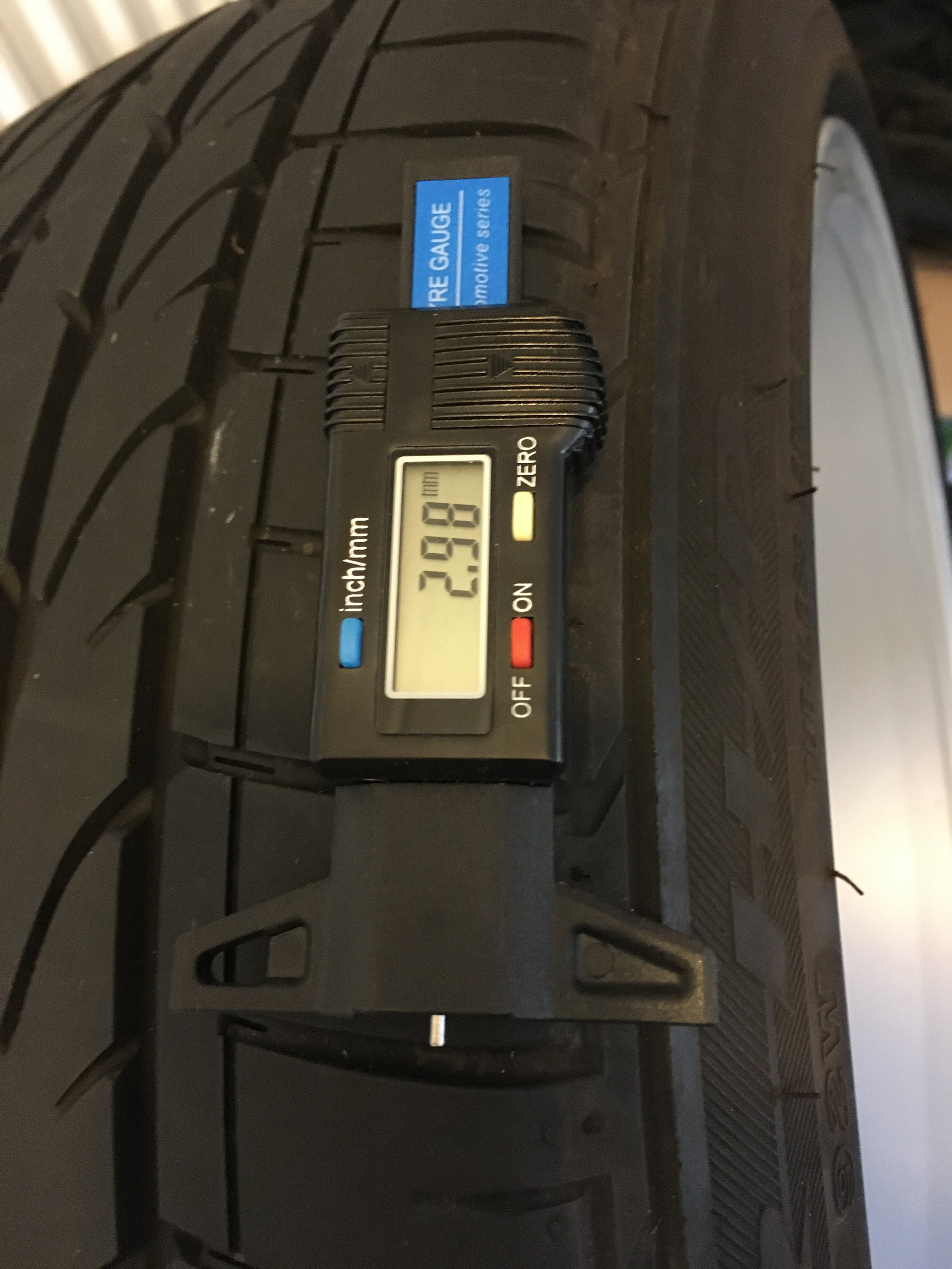

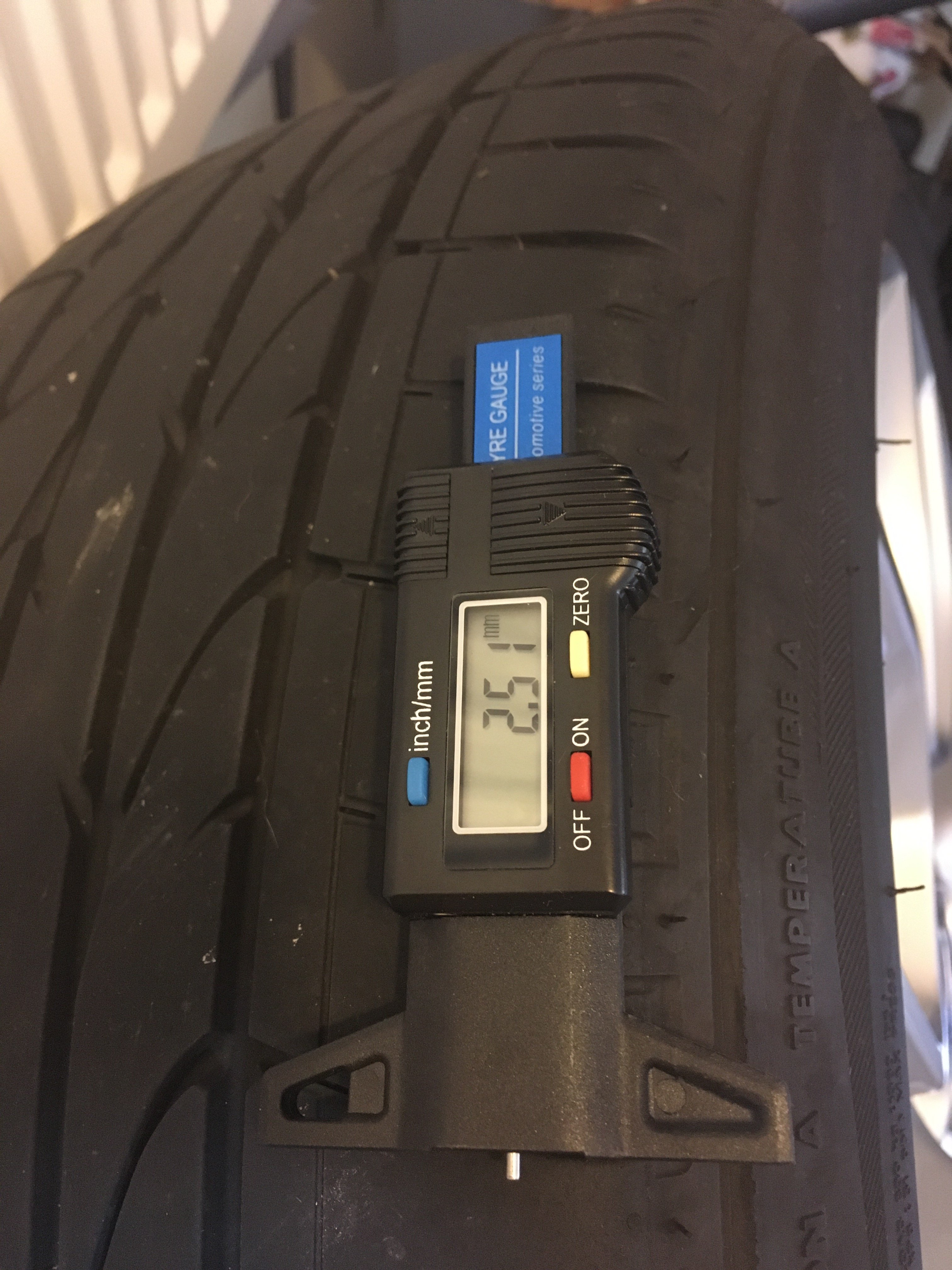

Some Better Photos
I also checked the pressure on these 2 and they were both at 2.58 bar and 2.57 bar.
Outer Measurements are 10mm from where tread should end (approx)
Front Tyres
756281940_FrontCenter.thumb.JPG.8acbba0aba45aa2a0346addfd0f7d24b.JPG1203845345_FrontOuter.thumb.JPG.55050490dbfafc648749a94f716d3649.JPG2092815746_FrontInner.thumb.JPG.5f7dab8514a6afc84fb280fcb59a09d2.JPG

Rear Tyres
1513479844_RearCentre.thumb.JPG.c7bc0a0856aa225a00f37ee72afc224c.JPG1387770419_RearOuter.thumb.JPG.f5701ffb5e822c89856f4f737dfeb26d.JPG612770004_RearInner.thumb.JPG.fbdf02057db7342c1a96564e871a094f.JPG

So you drive in large multi story car parks at all ?
No ....  no Multi Storey...
Definitely got a problem then , have you had tracking checked ?
No - but wearing on inside and outside can not really be tracking... its normally one of the other...
I guess car / tyre combo needs to run at high pressures than recommended...
Will see...
2.6 bar is already a much higher pressure than I run on our Kodiaq without any issue. 19” wheels on ours, and it’s a pretty heavy car (190 diesel, DSG, 4x4, pano roof, usually driven fully laden).
Are you checking cold or hot ?
Me - cold..
So will be running even higher pressure so somethings not right

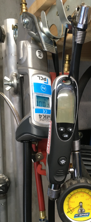

Stupid question but have you checked with a different gauge incase faulty
I have a Digital gauge on my Inflator and a digital gauge that I check with - read same pressure
Plus I use same 2 tools on my motorbikes and there - I have digital sensors and read out also on each wheel also - and they all tie up within 0.1 bar (1.4 PSI)
So fairly sure all is OK - as 4 different things read the same..
The gauge and inflator.
Edited by SimonAudi
Very strange maybe a trip to the dealership never seen it before apart from track days
