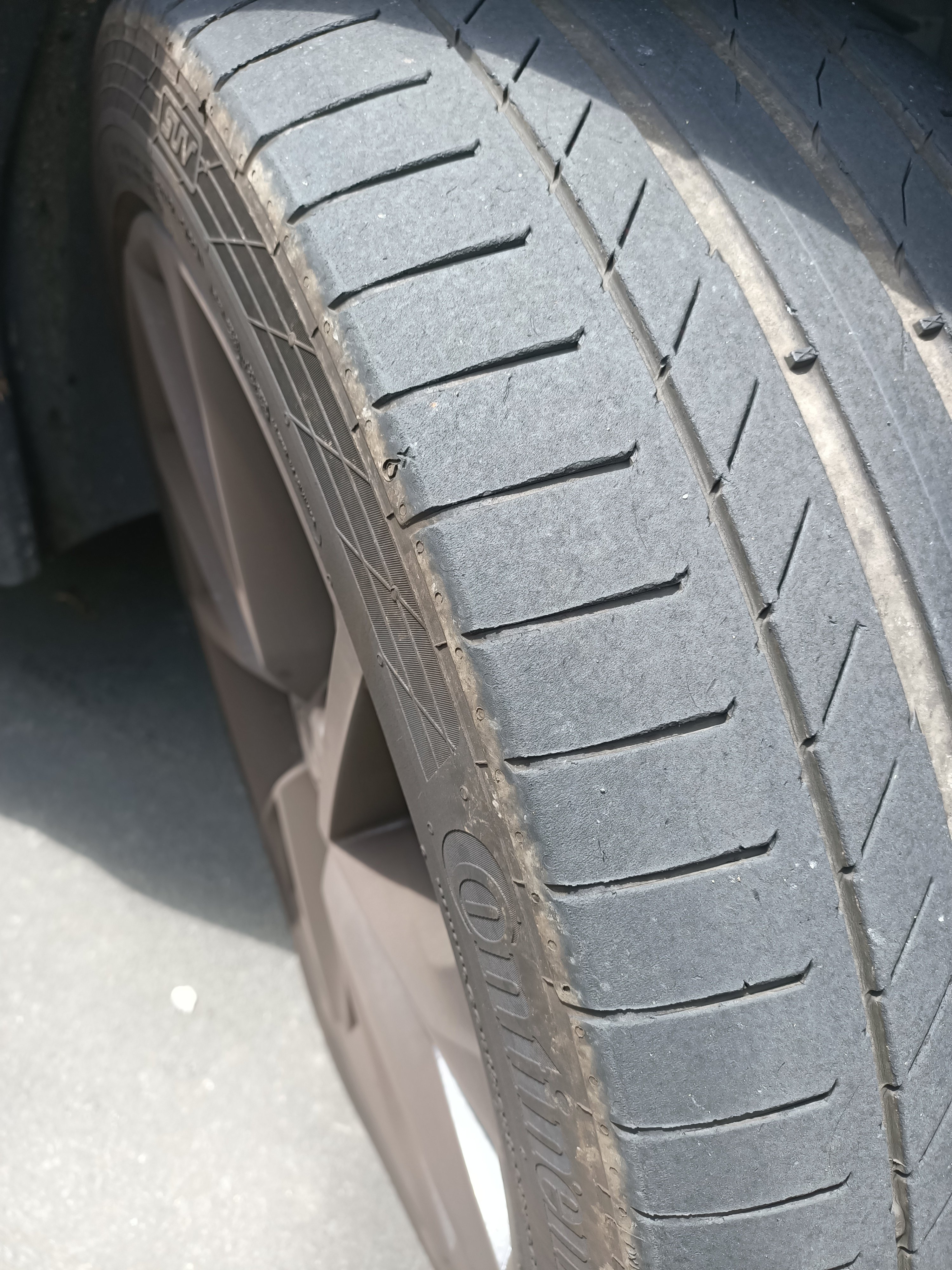

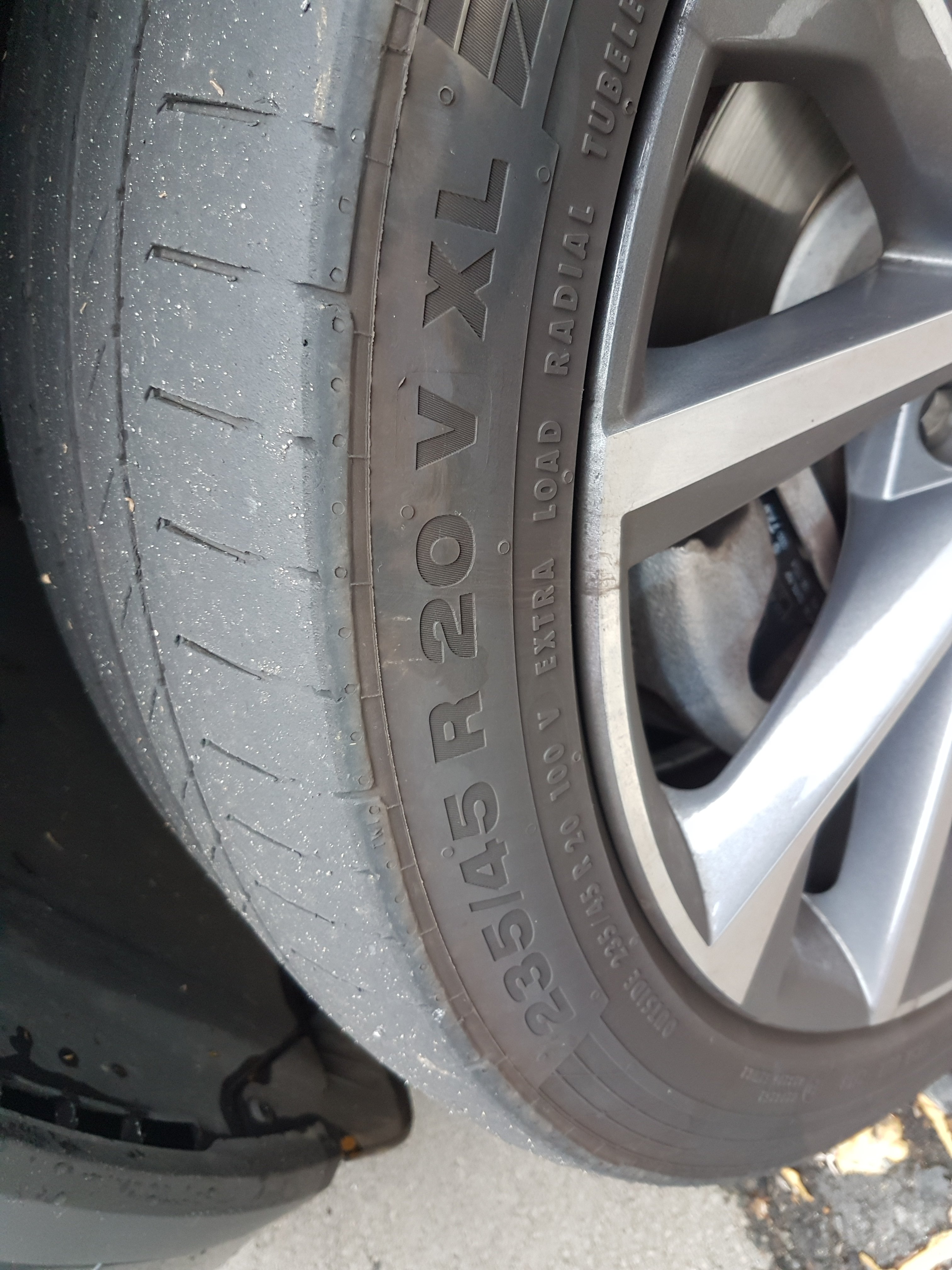

Our wheels are Sportline 20", standard in New Zealand on this model. Attached a picture of front tyre, both are similar, outer tread almost gone, uniform wear on centres.
Same wheels & tyres on mine... done just over 30,000km & mine are getting close to where I'd swap front to back... not as worn as yours on the outer edges for sure.

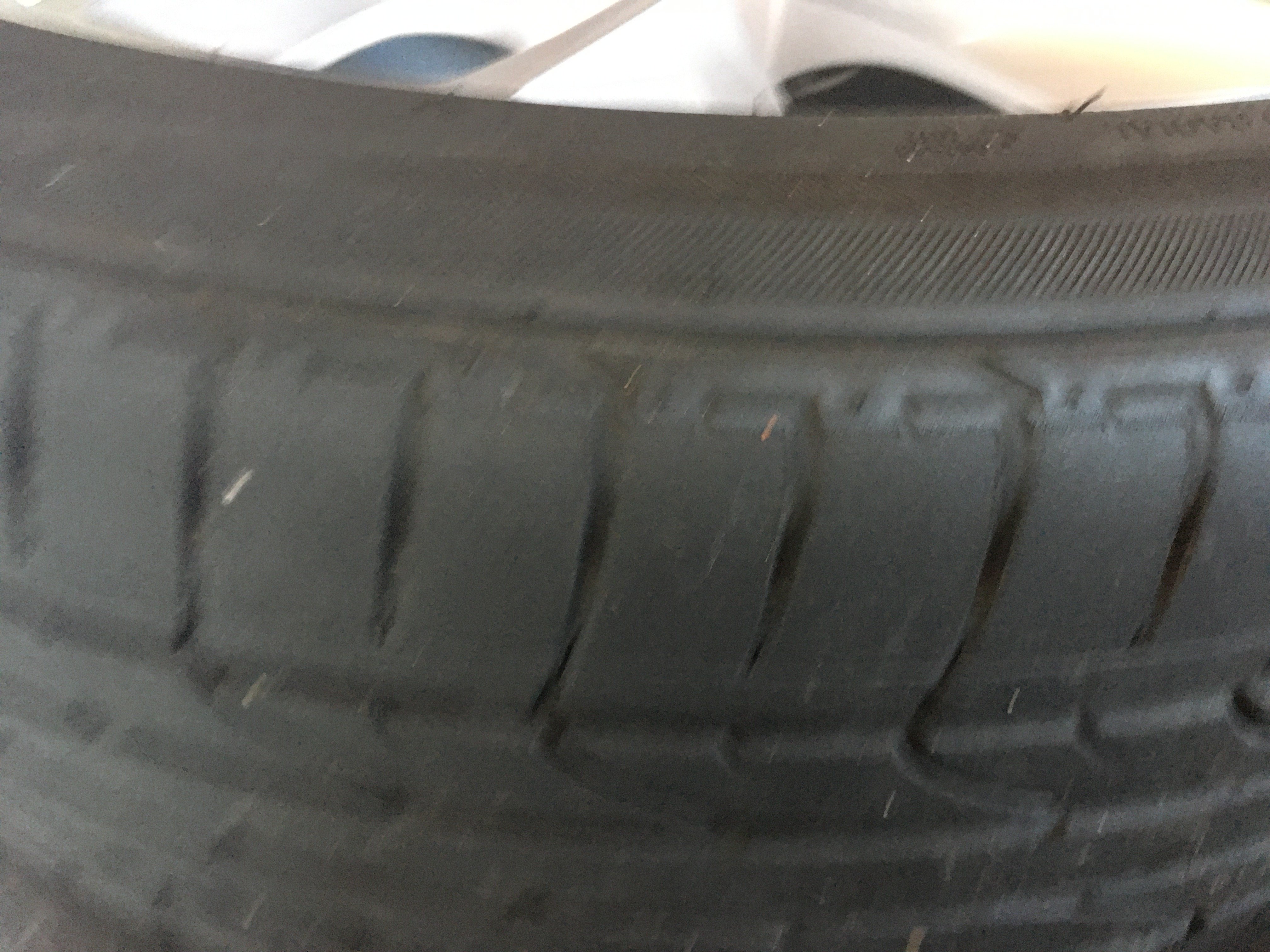

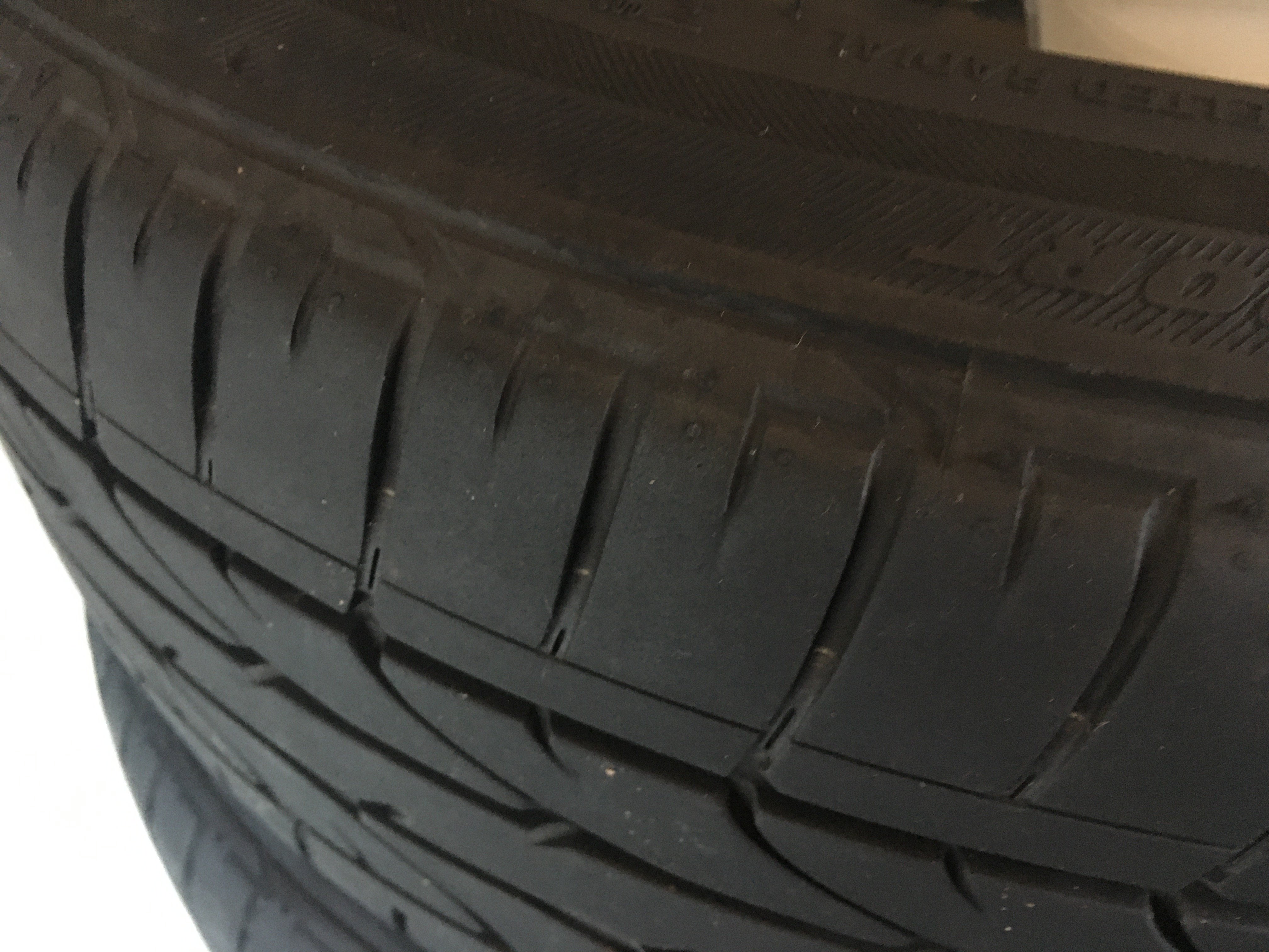

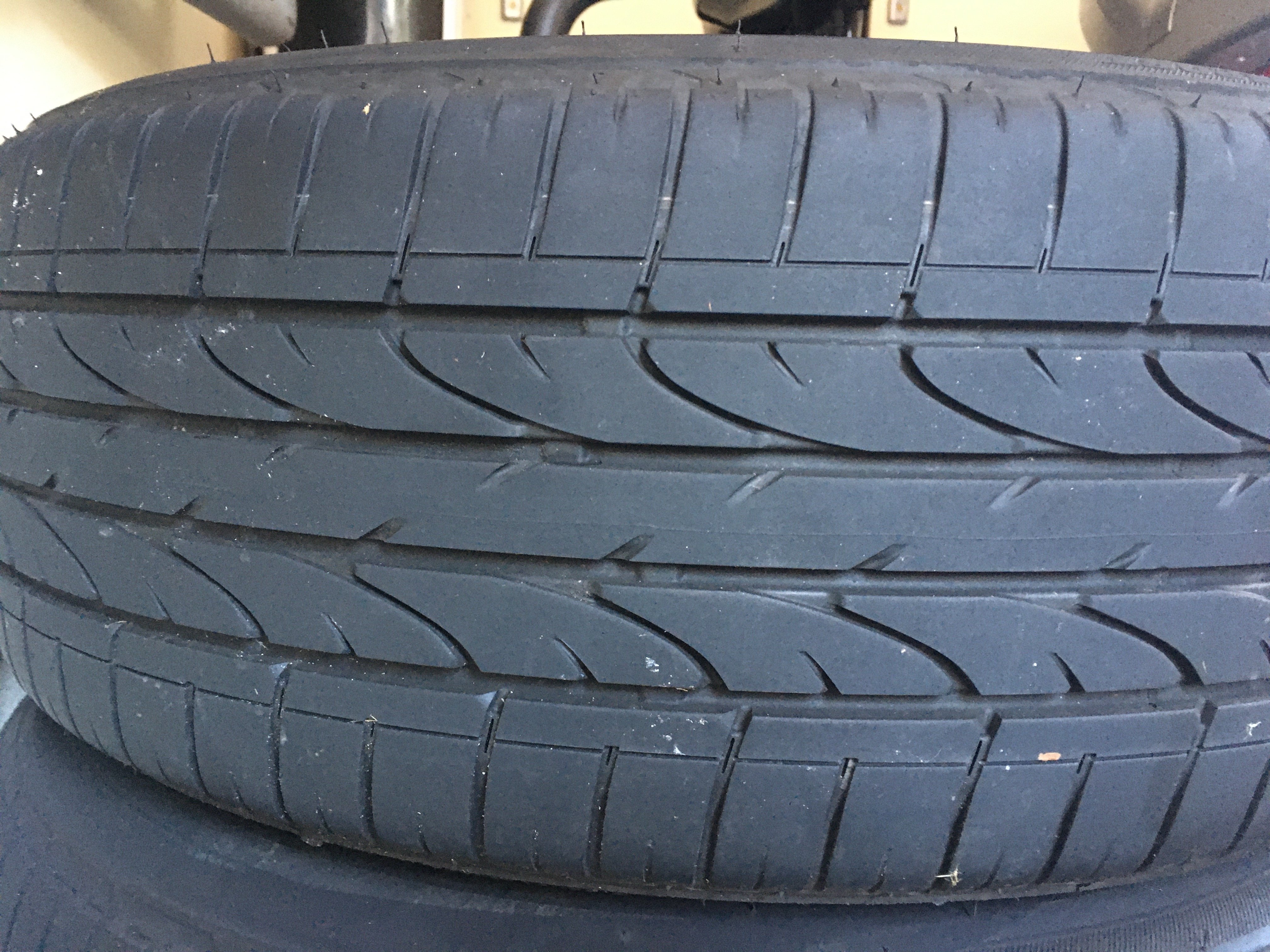

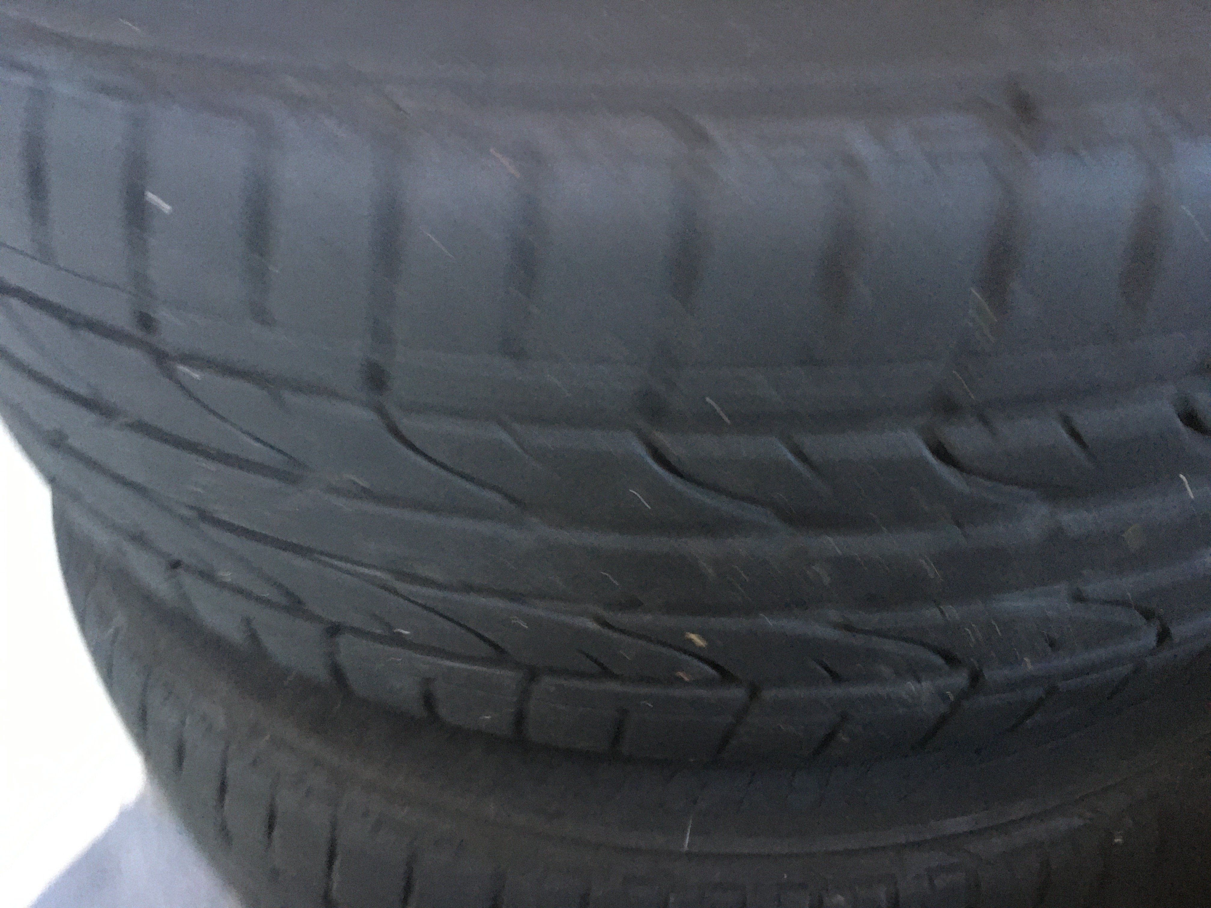

Off the wifes Karoq - 4x4 2.0 TDi - 4100 miles - mainly urban
I assume you missed off a zero?
It is difficult to tell from the pictures, did you sneeze!? Are these worn or not?
Hi
I am afraid I did not miss off a Zero..
Front tyres are around 5mm left in centre and 2 to 2.5mm left at edges - almost nothing at very edge..
Rear 5mm in centre rear and 3mm at edges.
