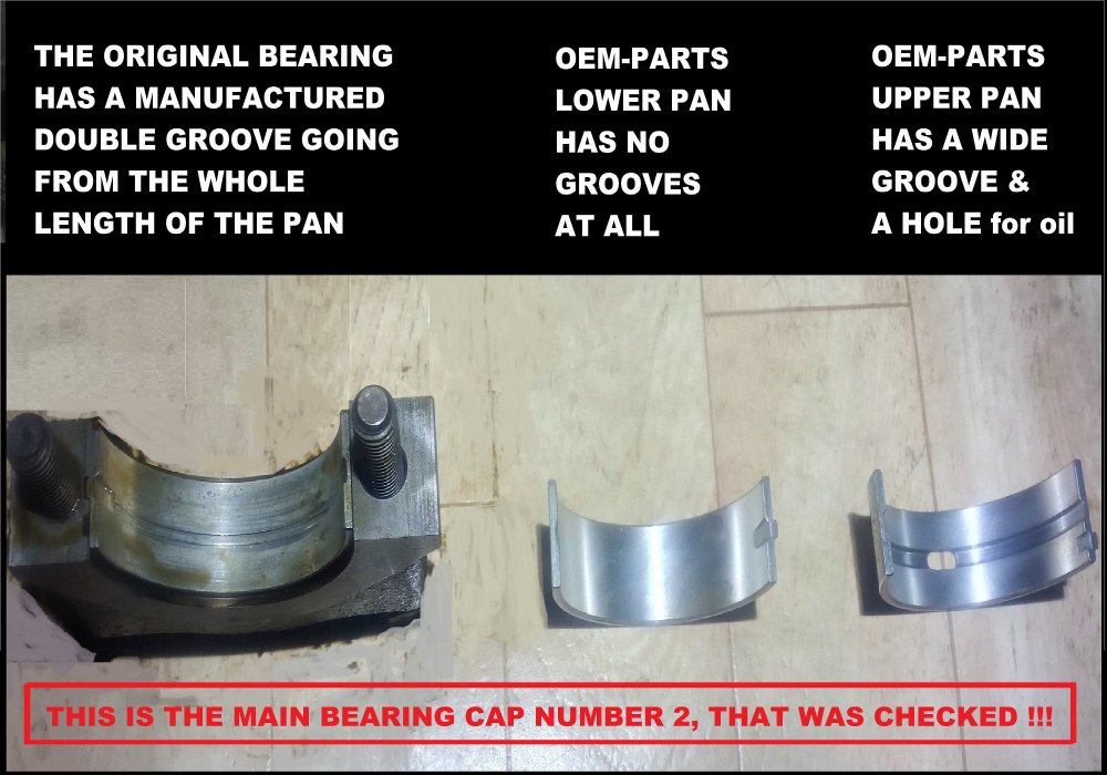

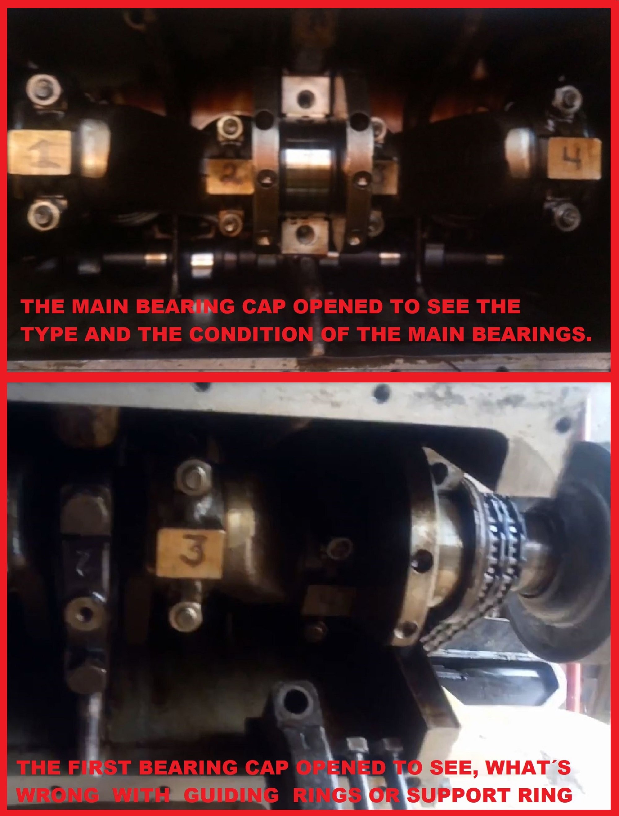

Of course I touched the main bearings! First I removed the 2nd bearing cap (the central) to see the condition of the old bearing. Found it ok, so I torqued it back to 75 Nm.
And then, trying to find out, what might be wrong with those two guiding rings, I opened the first main bearing cap and torqued it back to 75. It should not move the whole crankshaft anywhere.

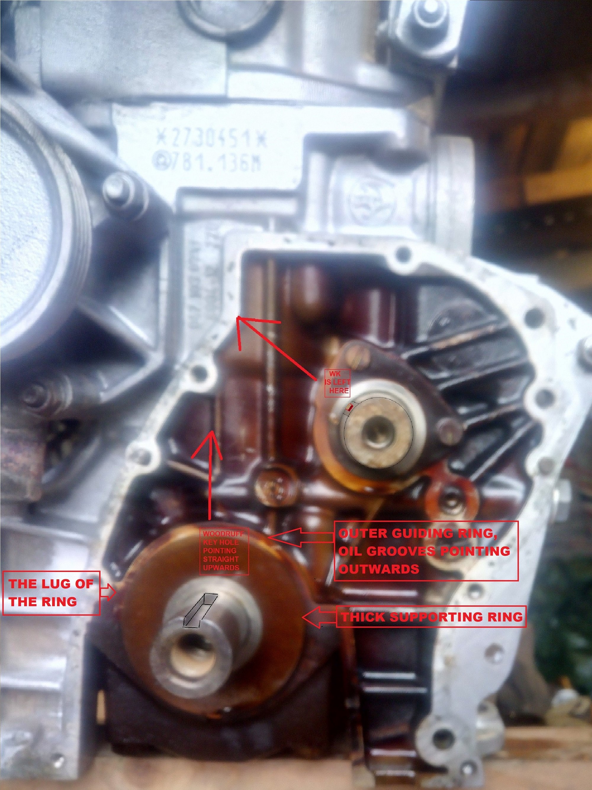

Now, only clear problem that I have found in my "private investigations" is, that the both guiding rings around the main bearing number 1 seem to have a lot of play in the direction of the crankshaft diameter, not axial play.
And that play seems to have caused some trouble, especially with the inner guiding ring, so that it did not fit well automatically despite the fact that the lug was opposite the slot.
In the beginning I thought that it would be enough if I get the lug opposite the slot. But now I have found out, that, because of that diameter directional play I have to be very careful to get that ring well positioned.
Can´t explain it better, but right now I am going to meet my engine. And trying to check that inner ring as well as possible. And if there are some kind of cracks or damages in it, I´ll try to grind them away with P800 water sanding.
That is all I can say now. Some pics about the objects.

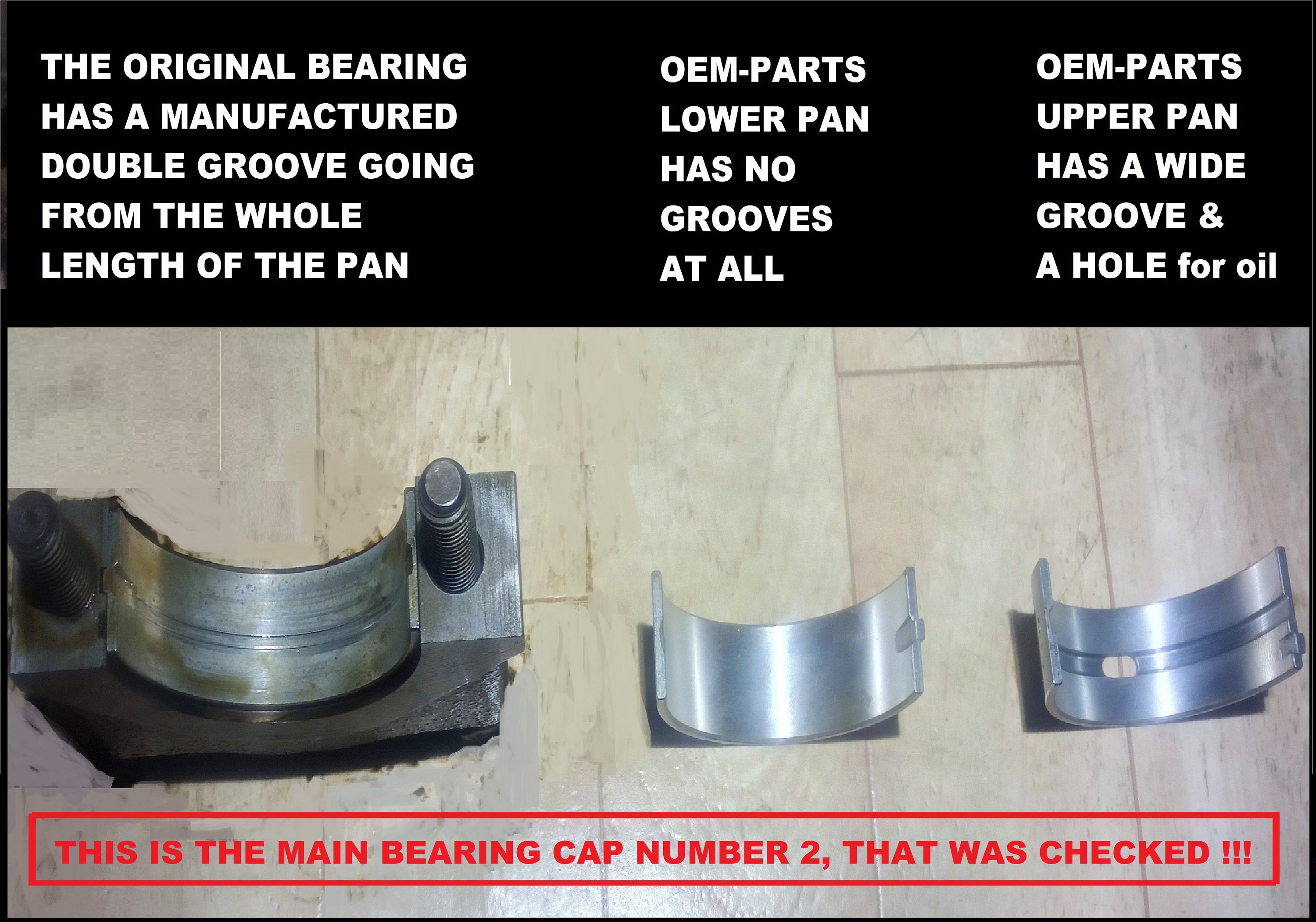

On the previous page I mentioned several times in several comments, that I checked the main bearing number 2 to see the condition of the cap side (lower) bearing.
While the two other main bearings were on their places with right tightness, I still can´t  understand,  what could change the axial play, as the same cap with the same bearing was put back to its original place.
I attach here the photo from page three.

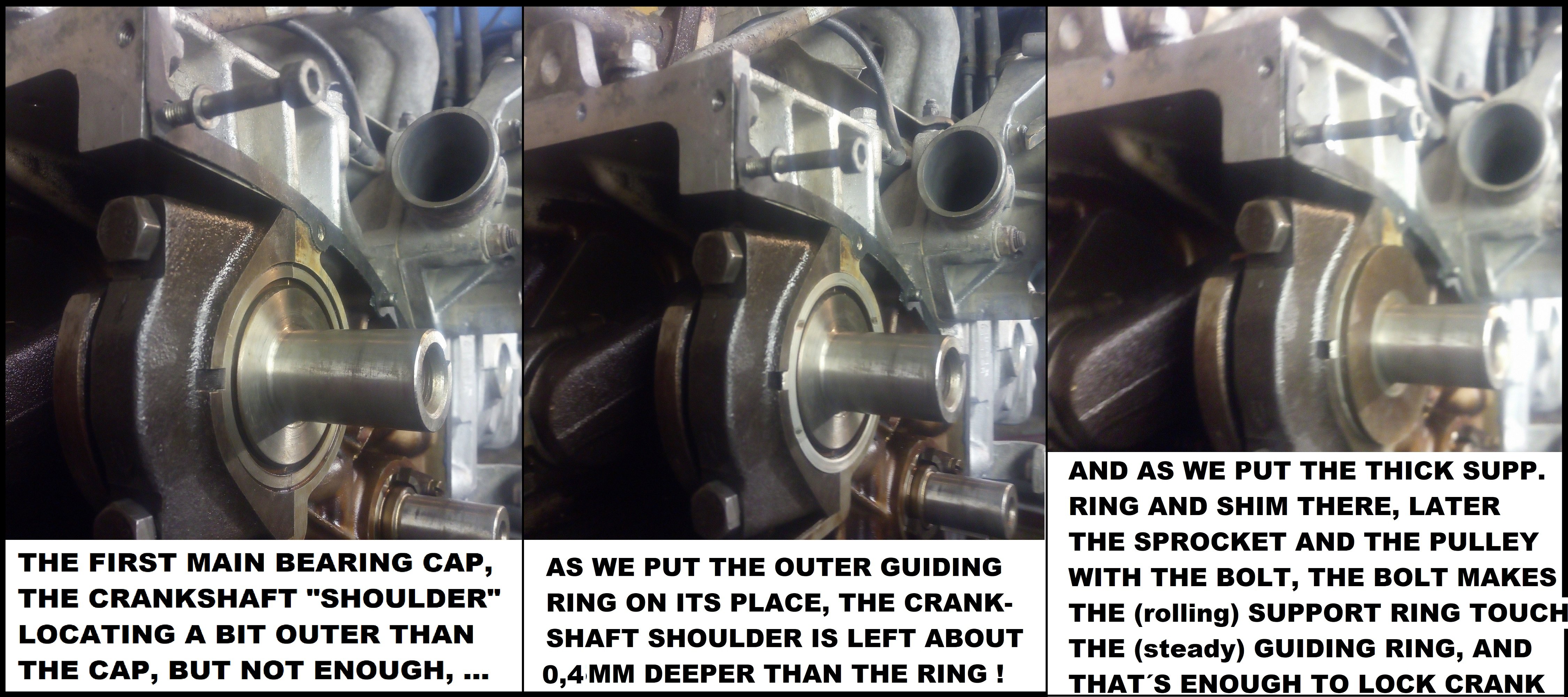

But something has happened with the crankshaft´s position, however, cause my friend found out that the locking of the crankshaft is obvious to be due the thing that happens  in the right end of the crankshaft.
And describing it without illustration is difficult, but I try: Because the shoulder of the crankshaft is now located about 500 micrometers too deep, tightening the pulley causes that the thick supporting ring (that should roll) goes against the stable outer guiding ring (that does not roll) and not against the crankshafts shoulder, that is a rolling part. And that seems to be the first reason for the locking. If it were passed, there might occur also that phenomenon of crankshaft rubbing against the bearing with the smallest play.
This problem with the thick support ring tightening against the guiding ring was so simple, that it never crossed my mind, because I couldn´t understand that in general nothing would have changed in the location of the crankshaft.
Must say that I am still quite blown away with both theories, though I´ve at least seen the simple case that my friend noticed, and understand something about your theory of the lack of the axial play (it is not visible, I mean, with my eyes I see that there are little gaps on both sides of the main bearings, except near the flywheel, I can´t see it)
And that means: I removed the cap of the 2nd main bearing to see the wear surface of the lower bearing while it was all the time in the capI touched it (with oily fingers) but I did not remove it from the cap. And the upper bearing I did not touch at all, I did not move it from its position. And the cap was installed the right way, not the opposite. So, what could go wrong? 🙄

The easiest way to get rid of that locking situation would be some kind of washer above the crankshaft shoulder. But as there was no washer in the beginning, as I opened the timing cover, the problem should be solved the other way, if possible.
I had the same issue when I changed my timing chain. You don't need to place a washer there. All you need to do is to put oil on those surfaces as you assemble the engine. Afterwards when you tighten the bolt, the engine should move a bit more freely.
