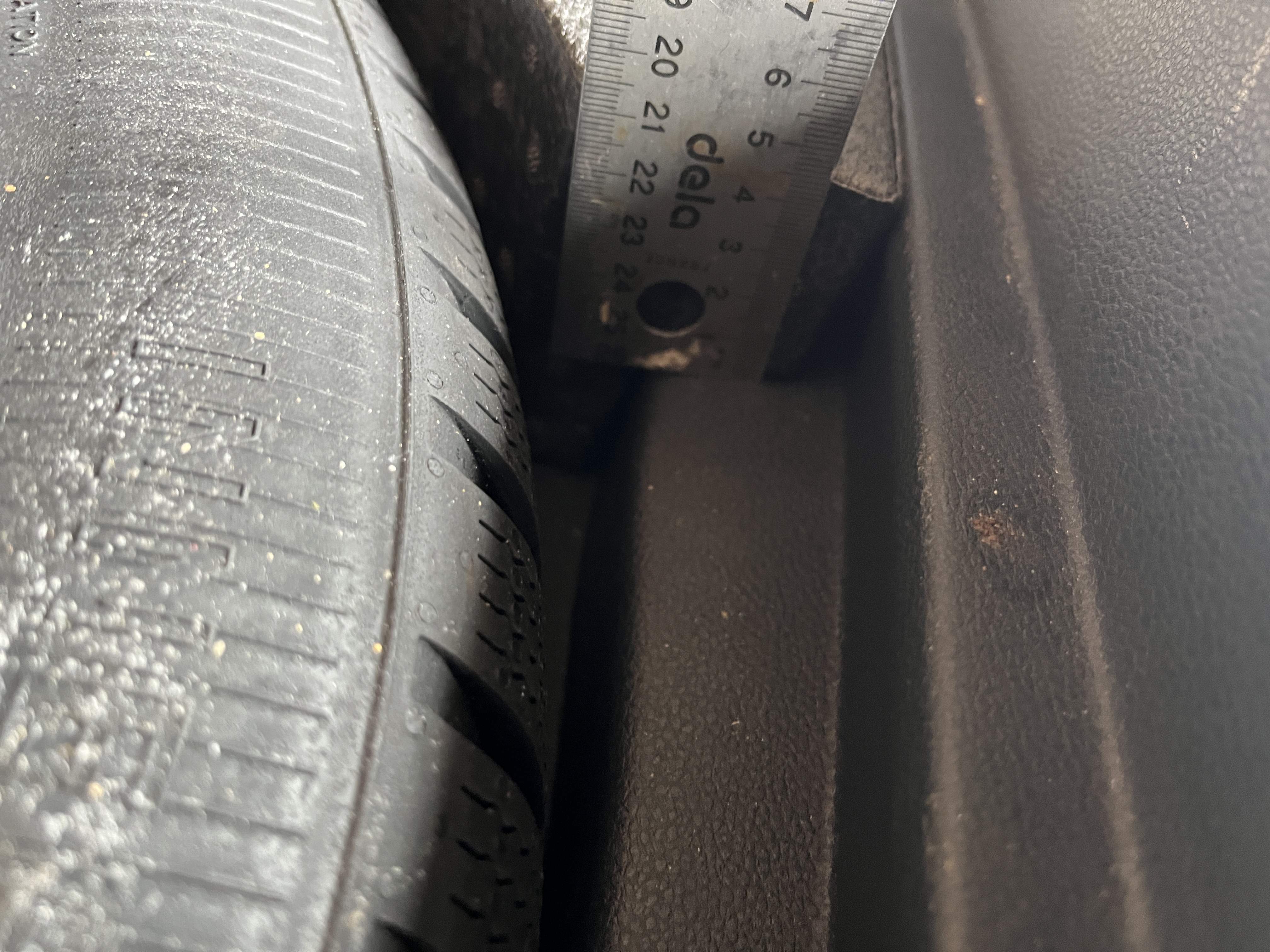

Karoq SEL 1.5 TSI 2WD 18" Brag?/Miran? 30th Dec 2022
 Mark-Surrey certainly started something here!.
The tyre on my 125/70 R18 tyre sits exactly flush with the boot floor.
A 215 full size tyre is going to sit 90mm +/- higher in my car.
The new boot floor in Mark's 560A kit has spacers under each corner that look to be about 1cm.
Maybe the well in the 2019 Karoq was deeper than the 2022 facelift.
On a favourable day I shall follow Carlston's advice and try one of my road wheels in the spare wheel space.
In the meantime I asked what would be involved at my dealership.
This is their breakdown:

The parts superviser says he is not 100% certain this kit would do the job and adds that the wheel is shown as "back order".
It would be interesting to see how the 560 2WD kit differs from the 560A 4wd kit.
I shall bide my time until I have tried a full size test but I suspect thr height differece will be too much for my purposes.

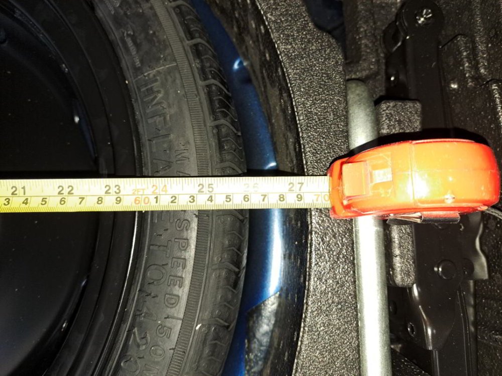

You measure the outside diameter of the tyre when it's inflated and off the car, ie. without the weight of the vehicle on the tyre.
It's more accurate to put a tape measure around the inflated tyre when its off the vehicle to measure the outside circumference, and then divide by 3.142 to calculate the diameter from the circumference, ie. diameter = circumference / 3.142
Even if your 225/45R19 tyre turns out to be about 675mm rather than the calculated 685.1mm, 675mm is actually even closer to the outside diameter of the 135/80R18 space saver tyre so it wouldn't be a problem at all.

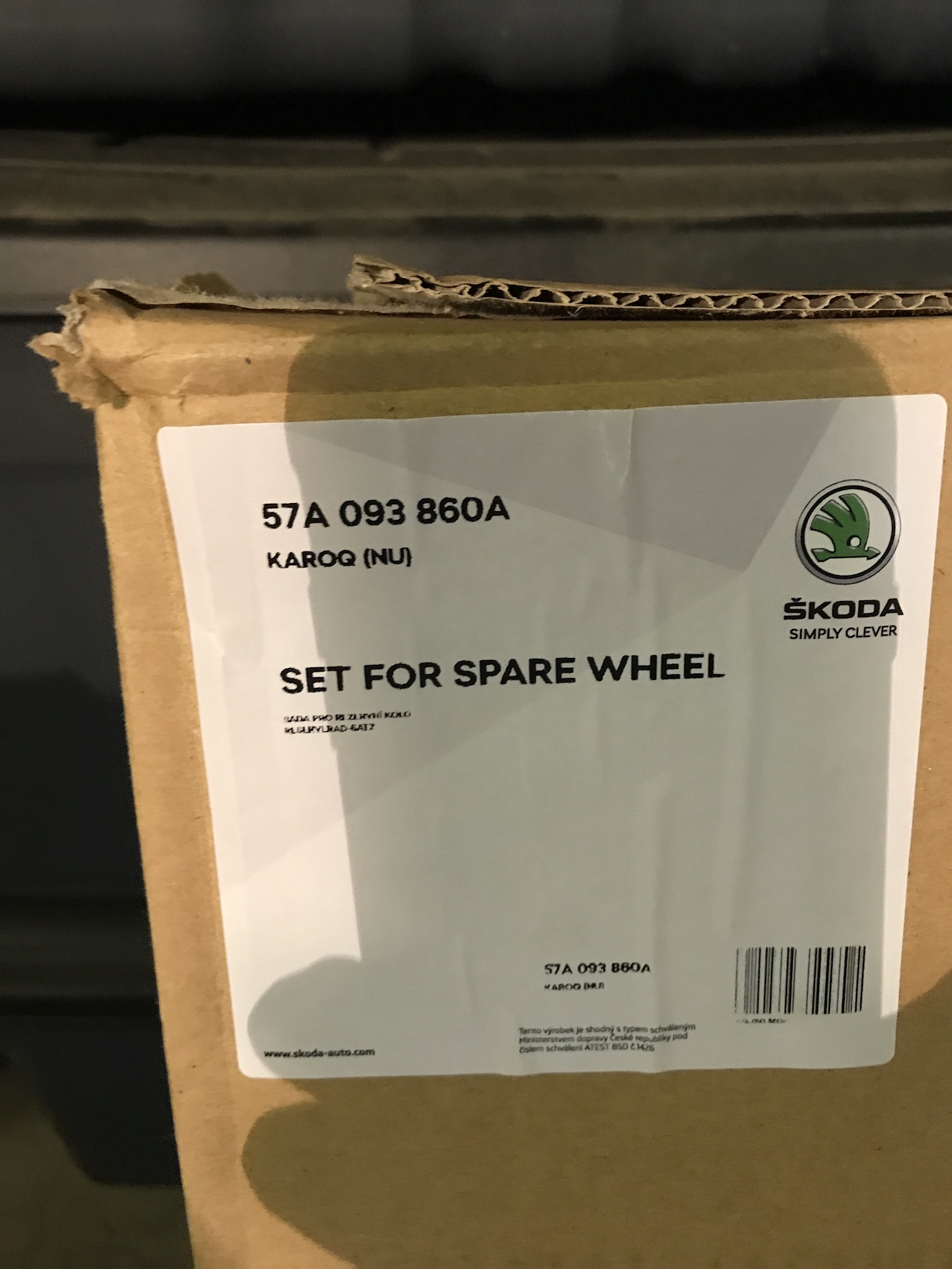

My apologies for quoting abreviated - and incorrect - kit numbers in my comments earlier.
here is the "...860A" Data Sheet I failed to insert before.

I’ve added some photos below to show how the boot floor level rises up with the kit for a full-sized spare wheel. It’s not just the wheel itself which supports the boot floor. The polystyrene inserts are higher for the full-sized spare, and the boot floor rests on a plastic ledge which is about 4.5cm higher than the plastic ledge for the space-saver floor

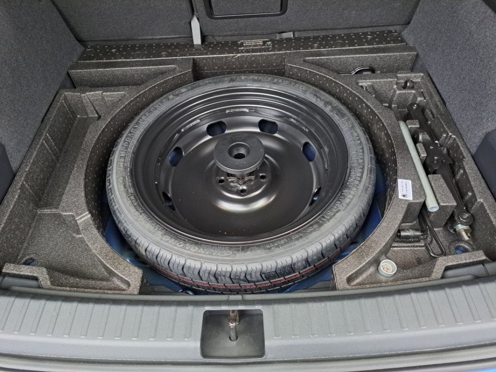

As promised, here are some pics of the space-saver wheel kit as installed in my 4 x 4. Interesting contrast to Mark-Surrey's pics with a full size spare - ie about same boot floor height.
There's plenty of room for the space-saver supplied. As the third photo shows, a max wheel diamter of 685 mm could be accommodated.
Hope this is of use to someone. The previous posts were a great help to me.

From the photos, it looks like there's enough room to change the 125/70R18 space saver tyre to a 135/80R18 space saver tyre on the 3.5Jx18 ET25.5 5/112 57.1 steel space saver rim.
This would bring the outside diameter of the space saver tyre to closely match the outside diameter of the standard Karoq 4WD tyres, such as 225/60R16, 225/55R17, 225/50R18, 225/45R19, etc.
https://www.camskill.co.uk/m129b0s7672p0/Temporary_Spare_Tyres_-_Space_Saver_Tyres_-_18_inch_R18_inch_-_135_80_18_135_80R18_R18_inch_-_135_18_135R18
As you can see in the ETRTO chart below, a 3.5J rim width is ideal for both the 125/70R18 and 135/80R18 space saver tyres.
ETRTO approved rim widths
125/70 3.0-3.5-4.0
135/80 3.5-3.5-4.5
You might expect a 135/80R18 tyre to be 10mm wider than a 125/70R18, but when they are both fitted to a 3.5J rim, the 135/80R18 is only about 7mm wider than the 125/70R18.
Edited by Carlston

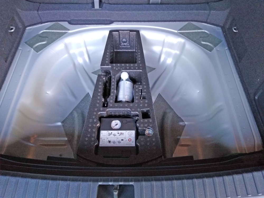

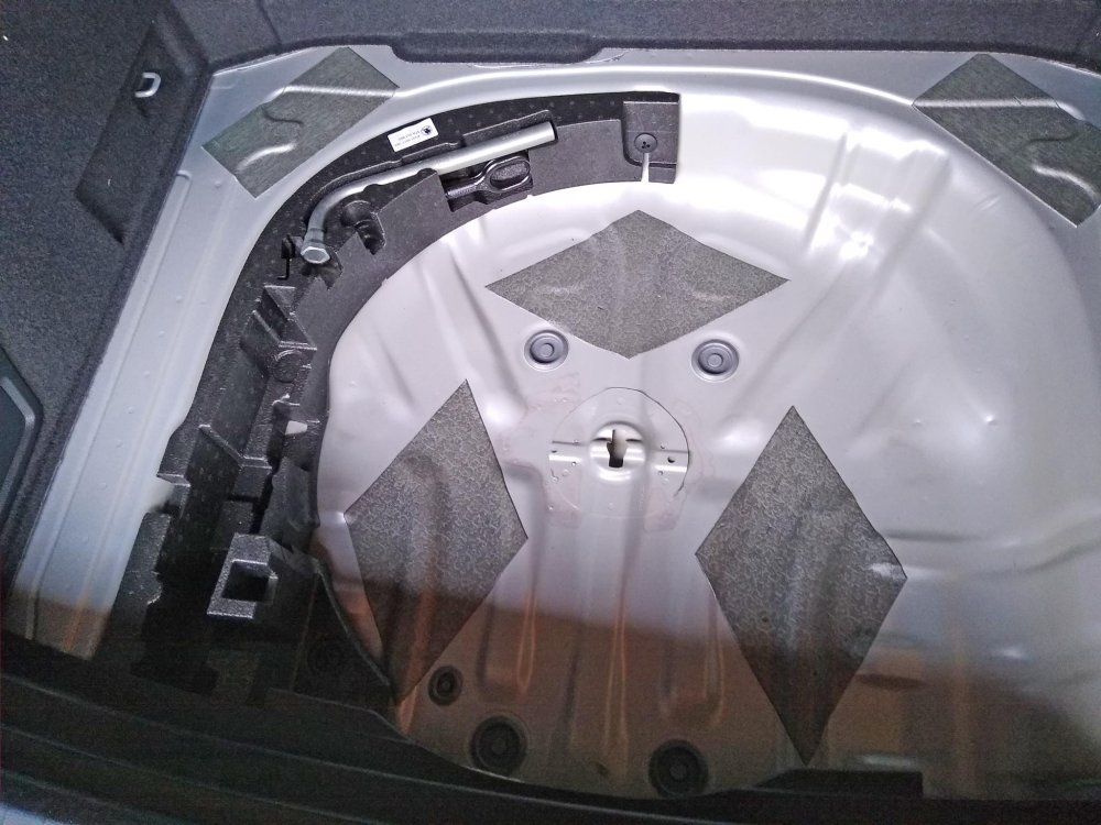

An update on progress on my 2wd Karoq. I bought the polystyrene foam insert and tools kit and installed them without problem -see photos before and after. I then removed one of the road wheels to see if it would fit in the wheel well in the boot - it didn't as the diameter is greater than the space available.
The other important thing, for me, is that the 17" wheel and tyre is very heavy. I am not a big burly bloke and I struggled to lift it into the boot for the size test. It was even worse when refitting the wheel and it took me ages to get it in exactly the right position for the bolts to bite. It would be a total nightmare to change a wheel by the roadside in daylight, let alone at night.....
This is leading to me thinking that the best option would be to buy a space-saver tyre and wheel as a) it would fit in the boot well properly and b) should be a bit easier to change a wheel if the need ever arises. I just need to know the correct size - is it 125/70 D17 ?
Any other thoughts before I go any further?
Thanks for all the help so far.

With the 2WD Karoq, the 125/70R18 space saver is fine. The 135/80R18 probably won't fit inside the Karoq 2WD foam, although it should fit inside the Karoq 4WD foam. The Karoq 4WD foam will fit a Karoq 2WD as well as a Karoq 4WD.
It's really only the 4WD Karoq that might be better off with the bigger 135/80R18 mainly due to its 4 wheel drive system. This is because it's probably not such a good idea to use a much smaller outside diameter tyre on one of the tyres.
Where are you going to put your full size wheel if you get a puncture, as you said it won't fit inside the Karoq 2WD foam?

I found a new unwanted, new, unused kit on ebay 57A 093 860A.  According to manual supplied this is intended for a 4x4 with fixed seats (NOT VARIO)
Fitted the kit last week without any issues, apart from trimming the polystyrene end piece as detailed by Mark Surrey. (Thanks Mark)

I have tracked down a suitable space-saver wheel/tyre (125/70R18 5x112) on ebay and it should arrive next week. I have also ordered one of those wheel alignment guide tools - I have never come across such a thing before and it is just what I need - every car should have one!
Regarding where to put a full size wheel in the event of a puncture, our car is rarely used with more than two people in it so I would just put it in the boot. I always carry a strong plastic groundsheet in the car so would wrap it in that to keep the boot clean.
I will provide a further update after installation of the space-saver.

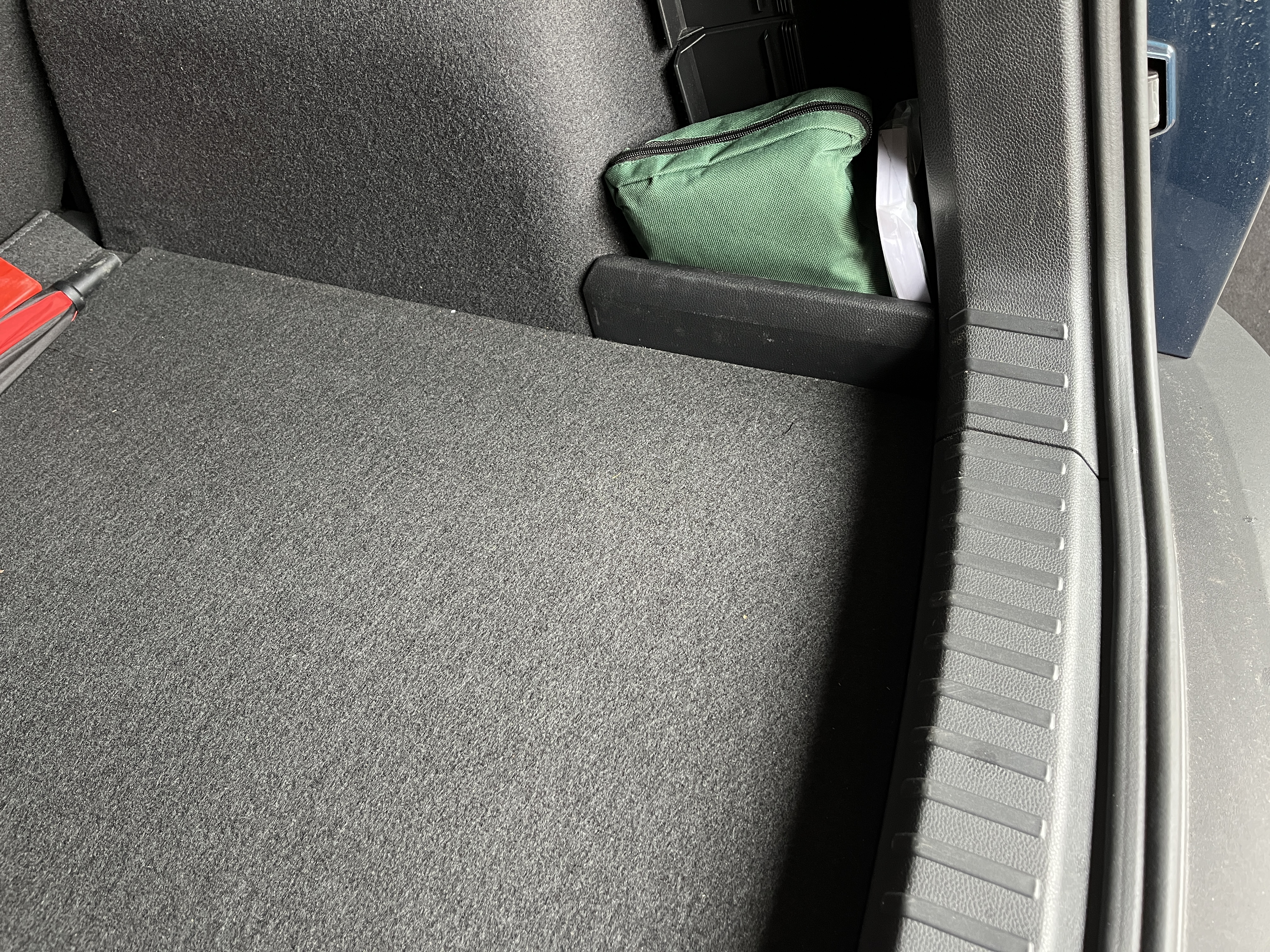

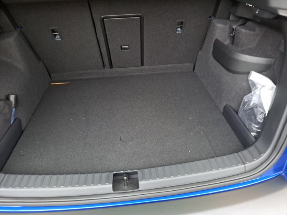

Project update - now complete.
In addition to the spacesaver wheel & tyre, I also bought a plastic tray off eBay (described as "tailored heavy duty boot floor liner mat") to provide a hidden compartment. It is arranged as follows: wheel well covered by the loose double-sided rigid mat that came with the car, then the plastic tray and finally the original boot floor - see photos. Given that the plastic tray is not very strong, I may need to put some blocks of wood in it whenever we carry something really heavy in the boot - suitcases etc.
It's a pity that the Karoq doesn't come with a variable boot floor as standard as retrofitting appears to be expensive judging by the Kamiq thread on the subject.
Many thanks to all who contributed to this Karoq thread and I hope that it proves useful to others.
