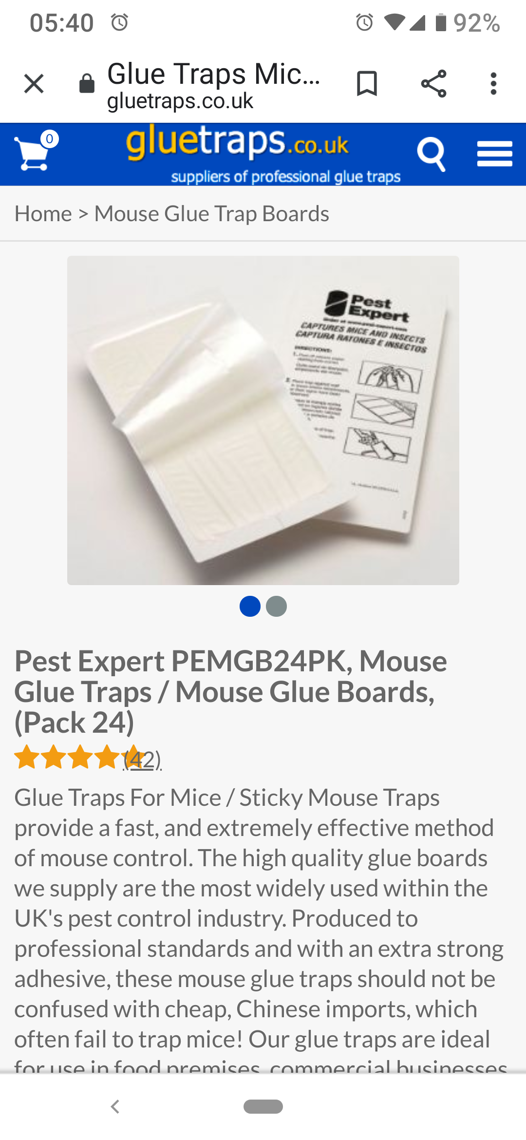

Rodent glue traps where putting down poison is a problem.Screenshot_20191221-054042.thumb.png.fd8bef16a4d4634802249222bbbc47fc.png
