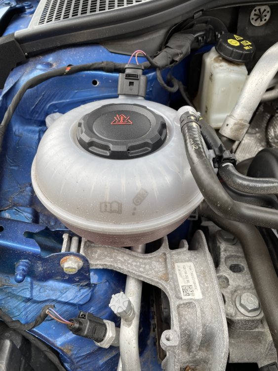

This is my expansion tank. No mention of "Mit Silikat" on it. 1.4TSI SEL
My tank on the vRS

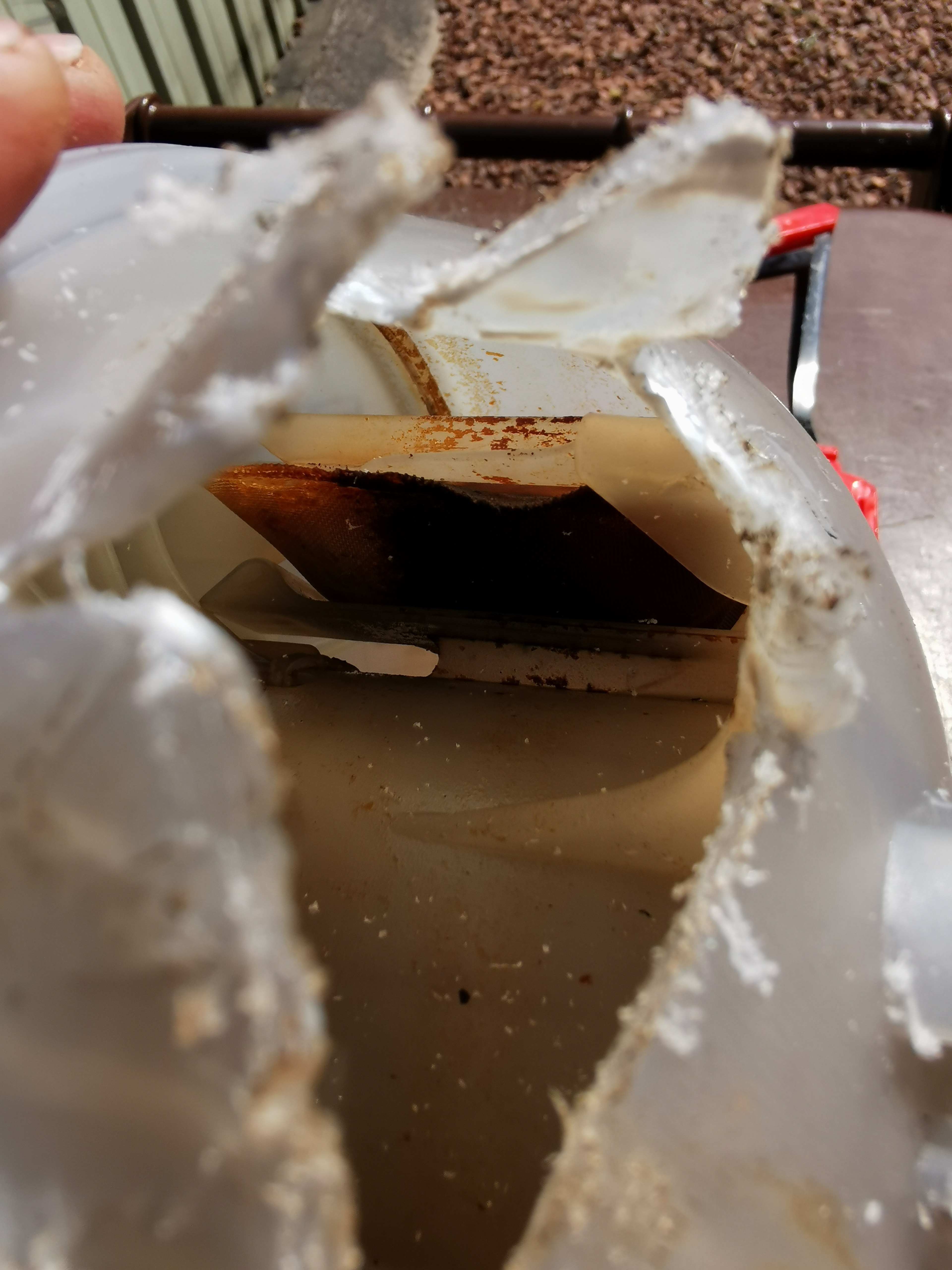

There was no way to take the bag out my old expansion bottle without taking the tank off and then cutting the bottle open, there was 2 chambers in it, the one when you open the cap and pour the coolant in and the outer chamber of the bottle where the bag was clipped in,  it was clipped on to the tanks wall. When looking into the tank with the cap off the coolant was clean but the outer chamber where the bag lived had alot of sandy grime in it. It's good you got the bag out your tank.
5 minutes ago, Pagan-Image said:
My tank on the vRS
Yours looks identical to mine bar the top left plastic bit and obviously the wording on the side.

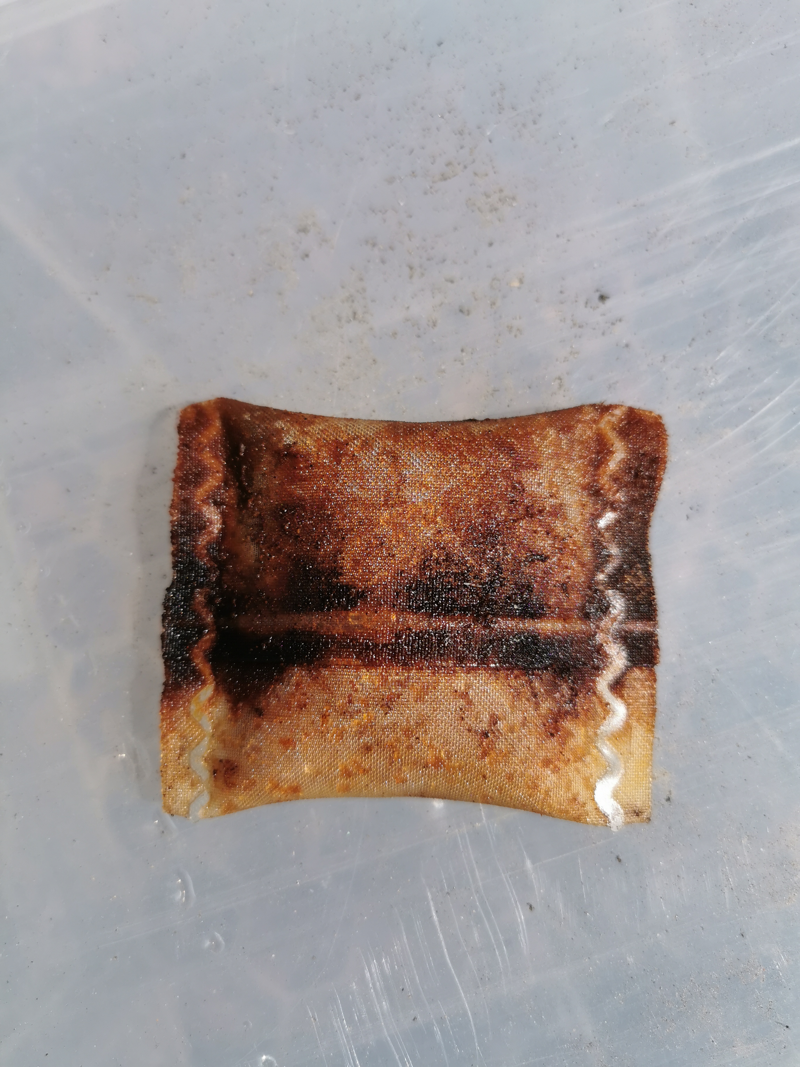

Let's try again. This is the silica bag in the bottle when I cut it open -
Here is the bag outside the bottle -
Im glad i had the other kind :o
It's blocked my heater matrix, a 2 and a half year old car! Never had any hassle with my old 13 plate MK3, after 220,000 miles i didnt even notice if that had the Mit Silicat expansion bottle as never had any bother with it😭
