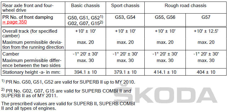

12 hours ago, Carlston said:
The 1.6 greenline is different from the non-greenline. Greenline front springs are usually shorter to drop the front end of the car to improve the aerodynamics at the expensive of a harder ride. Just use standard 1.6TDI hatchback springs.
The Greenline is lowered both front and rear by 15 mm compared to the standard suspension. Stationary height is the ride height as measured between the centre of the wheel and the lip of the wheelarch. Greenline uses the sport chassis.
Changing to standard suspension from Greenline would require new springs and dampers all round, an expensive proposition if not needed.

That all aligns well with the tables I posted from the service manual. The spring length is probably the uncompressed length so under the weight of the car it'll be less, plus the damper adds a few mm to the ride height too.
Thank you for all your comments, I've just gone and measured roughly against the table provided by chimera,
It looks like I was correct in thinking its sagged, the fronts should sit at ~375.8mm
Both front are ~367
The rears should sit at ~379.1

He should have chosen the Sport chassis.
Camber, castor, etc. all vary as the suspension moves through its travel but they will do so around a nominal specification which is the set of alignment settings specified. These will set optimum values for the car's usual ride height but also optimise tyre contact with the road away from the static setting. One of the important parameters there is what's known as roll camber: this is the variation in wheel camber as the suspension is compressed during roll and is optimised to keep the tyre's contact patch as close to horizontal as possible to maximise grip in cornering. The suspension designer will have considered this in setting out the static specification.
Using the basic chassis settings on a car that's riding 15 mm lower will definitely have an impact on the car's behaviour on the road, and probably on tyre wear too. I'd be going back to the garage and getting them to do the job properly.
