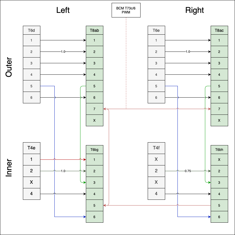

You need to join the signal wires from all four of the rear light modules (according to the diagrams here) into a single one and lead that one to BCM.

@Istarish thank you! So basically i need to bring only single wire to boot area from BCM and split it there.
I personally did the splitting beneath the C pillar interior trims.
Only one cable goes from the BCM to the rear and is then slid to all four lights
Thanks guys 👍 I routed the cable yesterday

Finally, I've finished today.
Now I can add all details
Wires schema. All wires 0.5mm except mentioned, for RH rear fog light will be on right inner side T4e/1 - T6bh/1(double check it).
Preset, all adaptations for FL BCM, but you can use it for preFL BCM.

Which BCM did you install?
Since the animation works when you lock it too.
The cable diagram is known.
5Q0937084EC
Okay, so only with an exchange. I have BCM lying here. Thanks
1 hour ago, zacko_O said:
5Q0937084EC
Did you swap to this BCM or was it factory fit in your car?
Swapped
Here I described how https://www.drive2.ru/l/681792318050668410/
Even I developed app to sync most of the adaptations
Edited by zacko_O
Vor 34 Minuten sagte ApertureS:
Haben Sie auf dieses BCM umgestellt oder war es bereits ab Werk in Ihr Auto eingebaut?
EC has only been around since the facelift. Cannot be found in a 2015 model. My 2017 or a 2018 doesn't have that in it either.
Therefore it needs to be rebuilt.
