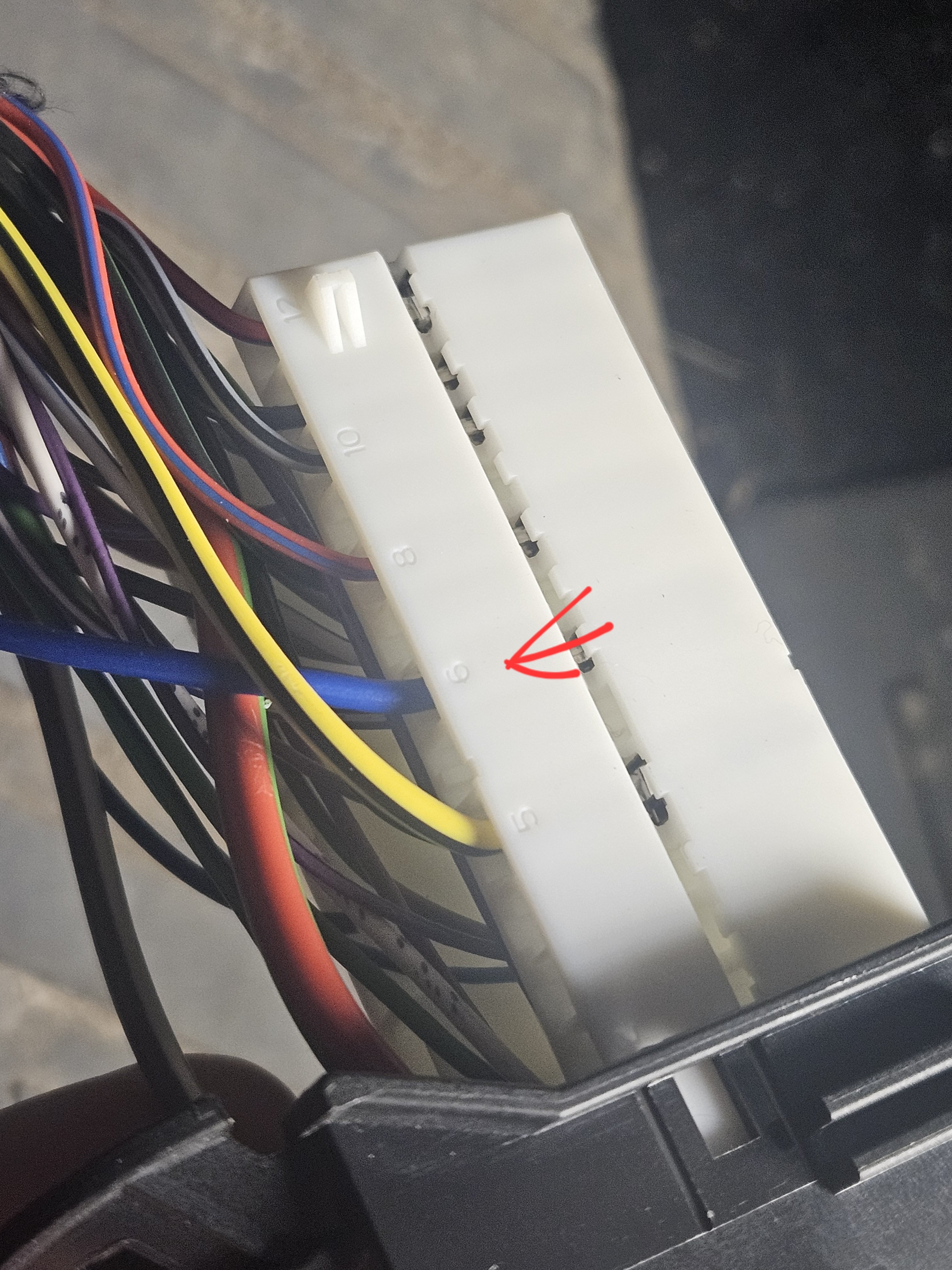

Hello again, kind fellow Superb fans. Does anyone by chance know what terminal is needed for that BCM pin 6 connection?
What do you mean by connection?
On the BCM it is connector C pin6
Edited by Lutz_91
I meant the type of the pin. From the way the socket looks I assume it's female. Could that be 000979133?
It is either a micro quadlock female or MCP 1.5mm or MCP 2.8mm i cant remember exactly which of the top of my head!
Thanks!
Vor 36 Minuten sagte Istarish:
dass es sich um eine Frau handelt
Yes is female
Vor 37 Minuten sagte Istarish:
Könnte das 000979133 sein?
No, I mean it's a 000979025E
What are you planning to do now? Because your BCM is not suitable for 100% functionality. It will probably only work when you open it.
I'm totally good with partial functionality for the time being. Once we know how that BCM retrofit mentioned above goes, I'll have the cable ready if I decide to also go with it.
My new BCM is here. Just have to find time to convert it and have the coding done - unfortunately it's only possible online.
I've had my pACC coded remotely and aside from having to maintain the battery level the whole experience wasn't half bad.
I know I also have someone who does it remotely. But with BCM you also have to expand the old one and so on. It takes a while before you get it figured out.
And the coding takes time too. But yes, I already know that. You also have to find the time.
Yep, the time part is the most difficult one to arrange. I only managed to find some to figure out and order the terminals for the taillights adapters today. Good luck with the BCM - hopefully some nice new options aside from the closing animation will become available. 😉

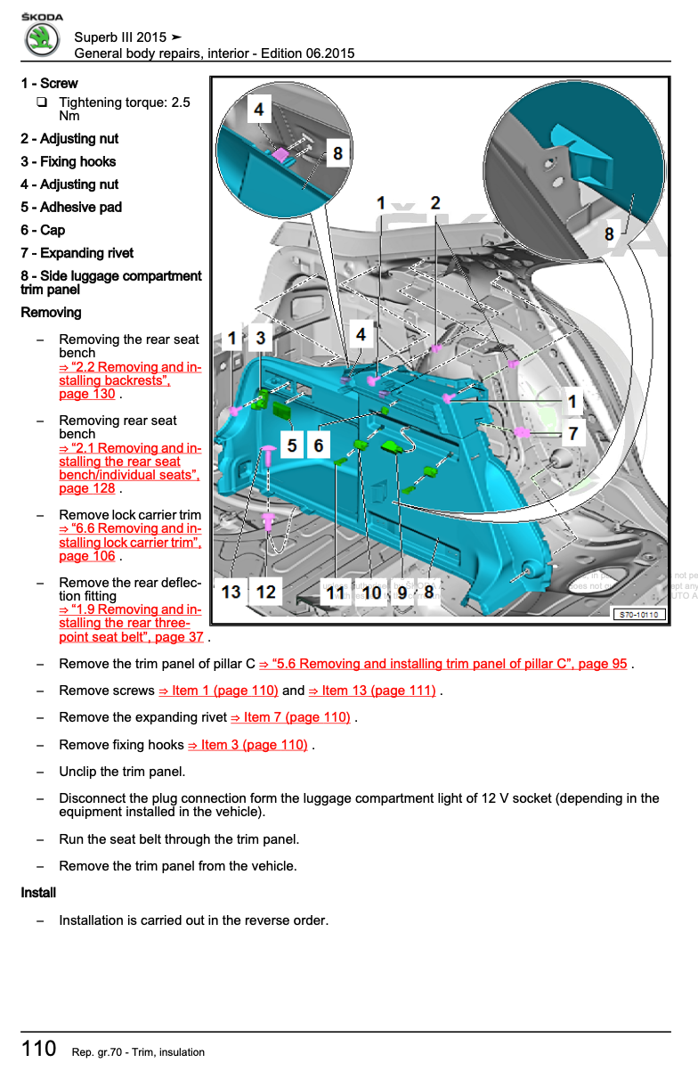

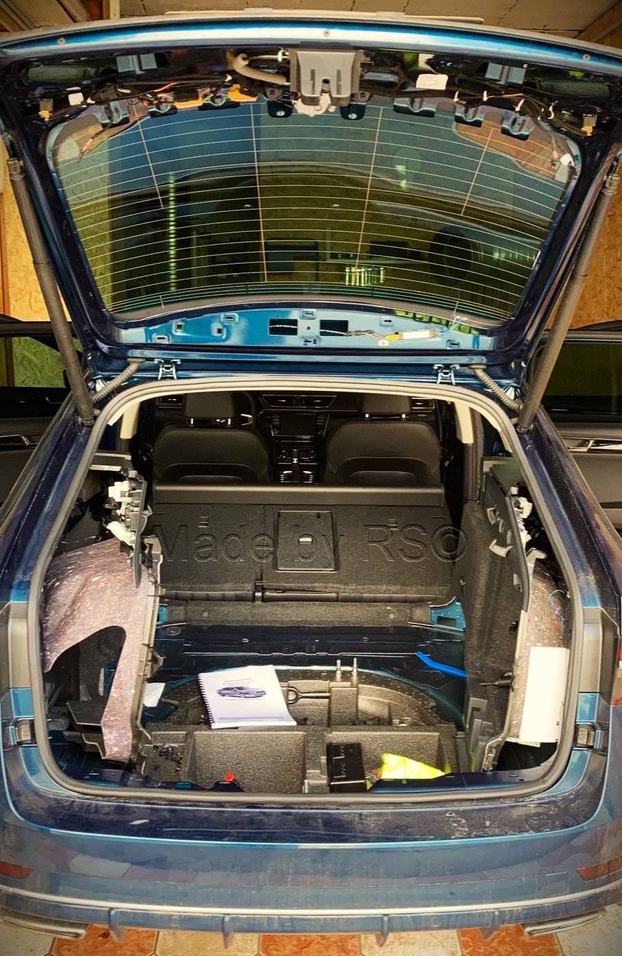

Speaking about the main topic, I finally assembled my adapters and I plan to attempt the wiring soon, hopefully this week. Does anyone have any suggestions or tips?
At the moment my plan is to follow the attached page from the service manual in order to disassemble the side trims of the boot. I have a bit of experience with wiring the lid and getting from there to the MIB area after retrofitting the rvc, but getting from tail lights to those bloody rubber culverts by the hinges remains a bit of a mystery to me at the moment.
Loosen both sides and then thread the cable from the light using a wire or pull-through aid to the rubber grommet. It's a bit of fiddling but it works.
And then pull the cables from the rubber grommet in the tailgate to the inner lights. The path actually comes about itself. There is also enough space in the tailgate.

I've installed the lights and wiring and I'm REALLY happy with the way my car looks, even without the trim bars. HOWEVER after connecting everything to the 6th pin of the rightmost connector of the BCM (it's a CG one, my car was assembled during the first weeks of 2019) nothing changed - the main lights just turn on and blinkers do two quick slides on car's opening. I decided to put all the hardware and trims together before changing the coding and it's still in progress - does that make any difference?
9 hours ago, Istarish said:
It seems that my case is neverending... 😅
The car won’t know what to do with the added wiring until it’s coded correctly so that’s correct that nothing will change until the coding is fully complete.
