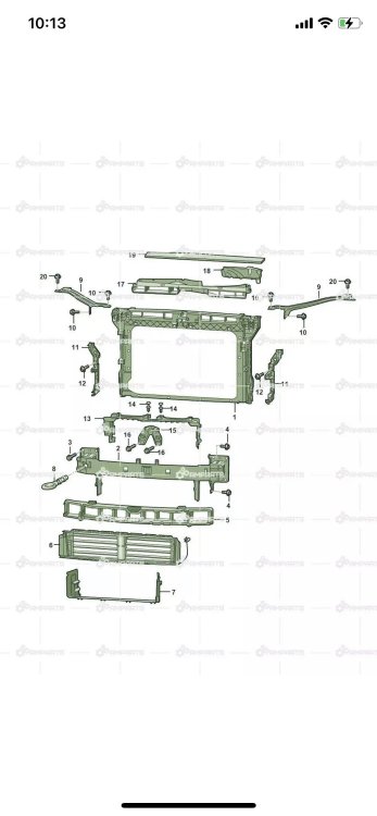

Everything works perfectly. You need a few extra plastics like the wheel arches and another couple of plastics. (Number 11 both sides) from the picture posted.
