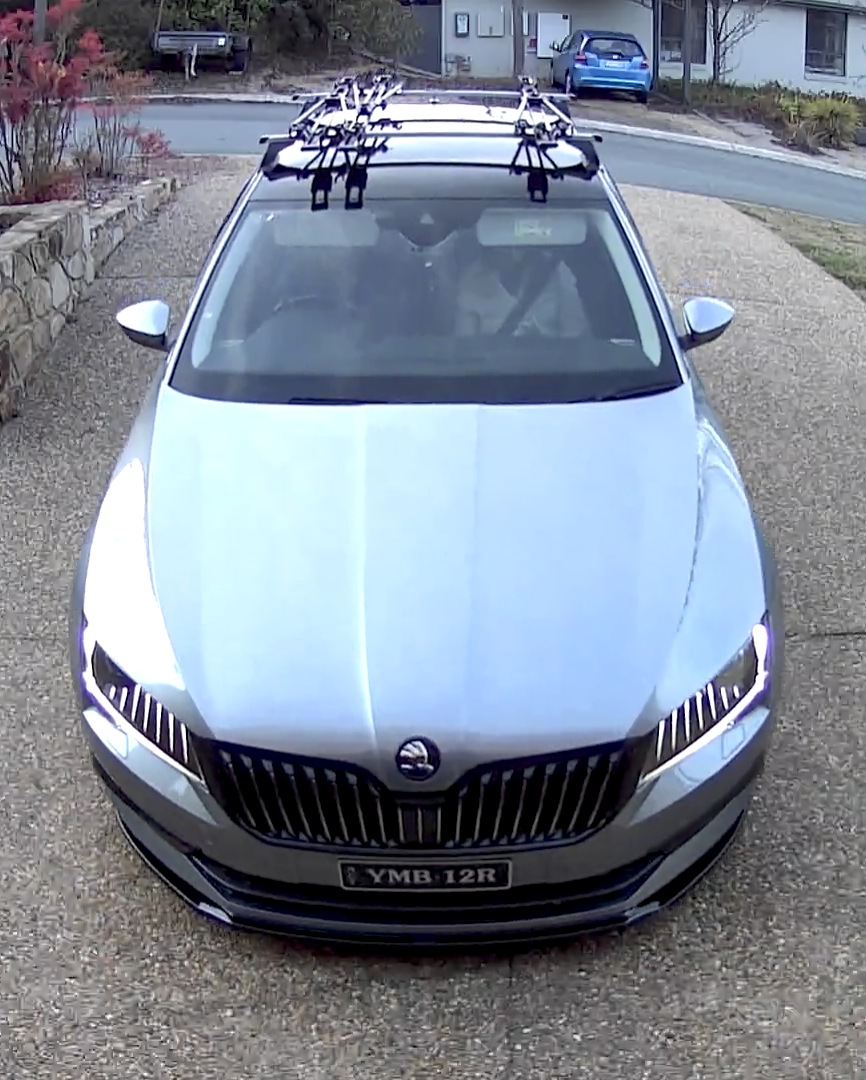

On 8/22/2022 at 11:56 AM, JR RS said:
my understand from wat i've read in the past is that most people were not able to get the on/off animation coded successfully.
the dynamic indicator does not seem to b an issue.  it just happens.
however the fading in/out animation when the car is turned on/off is was stumps most people who've done the retrofit.
as show here.....

@Waylon- sorry but I haven't done the facelift taillight retrofit.
I'm sporting the fake wannabe version with mine.

I'm also trying to implement the functions in the video, trying the corresponding functions associated with the light channel, such as eyelash lights as daytime running lights, tail lights home mode dynamic gradient, etc.

On 16/07/2023 at 18:43, Waylon said:
....such as eyelash lights as daytime running lights......
Don't know about the facelift, but with the pre-facelift u need Version B of the Bi-Xenon headlights to get the eyelashes to work, otherwise don't bother with any coding or apps.
