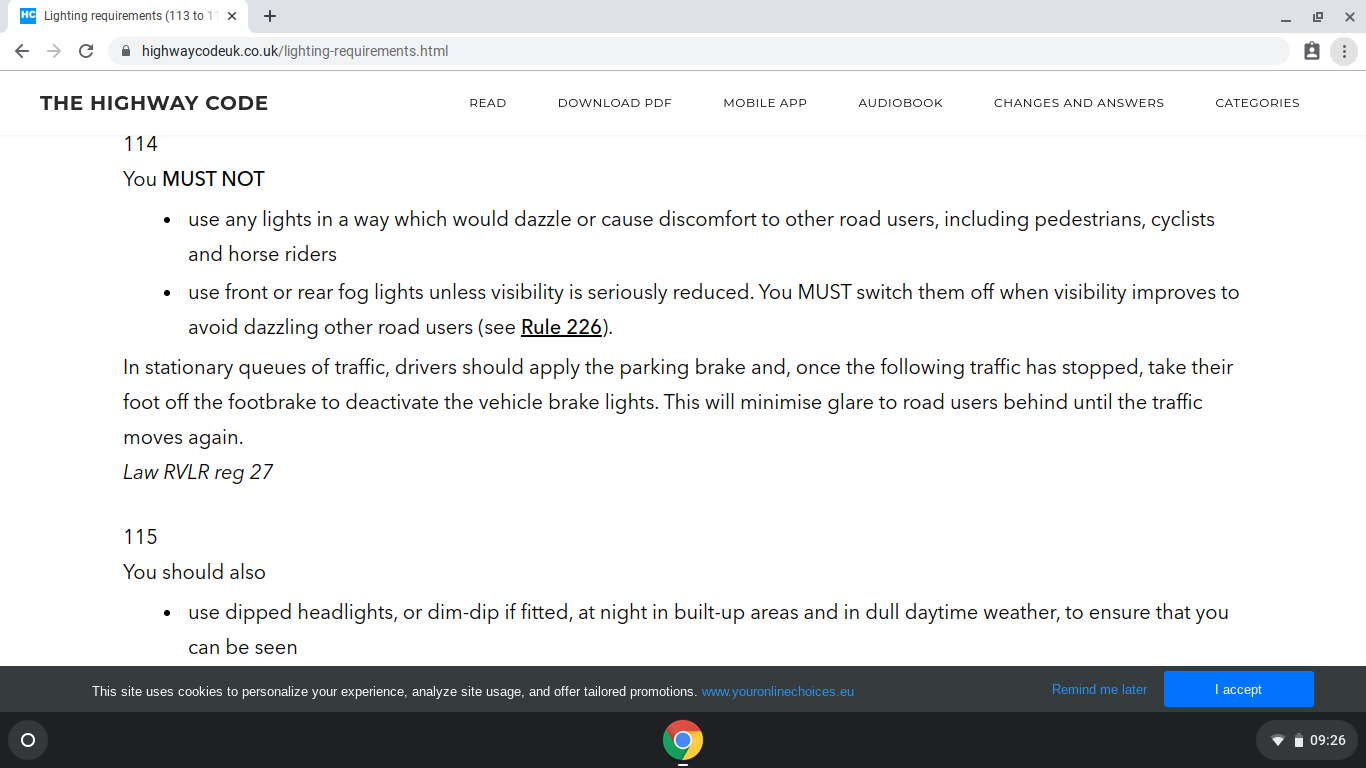

So best to get them coded out if in the UK and forget the EU manufacturers that ignore the UK Highway code and the bit about prolonged stops and the Parking Brake.

But then maybe Trained Police Officers should think on the UK highway code and not sit with rear brake lights on when sitting for prolonged periods in traffic like all those round them.  The last one that got out to ask what the problem was fully understood.  The thing was, it was the sidekick from the passengers seat and his driver / partner in crime fighting still had the foot on the brake pedal of the XC90.
