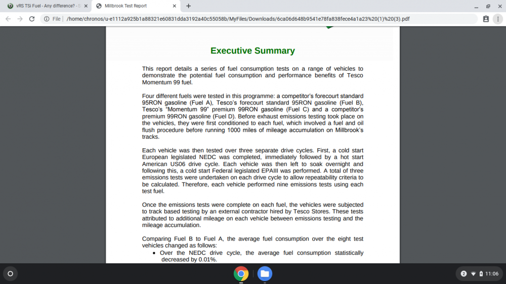

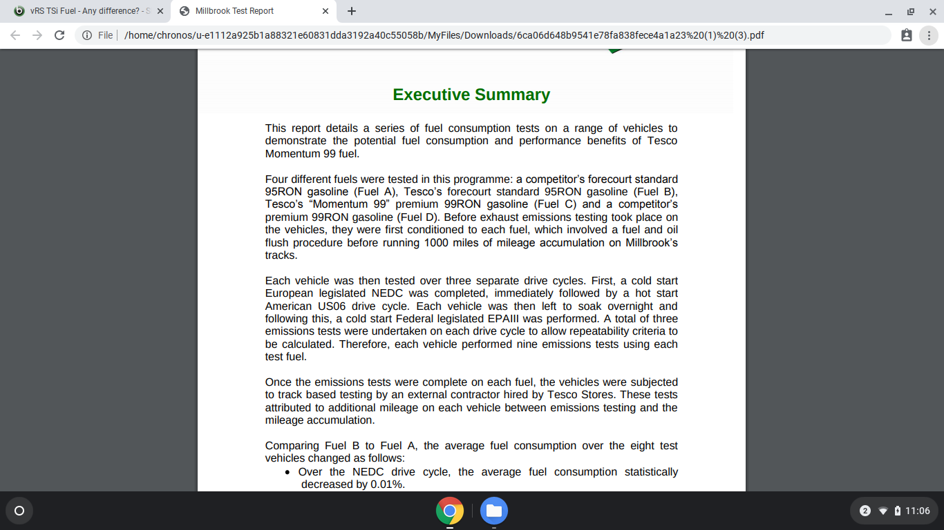

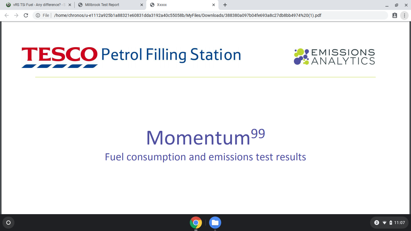

Tesco at least had their 95 and 99 ron fuel tested alongside others for emissions and published the results.
Various vehicles used in the testing.
 Greenergy produce and supply fuels for others like Esso in the UK.
Tesco no longer have these  reports readily available. so i saved them.
Never seen the other fuel producers or manufacturers show their test results though.
388380a097b04fe693a8c27db8bb4974 (1).pdf 6ca06d648b9541e78fa838fece4a1a23 (1) (3).pdf
